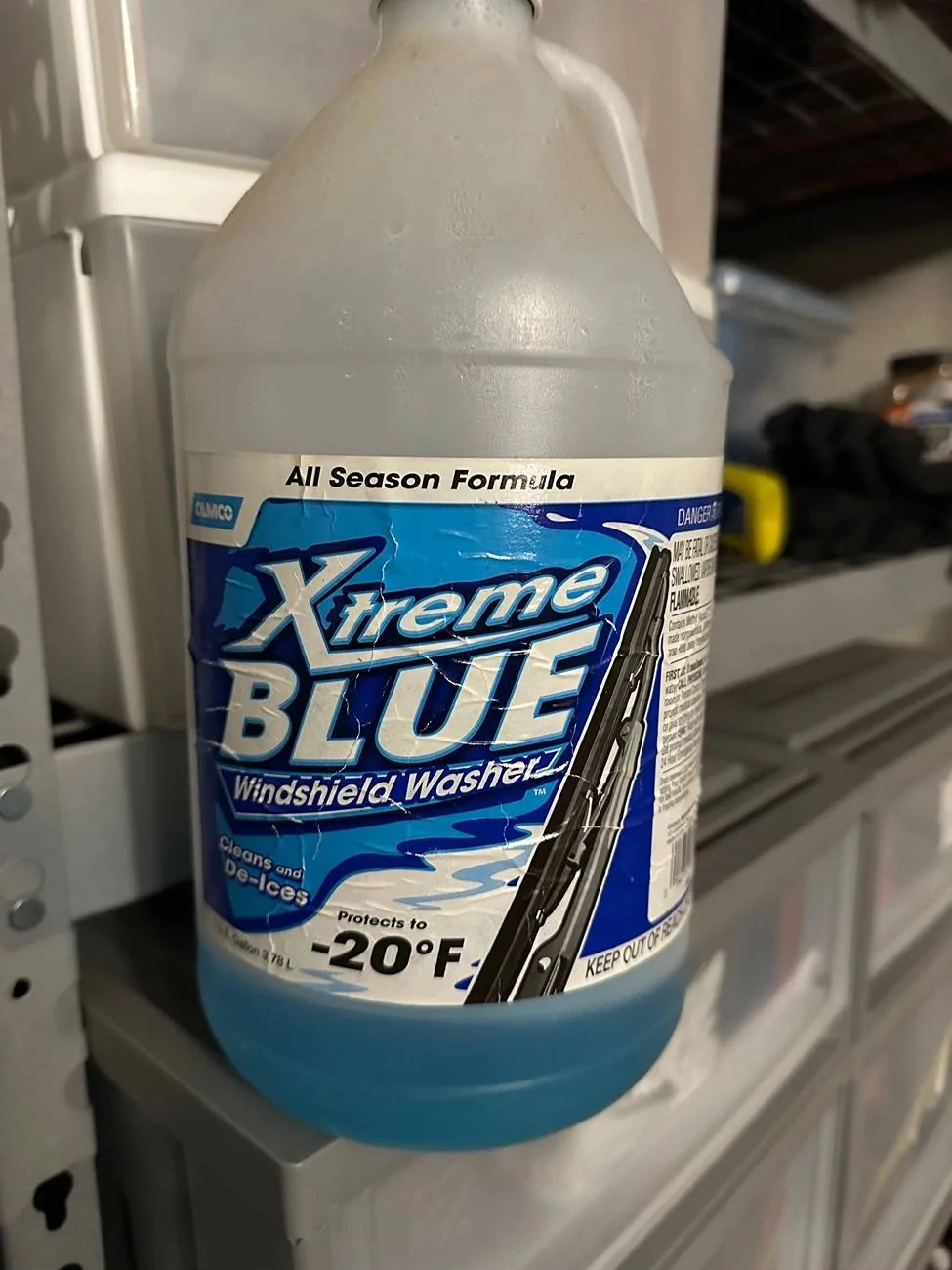

I siphoned out the factory fluid and transitioned this Xtreme blue and it works much better. No more white residue and cleans better too.
