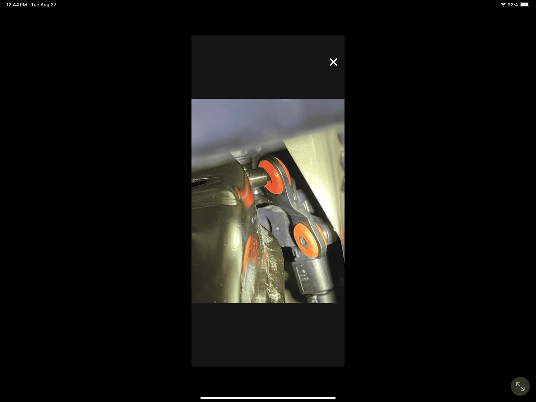

Up above, I was one of the guys saying how much I loved the Lift Rod KIt. Well, I’m amending my post and I wonder if anyone else has an issue.
Yesterday my back end collapsed like there was an air tank issue. Took it to Tesla and the tech said the aftermarket piece I’d installed didn’t “sit” properly and became dislodged. He put it back on, took it for a test drive, and it popped right off again.
So it appears at least on mine that as the piece wears - because it doesn’t have “pop on cap” like the original Tesla piece - it will eventually wear enough and come loose.
Curious if anyone else has a similar issue? I wonder for those of you that have installed them if you want to crawl under your back tire and take a look if yours looks like mine and is close to popping out?
I’m not mechanically smart enough to know if this is a design issue or just something unique to my CT but I’m sharing here in case it helps others. It would be most interesting if another owner who installed the pars would look and see if there lift rod is about to slip off just like mine. Thanks!
Please take a look at this "Pro Tip Video" to properly install your lift rods

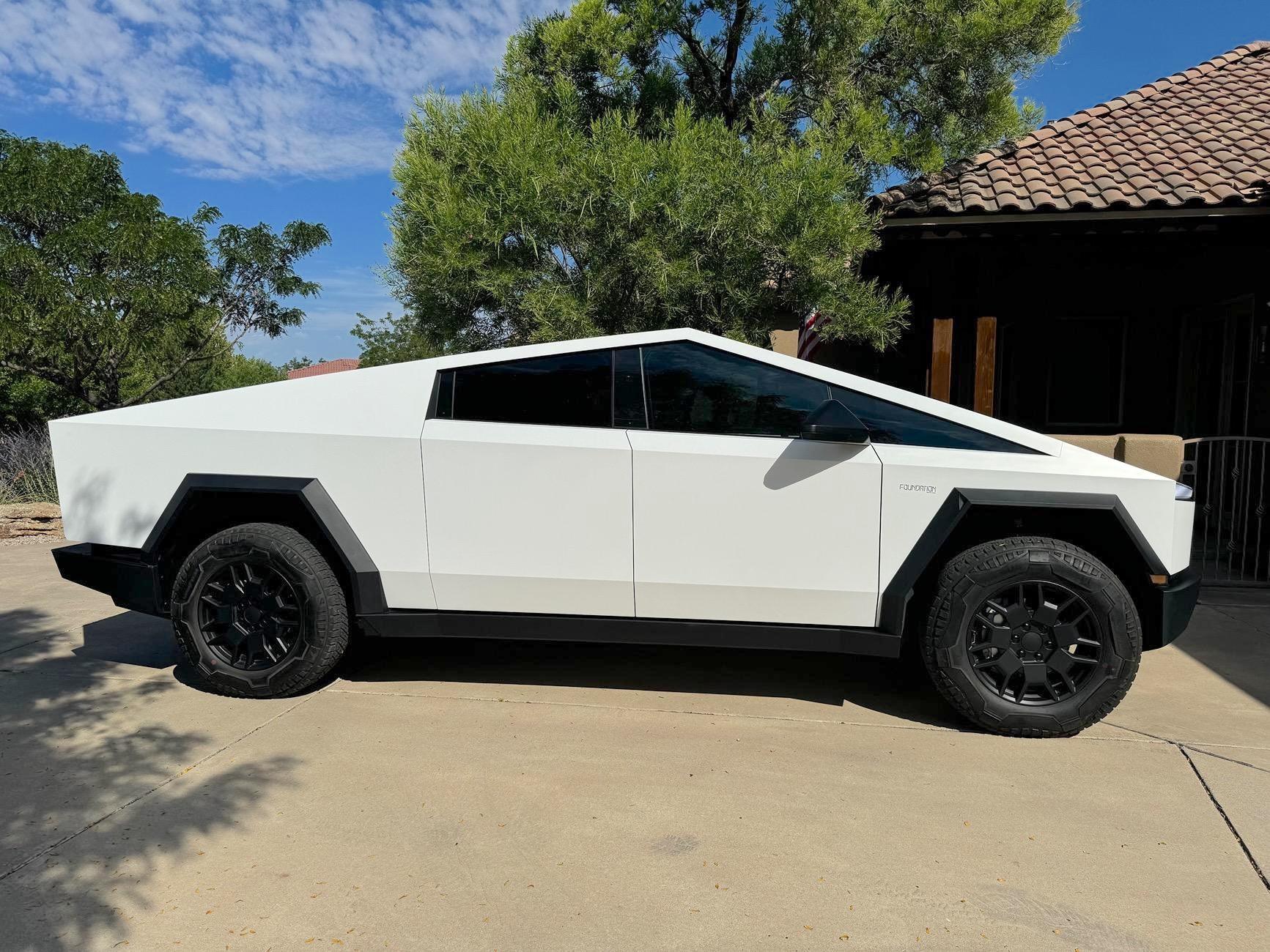

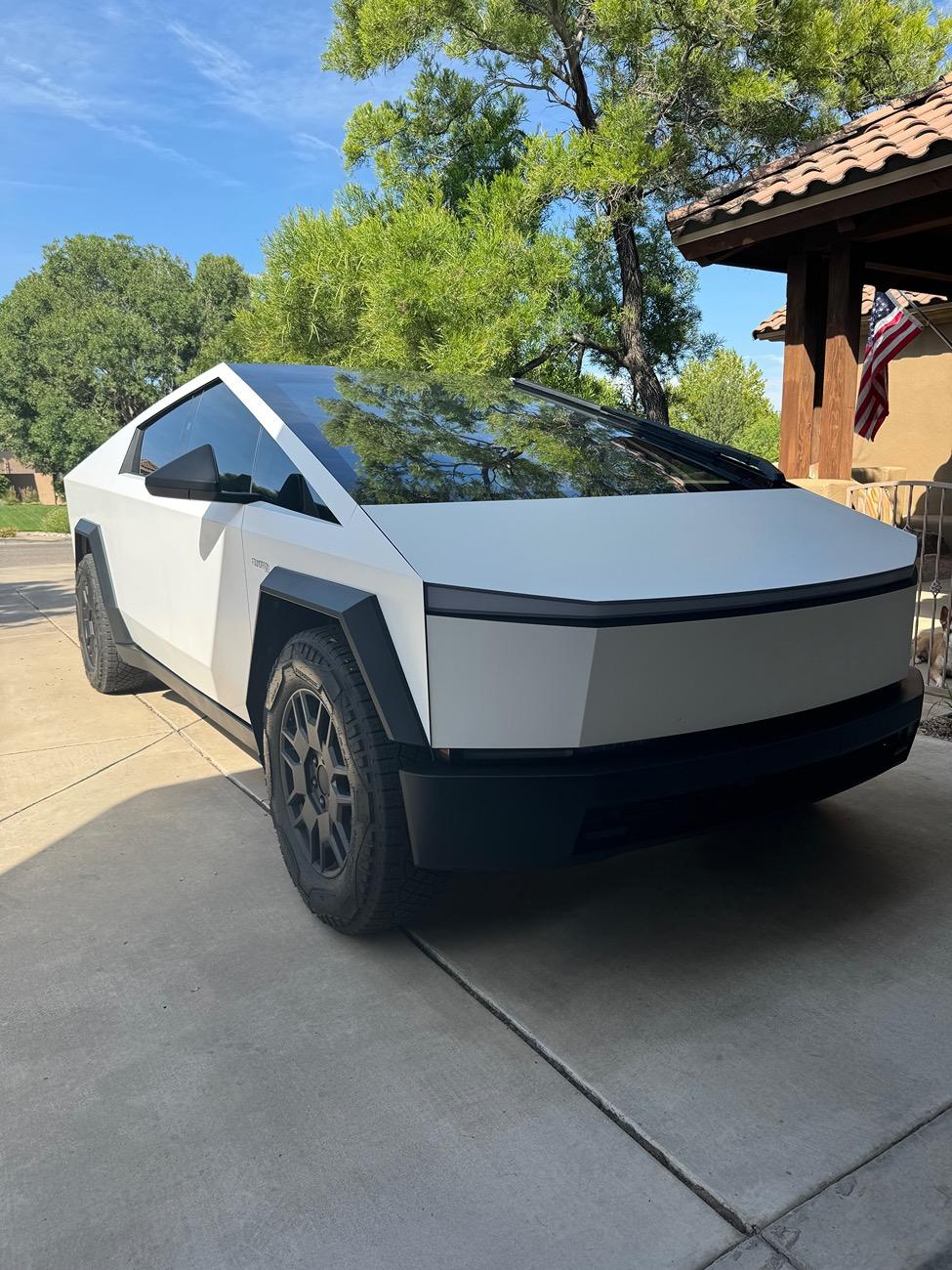

I’ve been using this lift kit system from @CYBERTRUCKco for a month. I did have one rear wheel come loose, but I had installed it incorrectly. After following the pro tip video here, I was able to get the rear in perfect alignment.
I don’t think you can lift another vehicle by 2” on planet earth for under a $100. Insane! I jumped on these the moment they came available.
We just went off roading this week, Baja Mode with speeds over 70 mph, truck still handles amazing. My friend who has extensive experience off roading was blown away. He could not believe the type of performance the CT is capable of. I’ve got plenty myself with my Raptor, but really pushed the CT in the arroyo’s and deep wash, WOW!
In town driving in Med just feels more properly associated with other trucks on the road now. Stock CT bumper height in CT low and med looked like my wife’s Model X height side by side, that’s just not right for a truck IMO!
I’d definitely recommend these to anyone thinking about lifting theirs. For $80, I’m not sure you can go wrong.

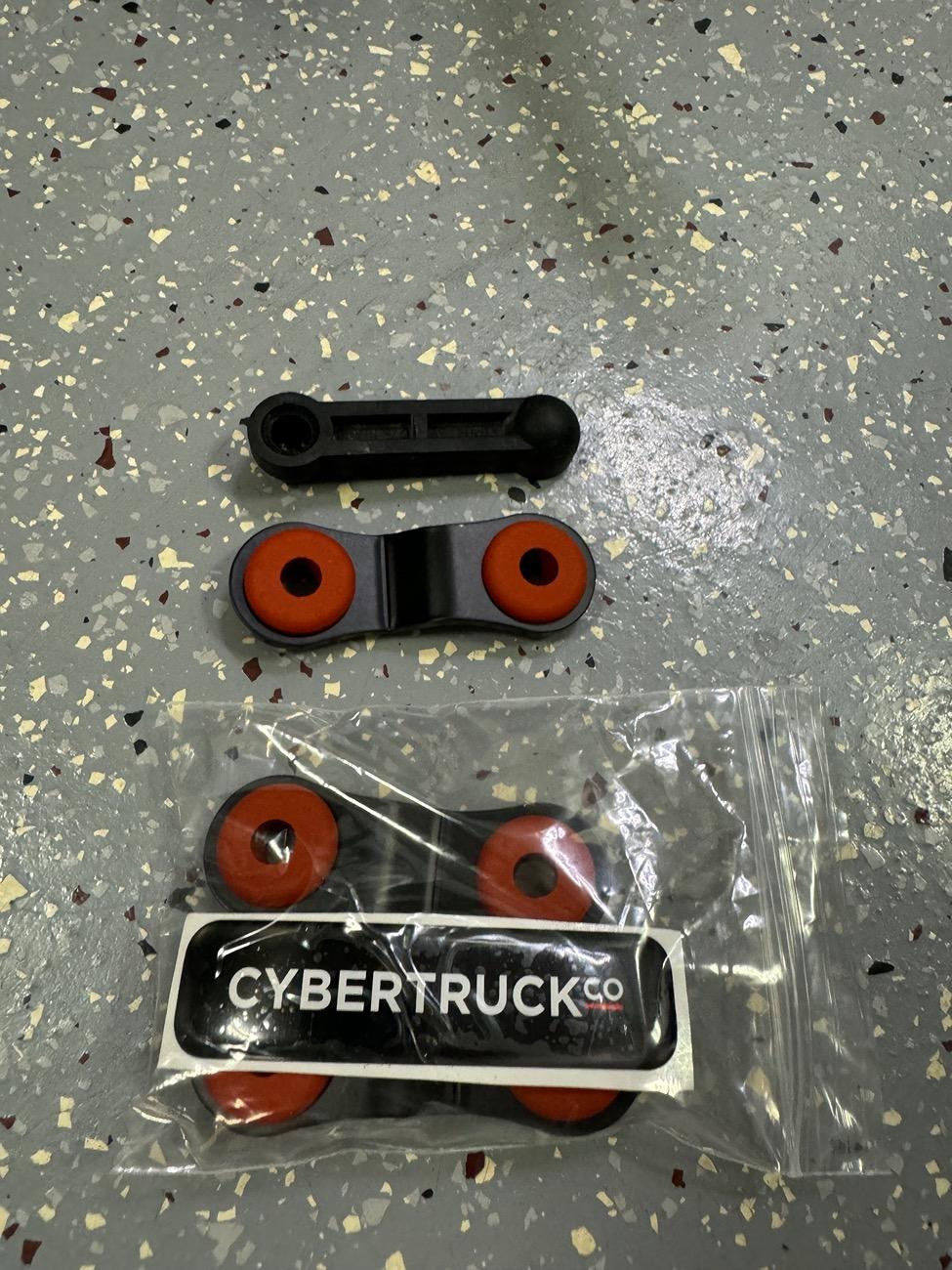

Just got the @CYBERTRUCKco (@Roger@CYBERTRUCKco) lift rod kit in yesterday and installed them. Took me about 20 minutes. Glad to have a little higher stance in entry and low. It’s only an inch, but to me makes a nice difference. Definitely looks super high w 2” extra in high mode. Love it!

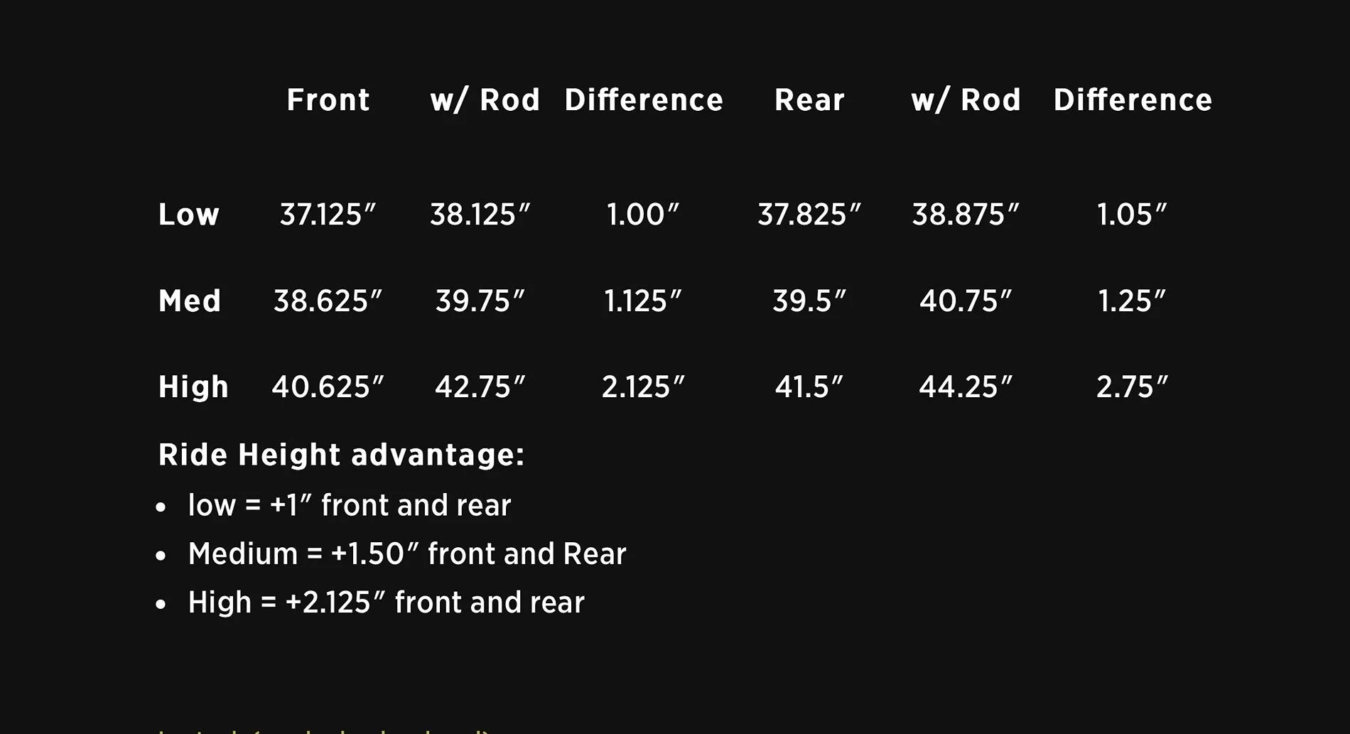

Not sure, but in sport mode the rods only lift the truck 5/8" taller than stock, so not much difference. Hope that helps!
