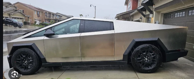

Heh, i just got it this afternoon and I've been fighting it, no matter what i do ... it just comeback .. and i literally drove 12 miles to Costco and home.

fingerprints come off, but then a new bit of streak appears from doing that. lol maybe i just need to put some elbow grease into it, unlike with my model y, i would just use ONR and then spray it with dream maker and it would shine

Well I totally forgot that the more isn’t the be all end all . What I mean is I forgot the spray cleaner. So I just went out and used some spray away and it was night and day difference now
