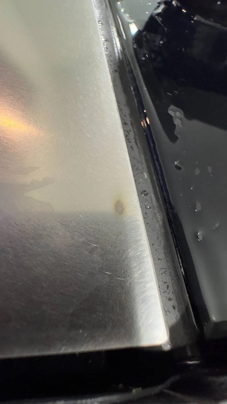

Any tips to remove this small discoloration?

I used some Iron Remover today to get rid of rail deposits from delivery and it removed most of it. Should I try bar keeper's friend (soft) or something else?

That’s a laser burn. Can be removed with DA sander and 320 grit
