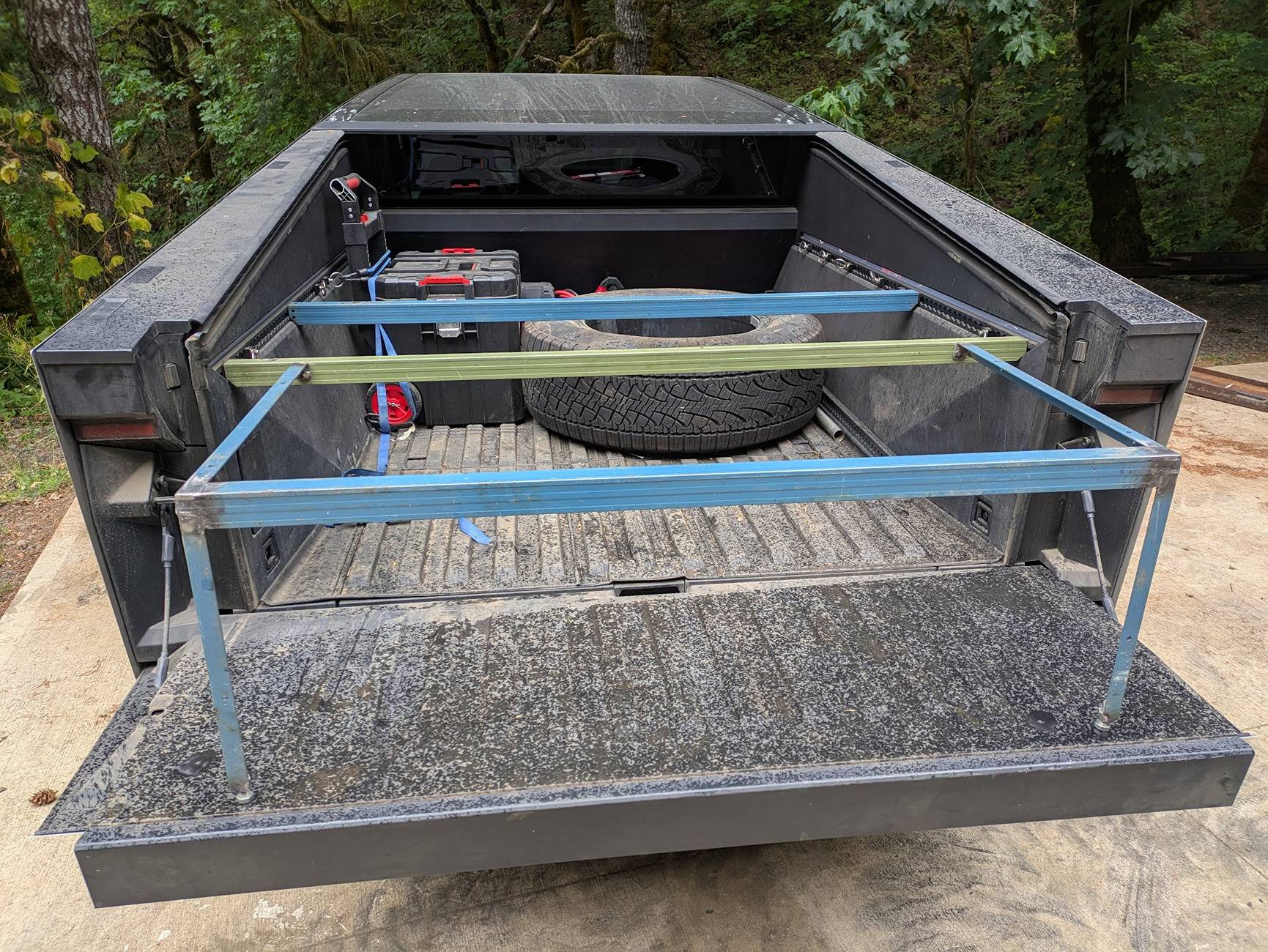

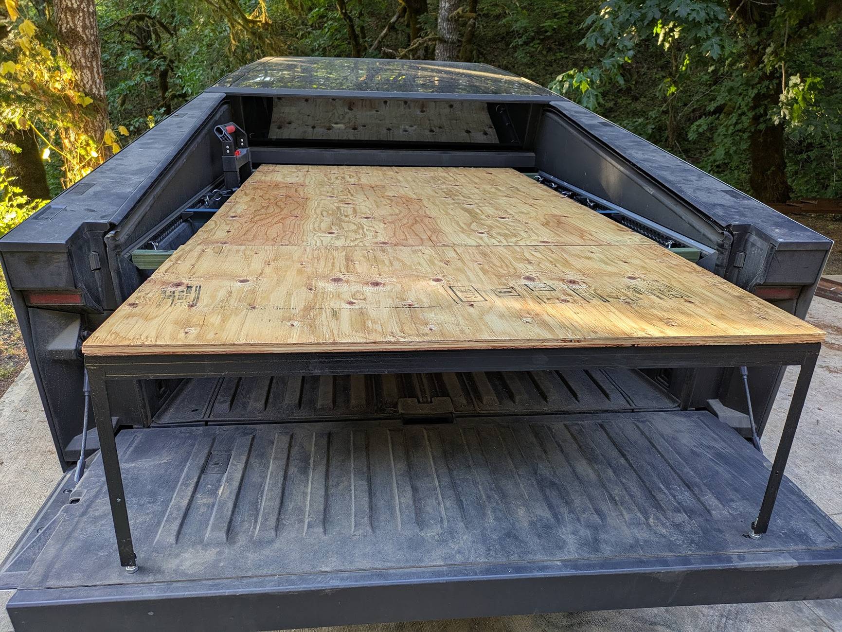

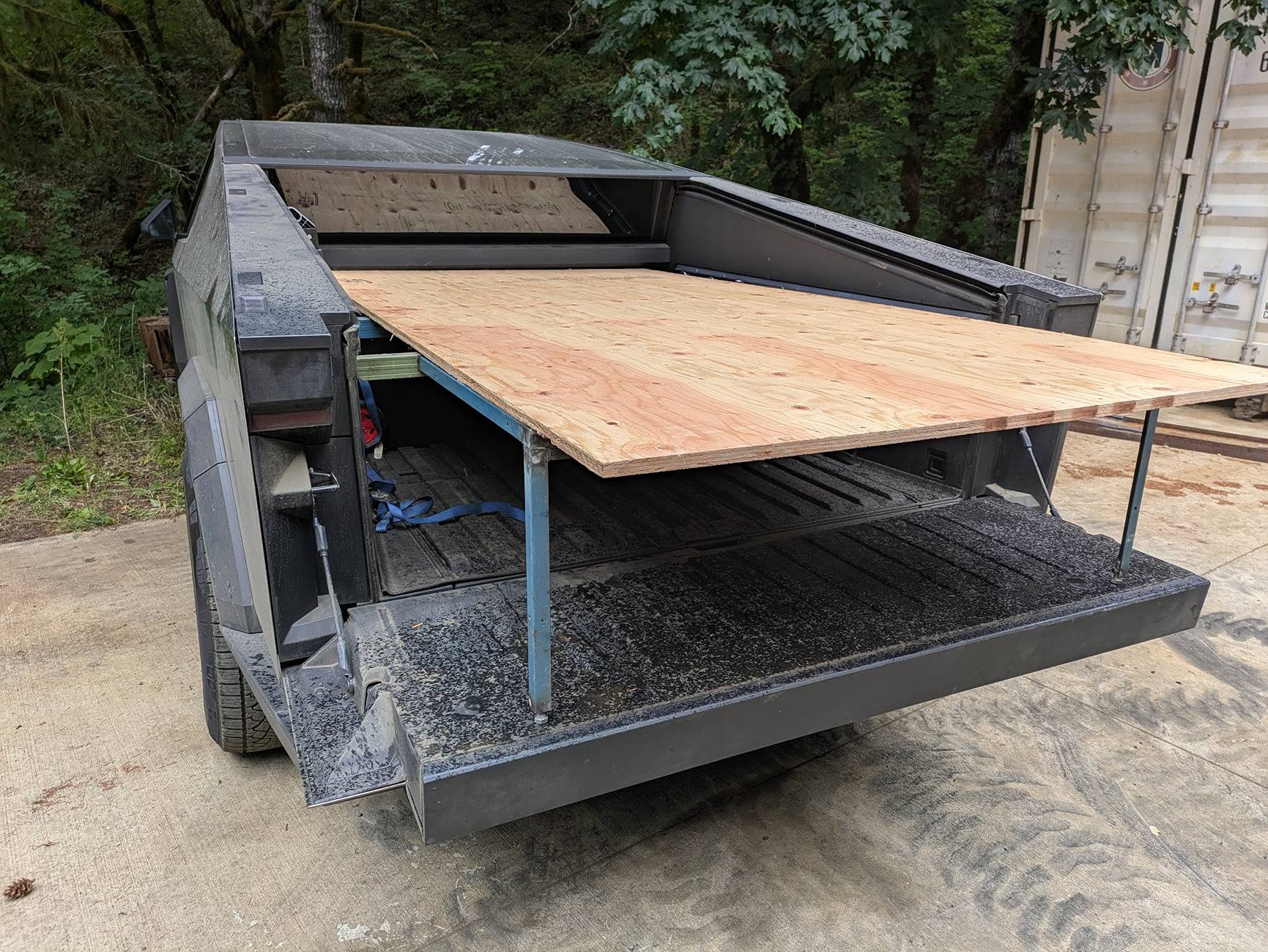

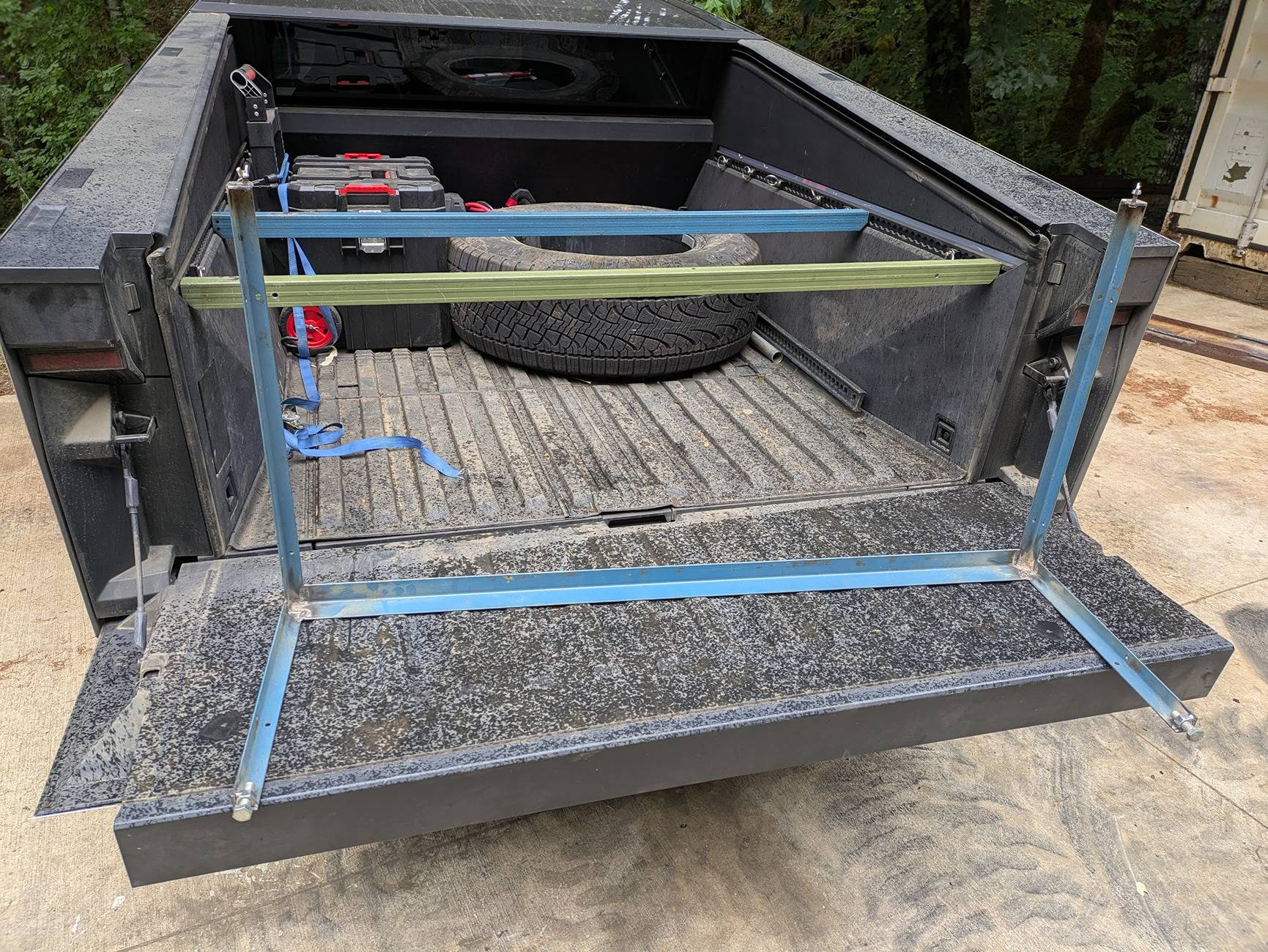

Old metal bed frames can be found for a few dollars in various places selling donated goods. Add L track D-rings from Amazon (link below) and a sheet of plywood (will need to cut it a bit). The extension part is welded, but in the absence of a welder it can probably be built with rivets and/or screws.
Tesla Cybertruck DIY tent platform PXL_20250720_222242153
Tesla Cybertruck DIY tent platform PXL_20250720_222405482
Tesla Cybertruck DIY tent platform PXL_20250720_222518060
Total cost of materials about $75.

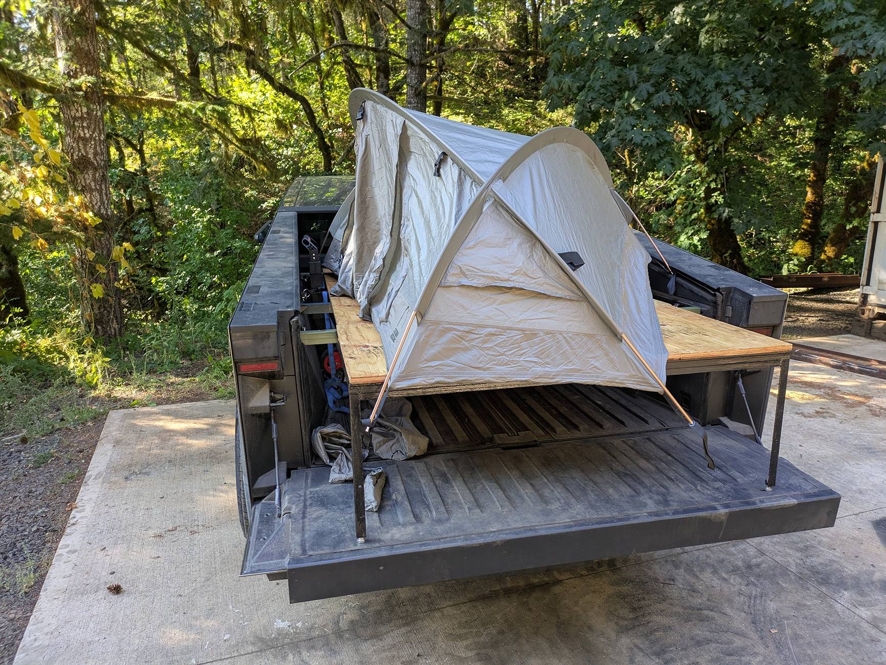

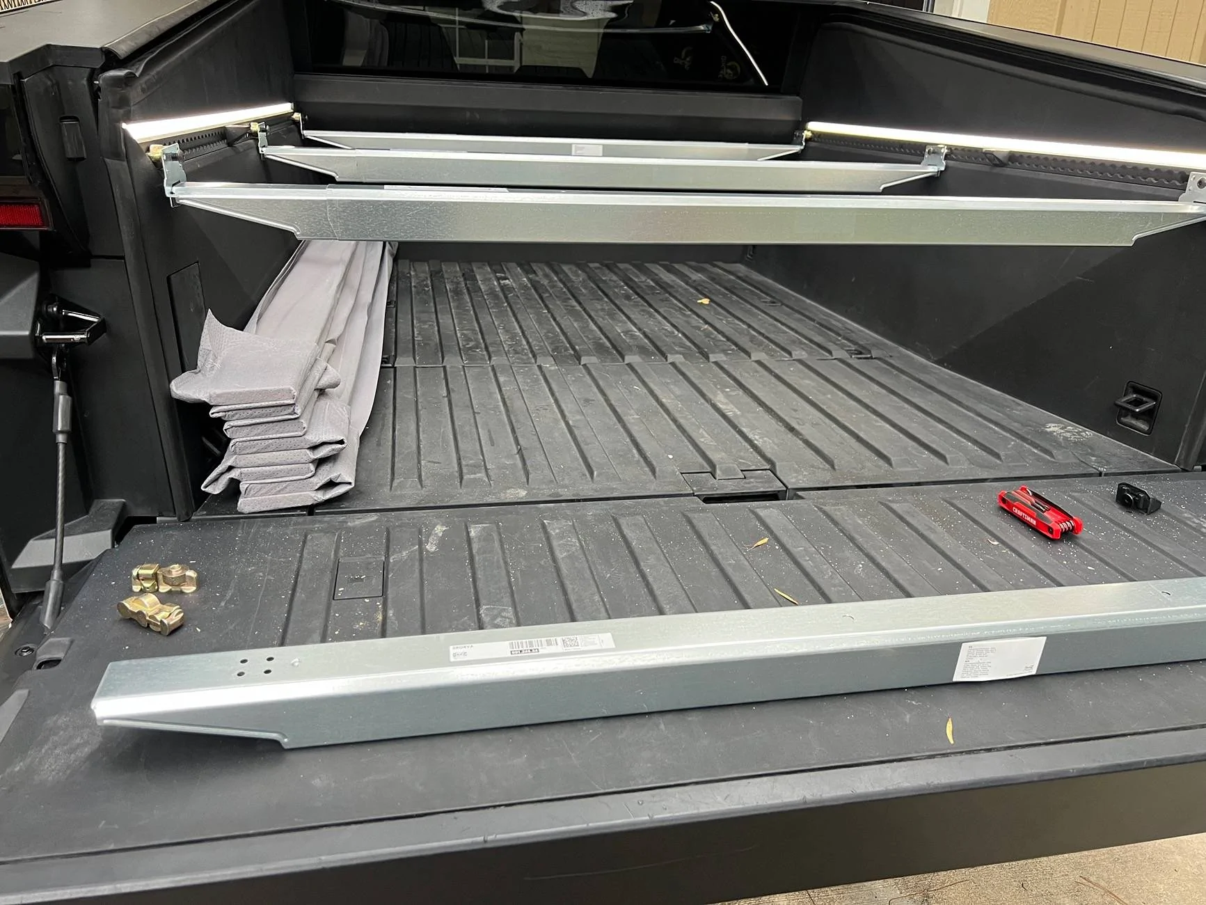

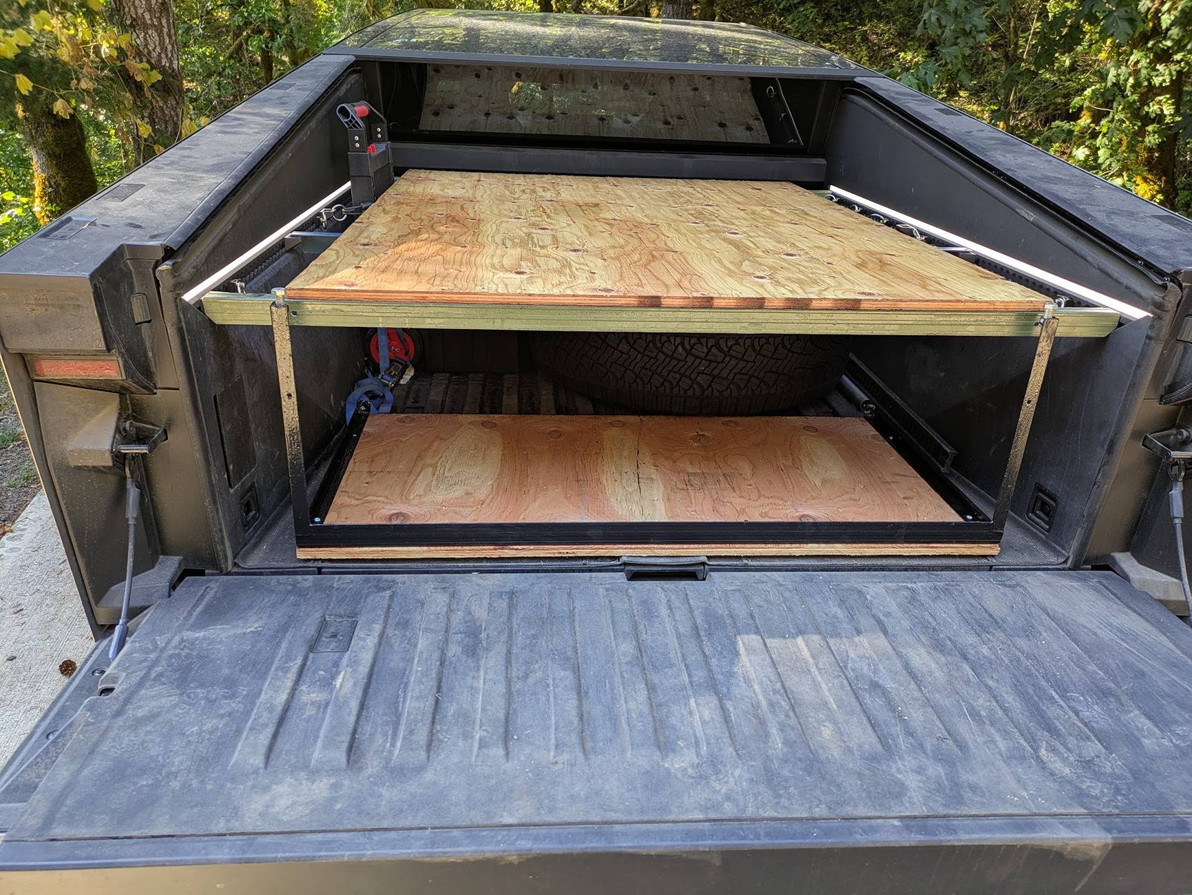

Couple more pictures of the progress on the build...
Tesla Cybertruck DIY tent platform PXL_20250723_004853947.MP
Tesla Cybertruck DIY tent platform PXL_20250723_023138095
I must admit though, it's a bit too small for my tent :D Always test the equipment ahead of time!

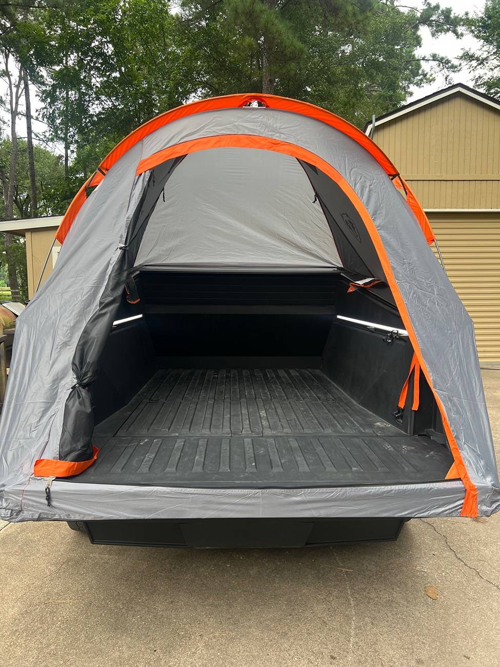

Meanwhile I ordered one of these, which seems smaller and has a better entrance configuration

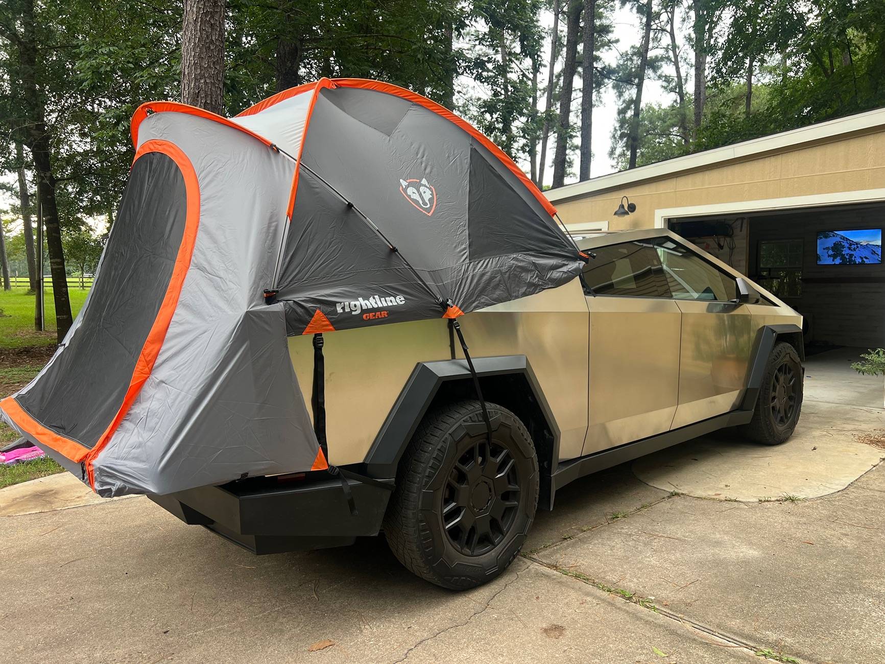

Full size standard. Took a few trial and errors but this seems to work. Will need longer straps.
