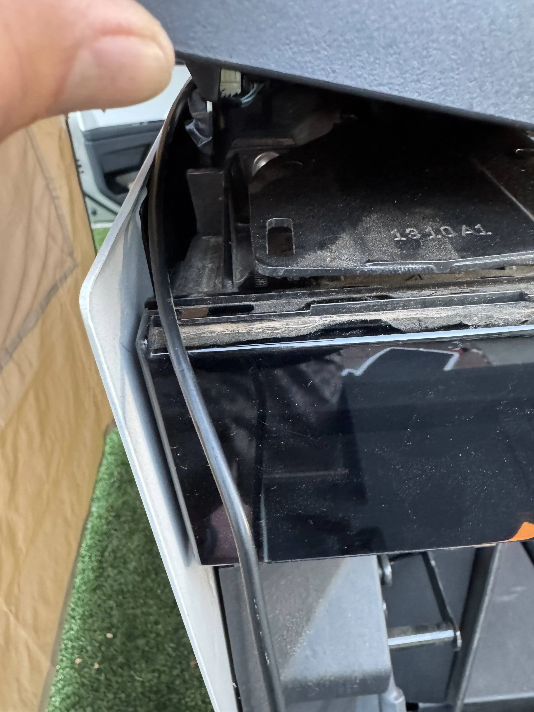

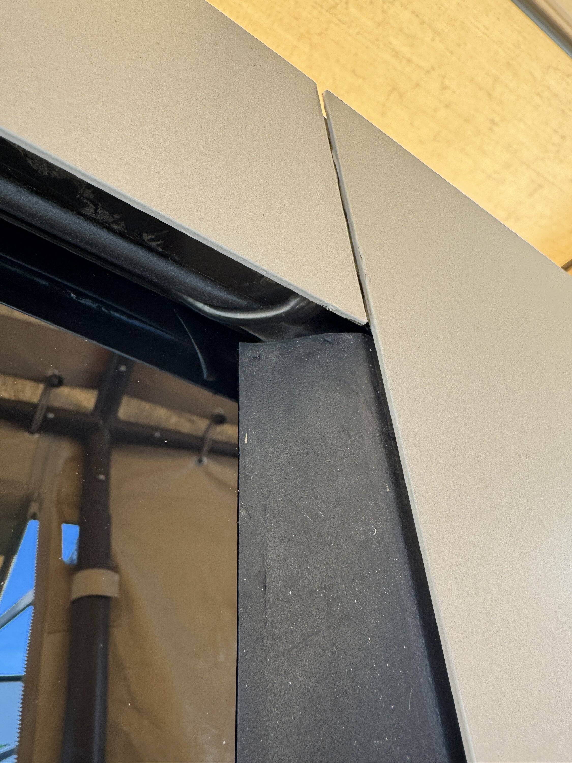

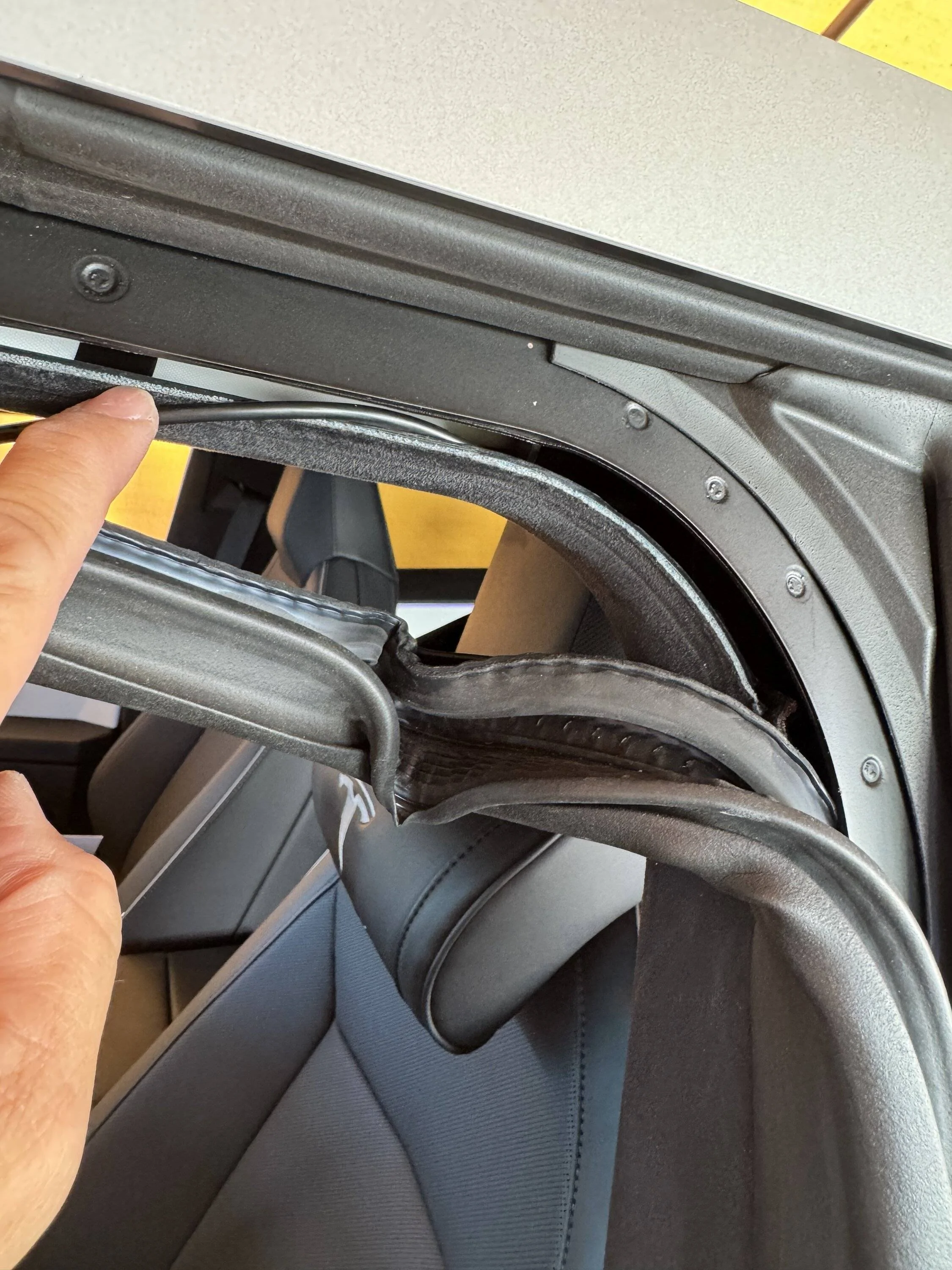

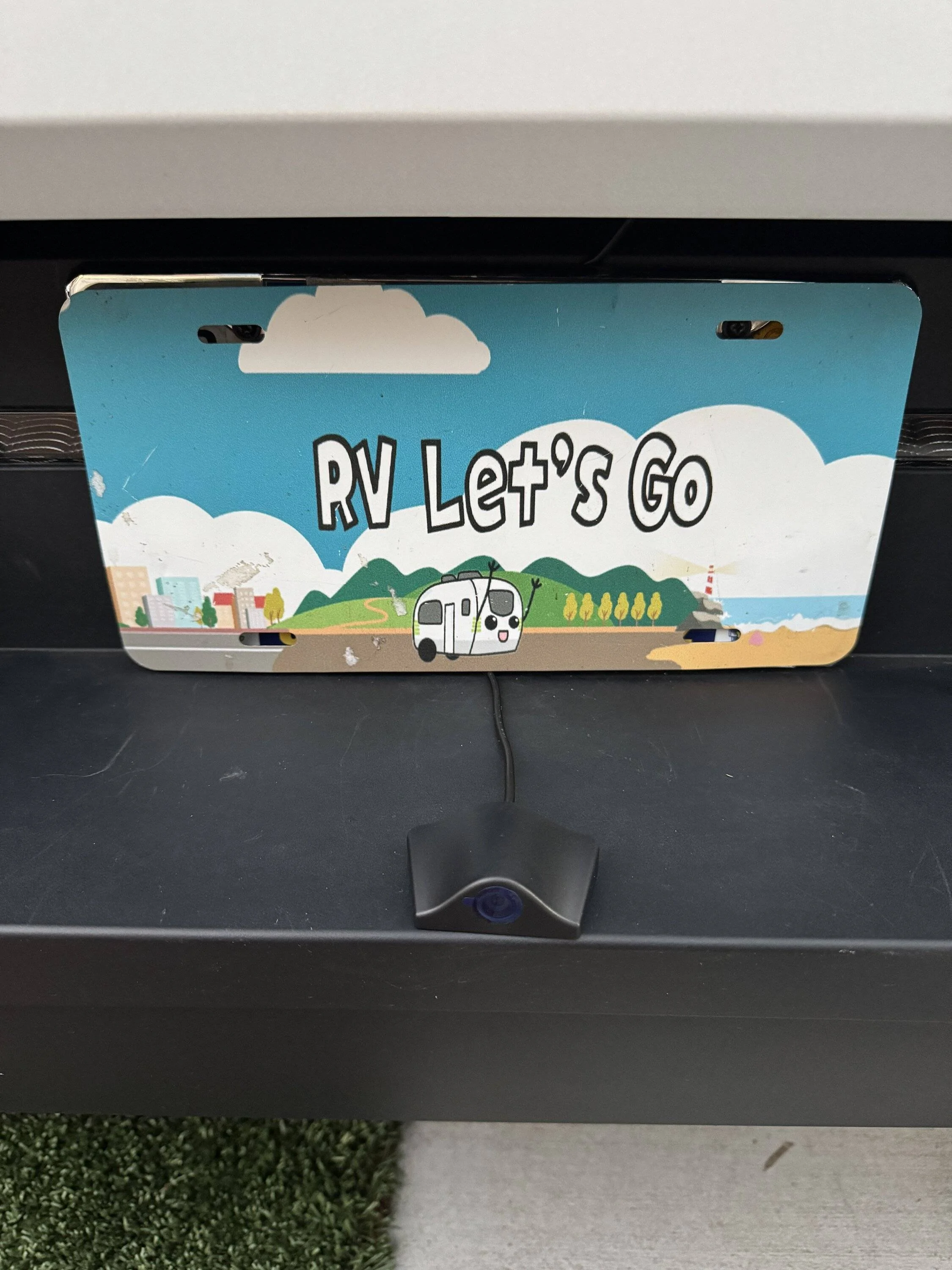

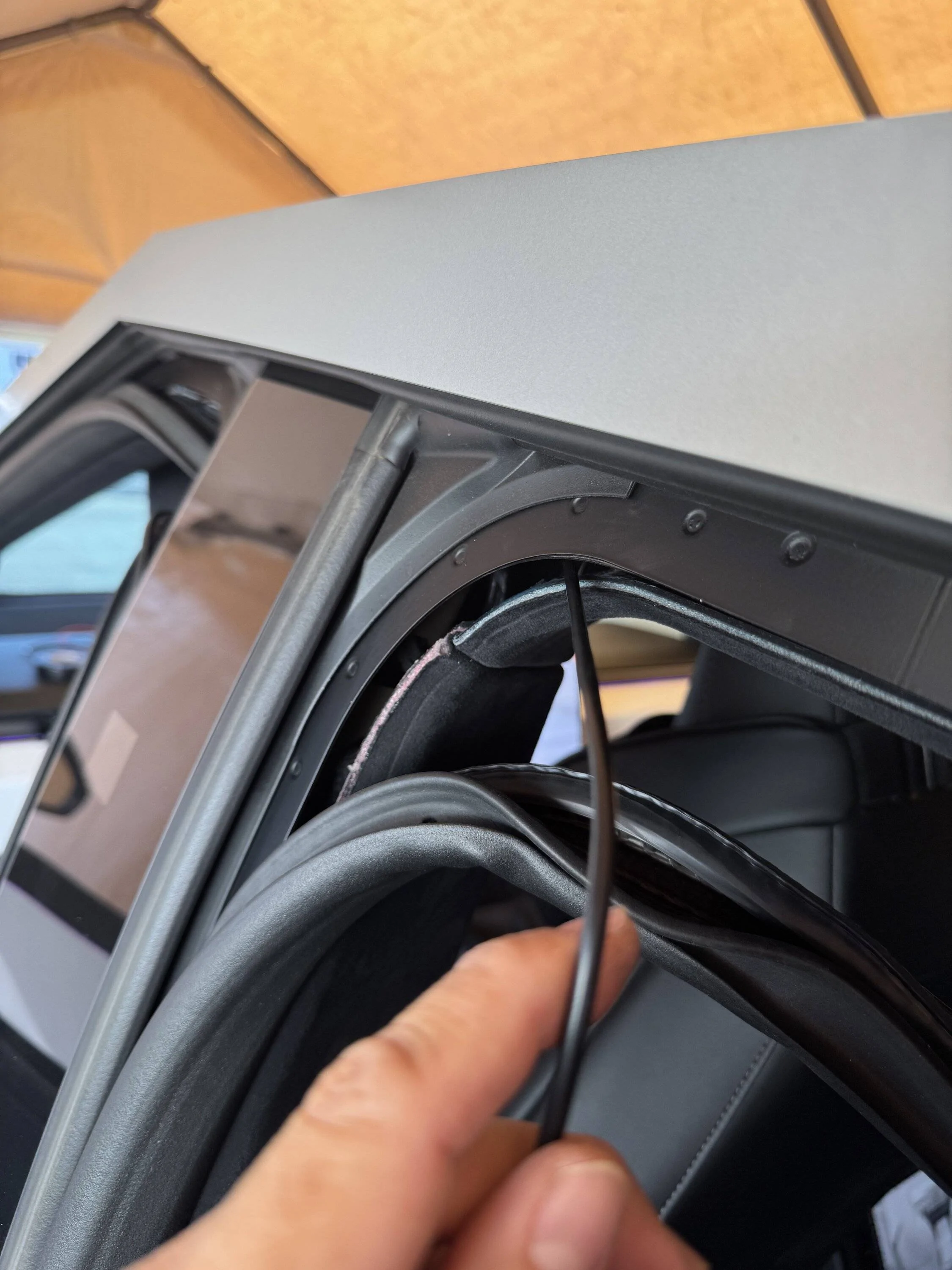

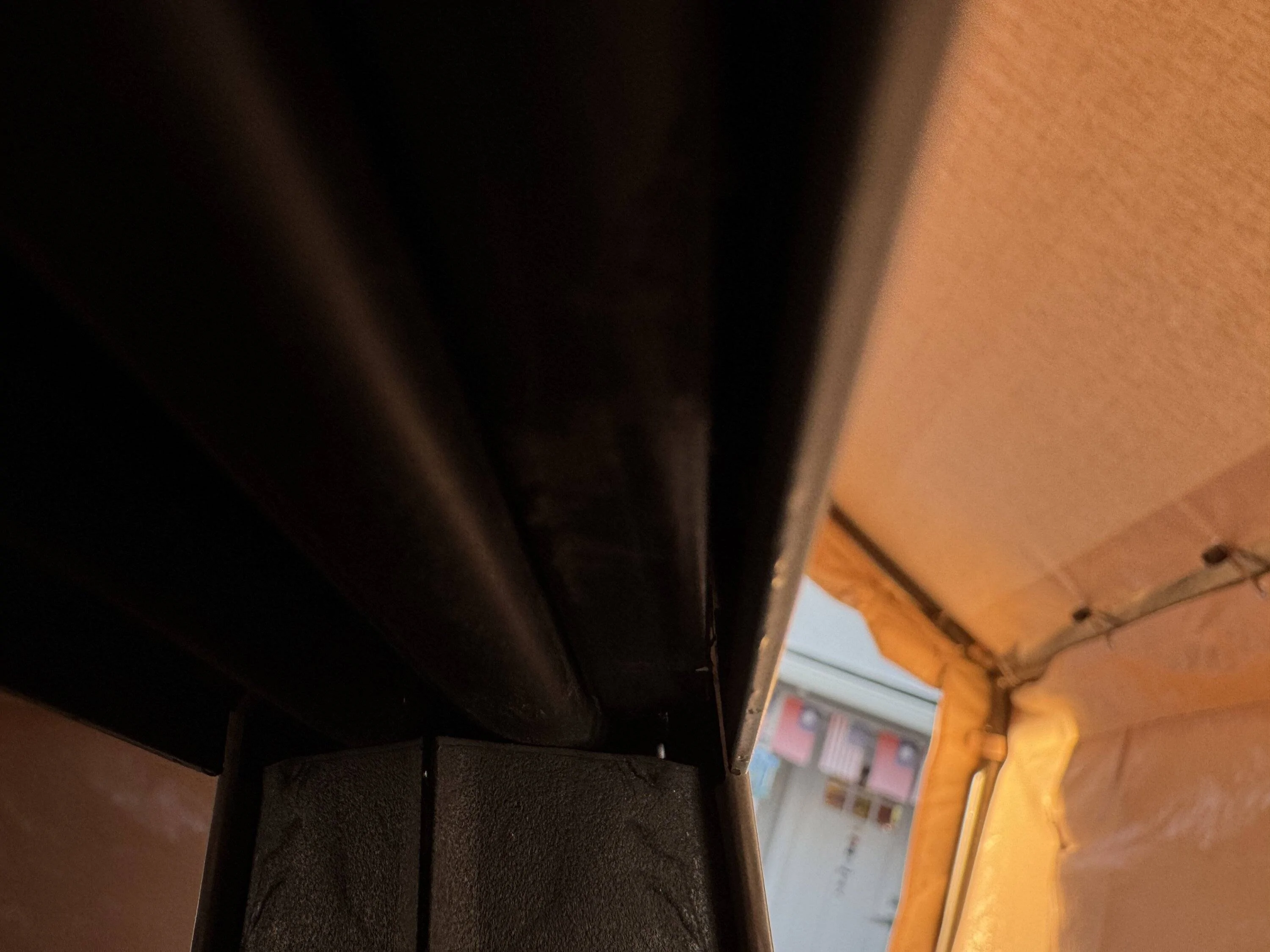

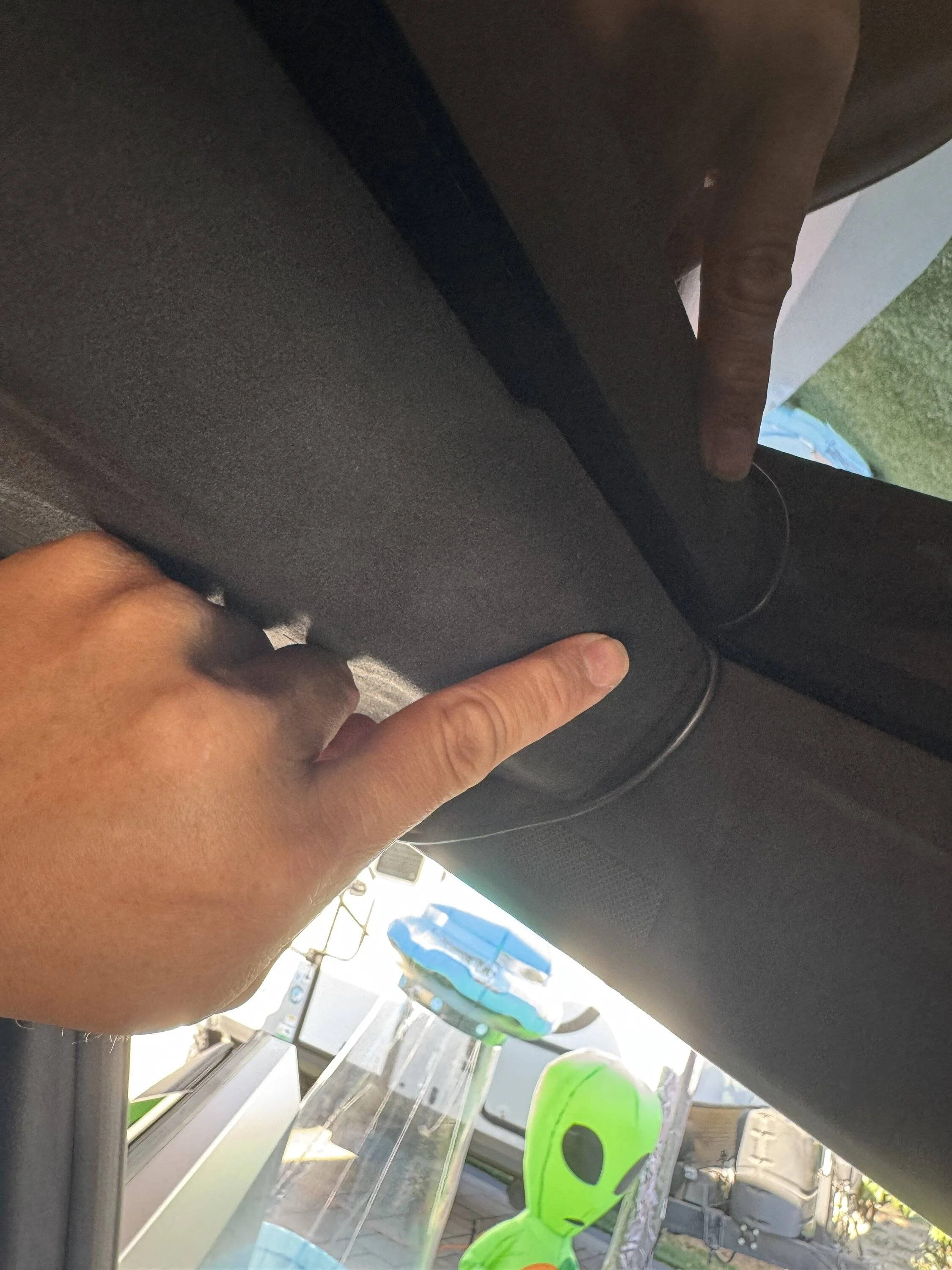

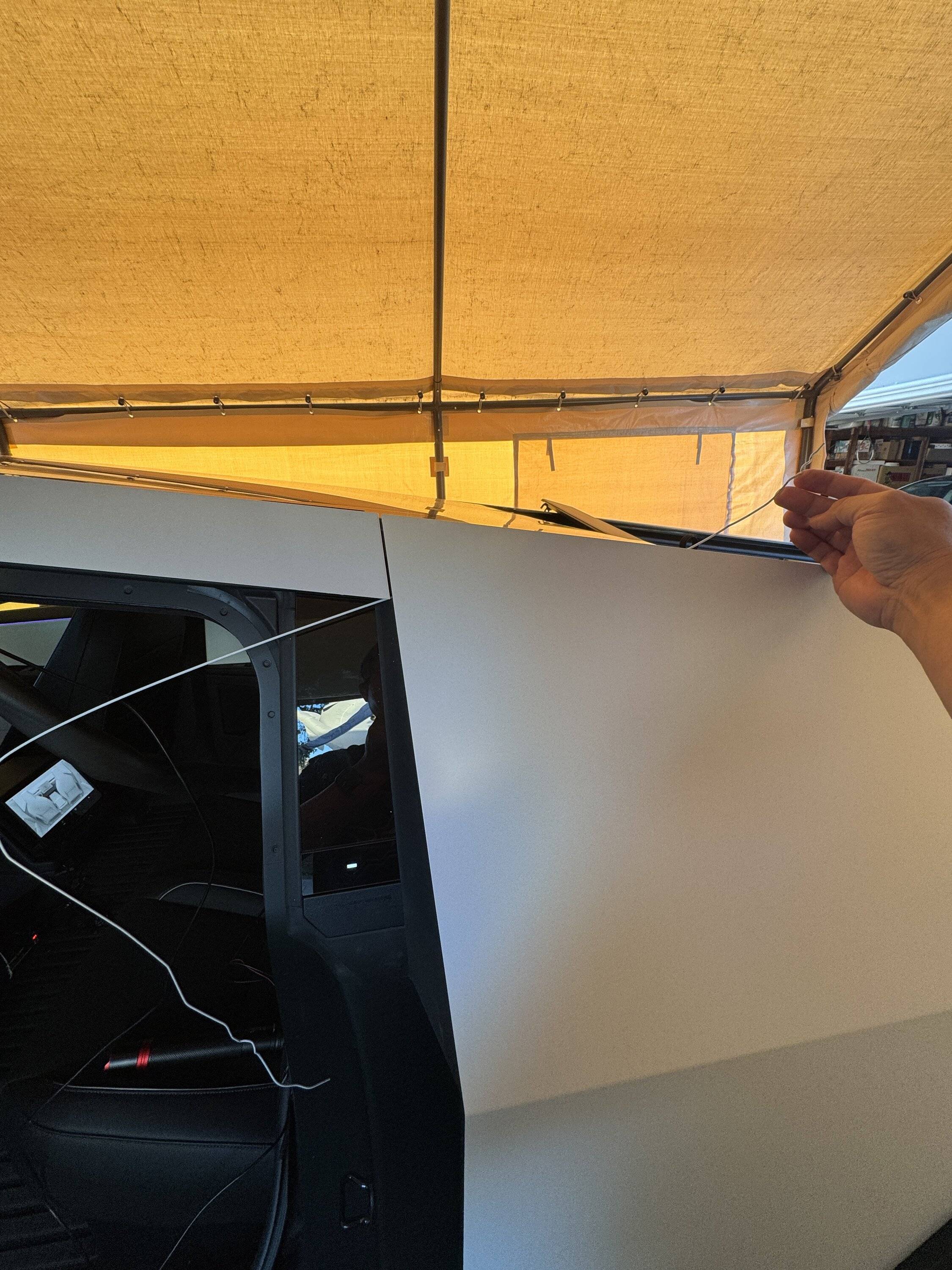

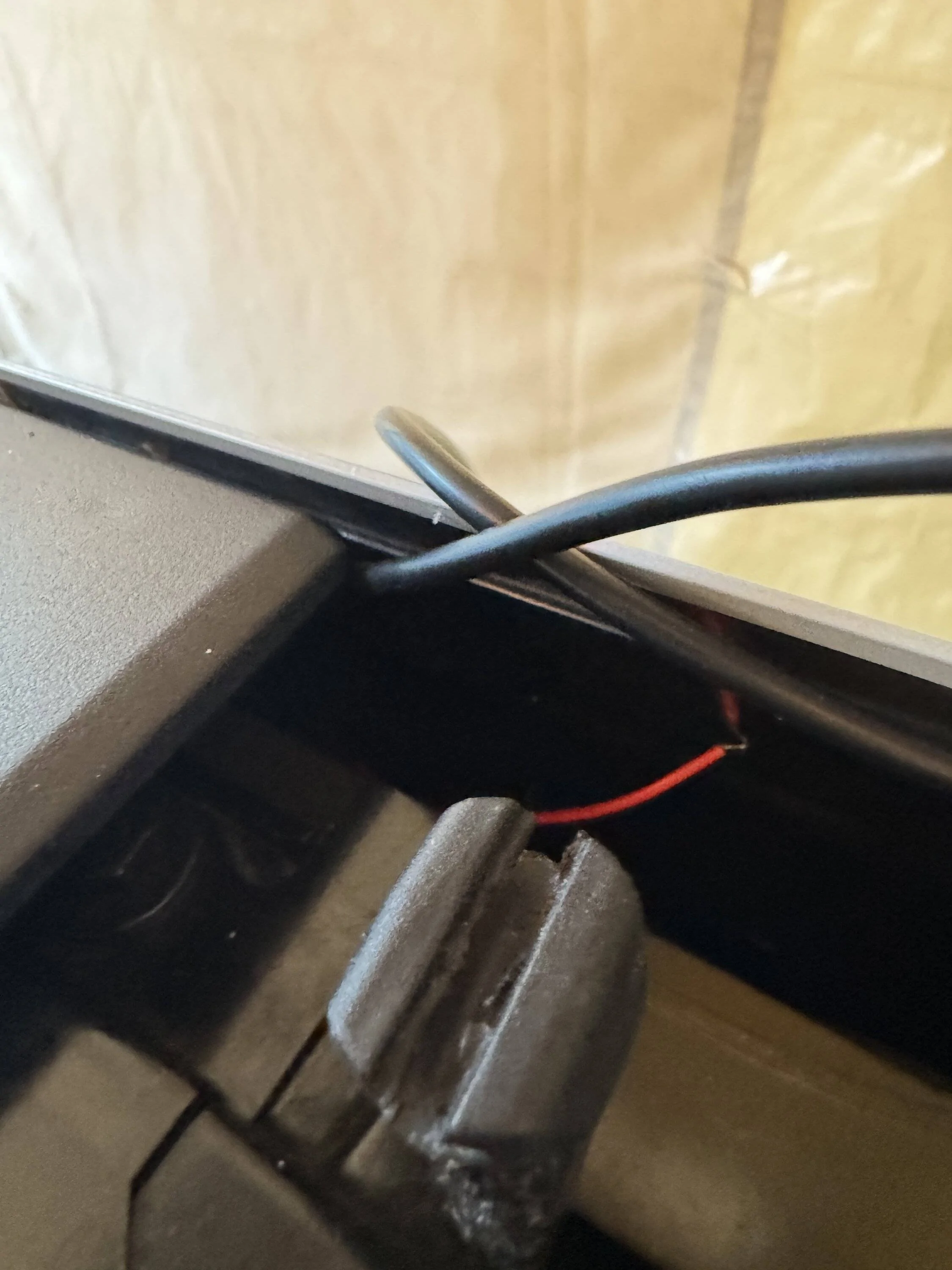

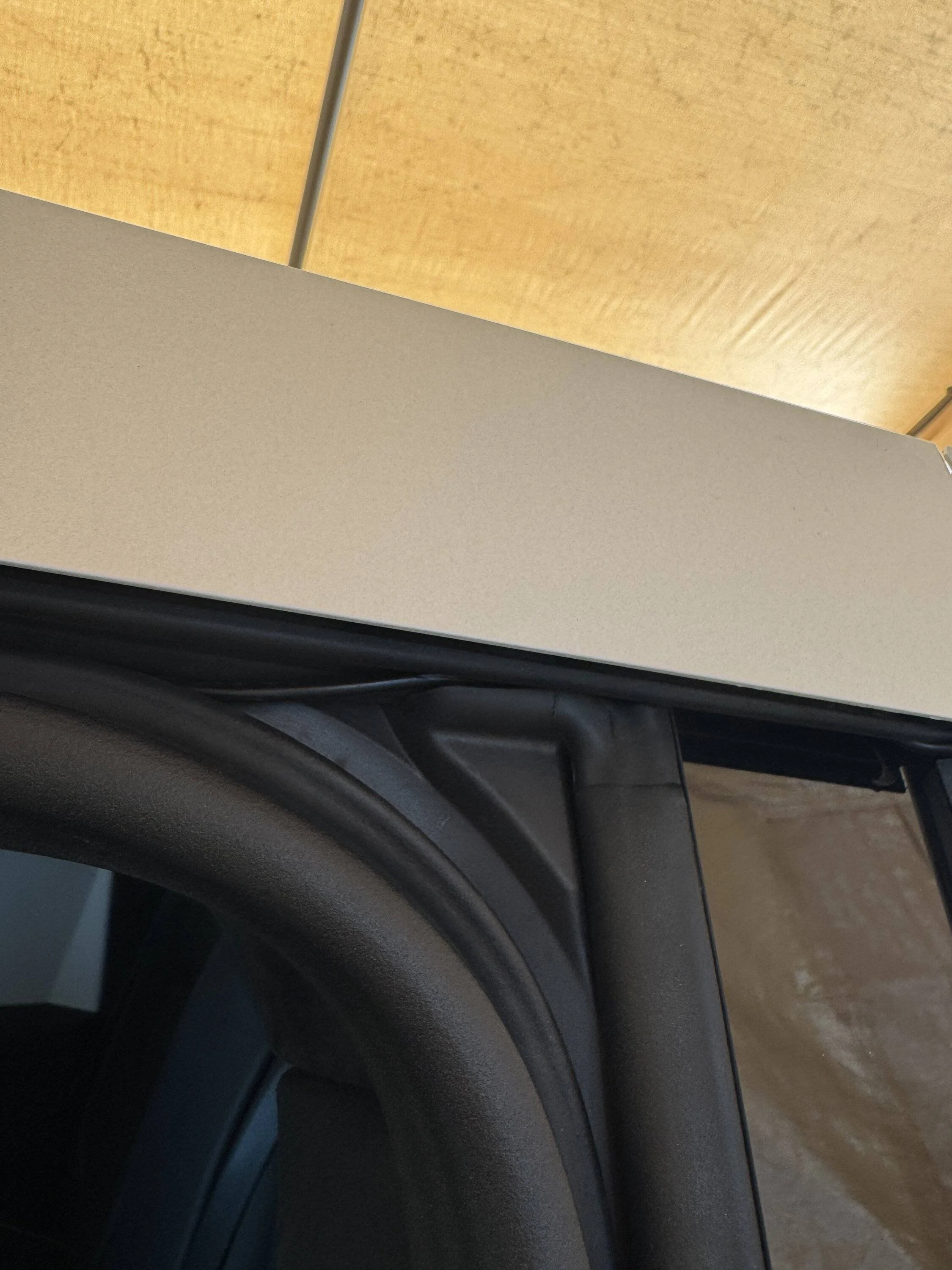

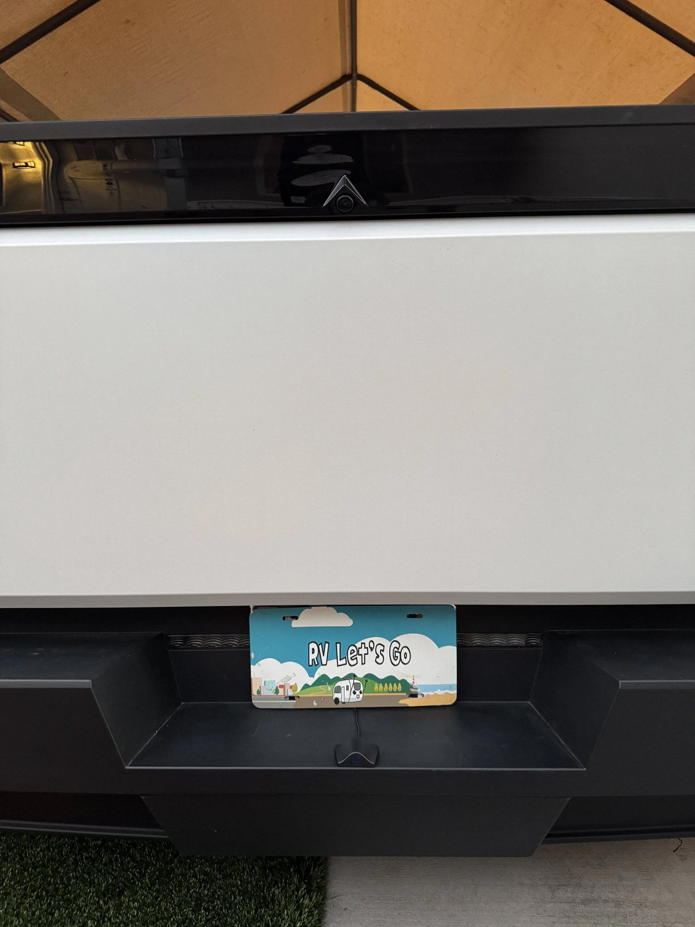

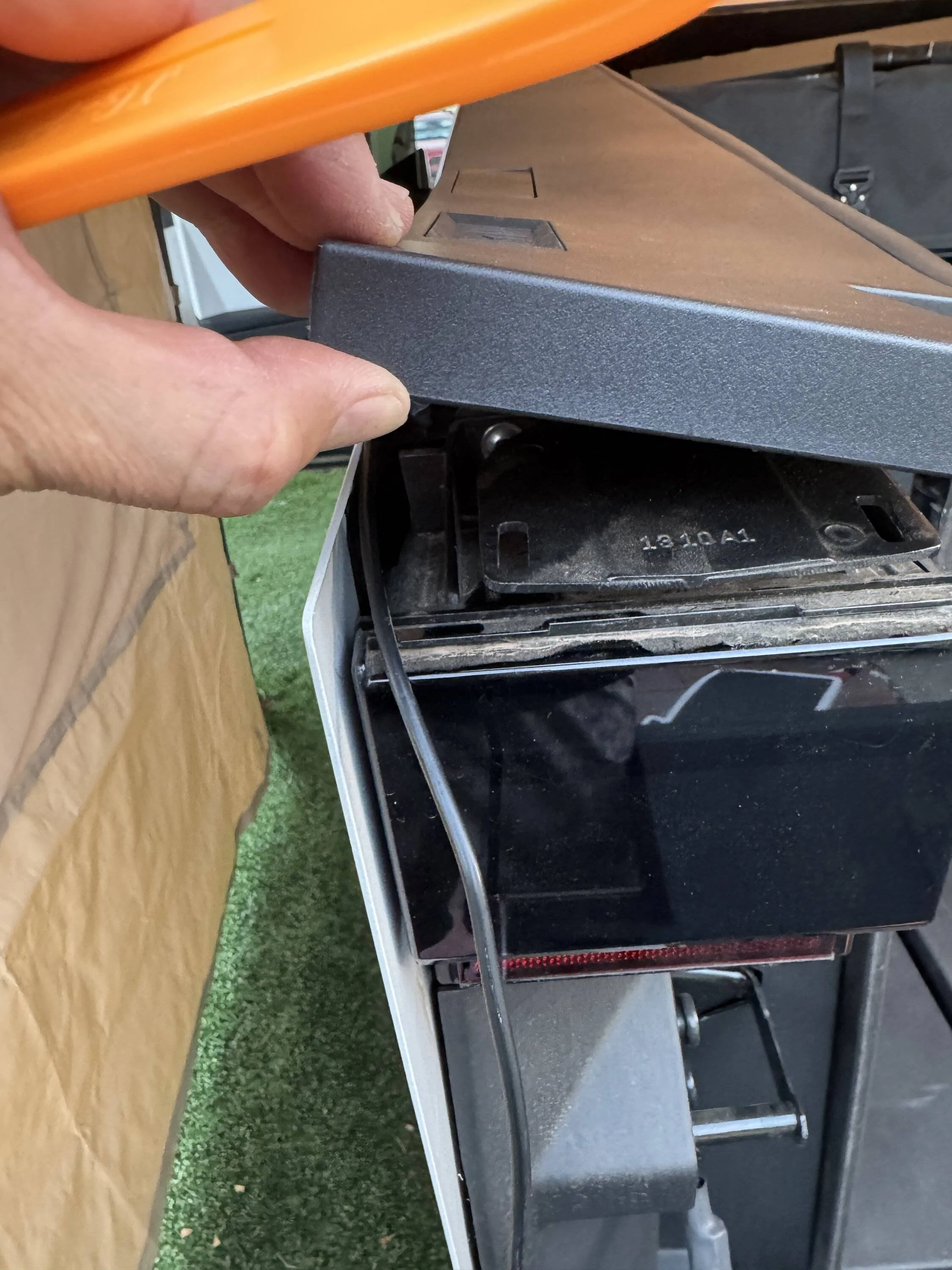

The rear digital mirror just $89 now. Quality is good. Worth the monty.
It comes with front/rear dash cam, Apple Car Play, Android Auto, GPS, 64GB SD card.
I just took 30 minutes to install it. It much help when I driving when this digital mirror.
This is a short video to show to how to run the rear camera cable from Cybetruck windshield to tailgate.
Tesla Cybertruck Easy way to install a digital rearview mirror on your Cybertruck (how to run camera cable wire from windshield to tailgate) IMG_2753

Nice job Jacky. I would prefer the rear camera to be higher. Maybe mounted behind the rear glass just in front of the bed (on the plastic trim piece you remove for Cybertent).
I have Cyber Tent. So I cannot mount camera at that place.

I tried that camera, it’s 170 degree FOV great for backing up, horrible for driving as a rear view mirror replacement.

I saw a video on YouTube where a guy installed it just over the tonneau, and I think it's the perfect spot for that.
