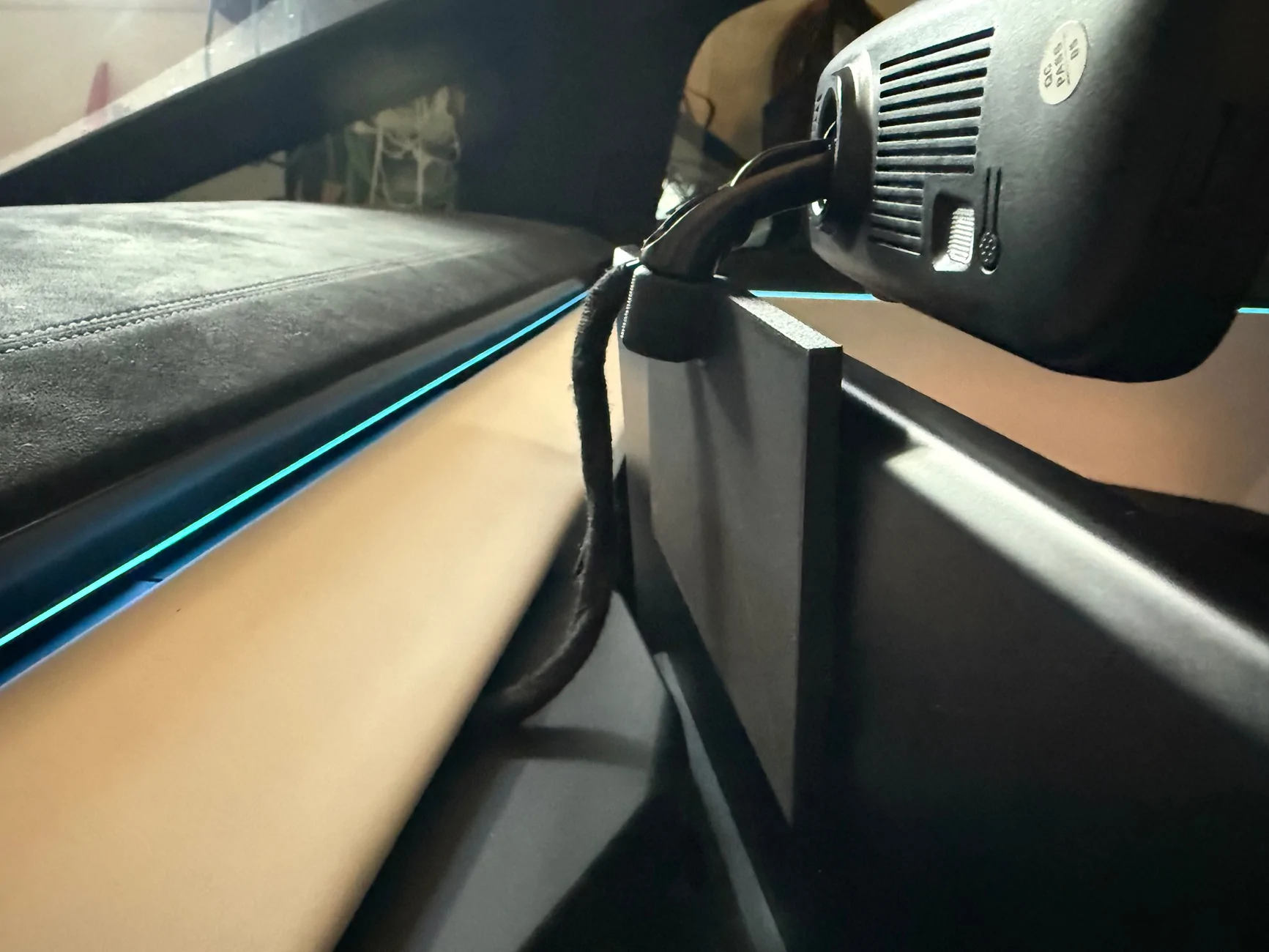

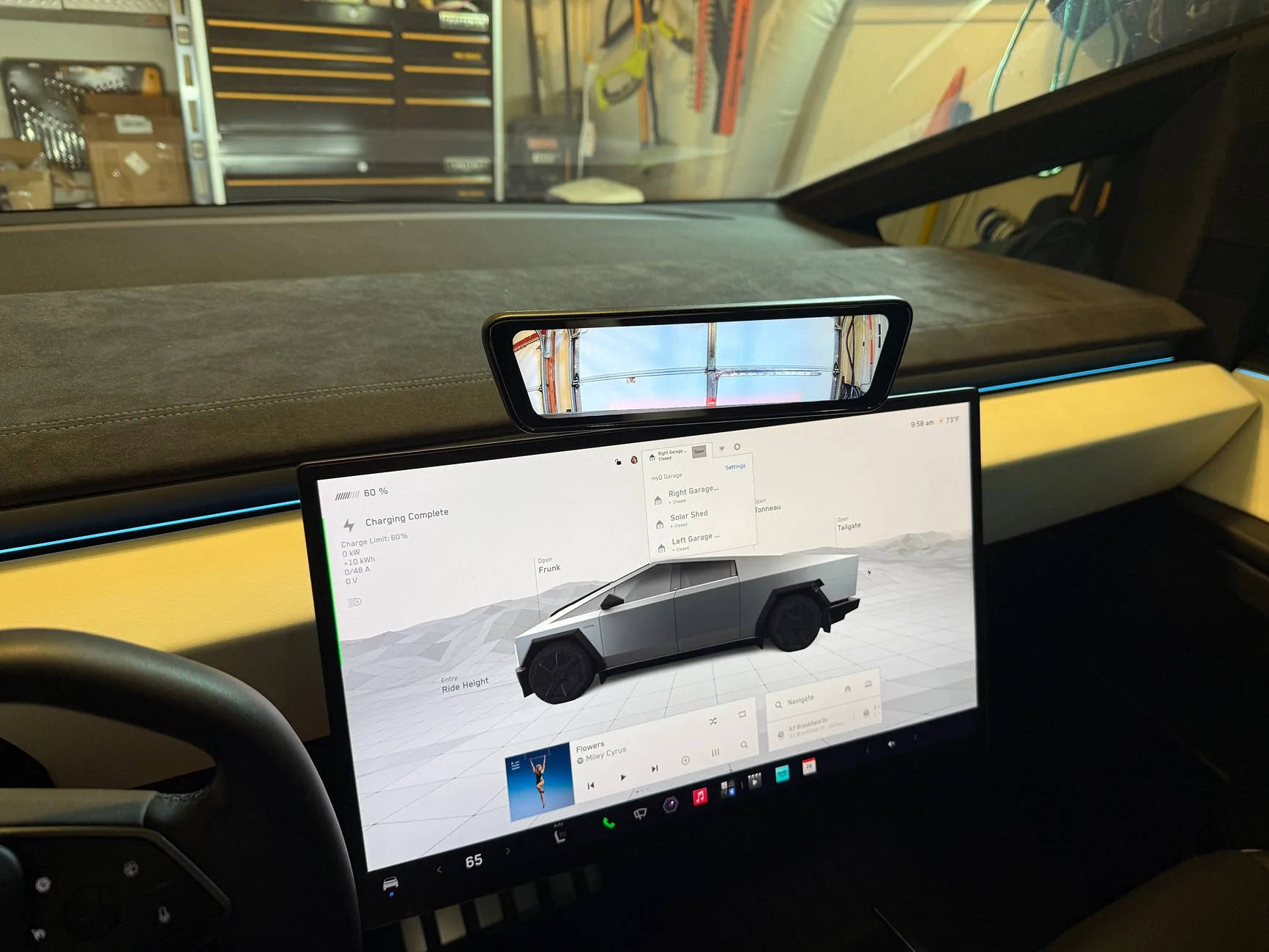

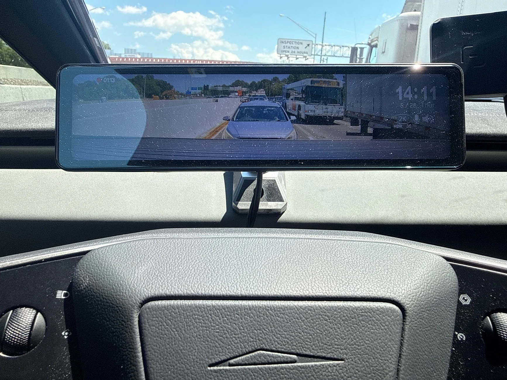

Finally finished my 2 year project of relocating my V1 Hansshow Mirror to just above the screen. IMO, this is where the dedicated mirror should be for those that want one. It blocks nothing and is basically an extension of your display without taking up space on the OEM screen. It's attached to the mirror using a custom mount I created and am very proud of since I've never used CAD to create something. (Thanks Grok for the guidance on Autodesk) I used the mirror and ball mount it came with and screwed the mirror into my 3D printed piece. More than happy to share the STL for those that want it.
The mirror and mount attach to the screen with VHB tape. Yes I'm nervous about that for many reasons but mostly how will I ever remove it if I want to. The mount is super sturdy and will not come off or break. PETG CF....

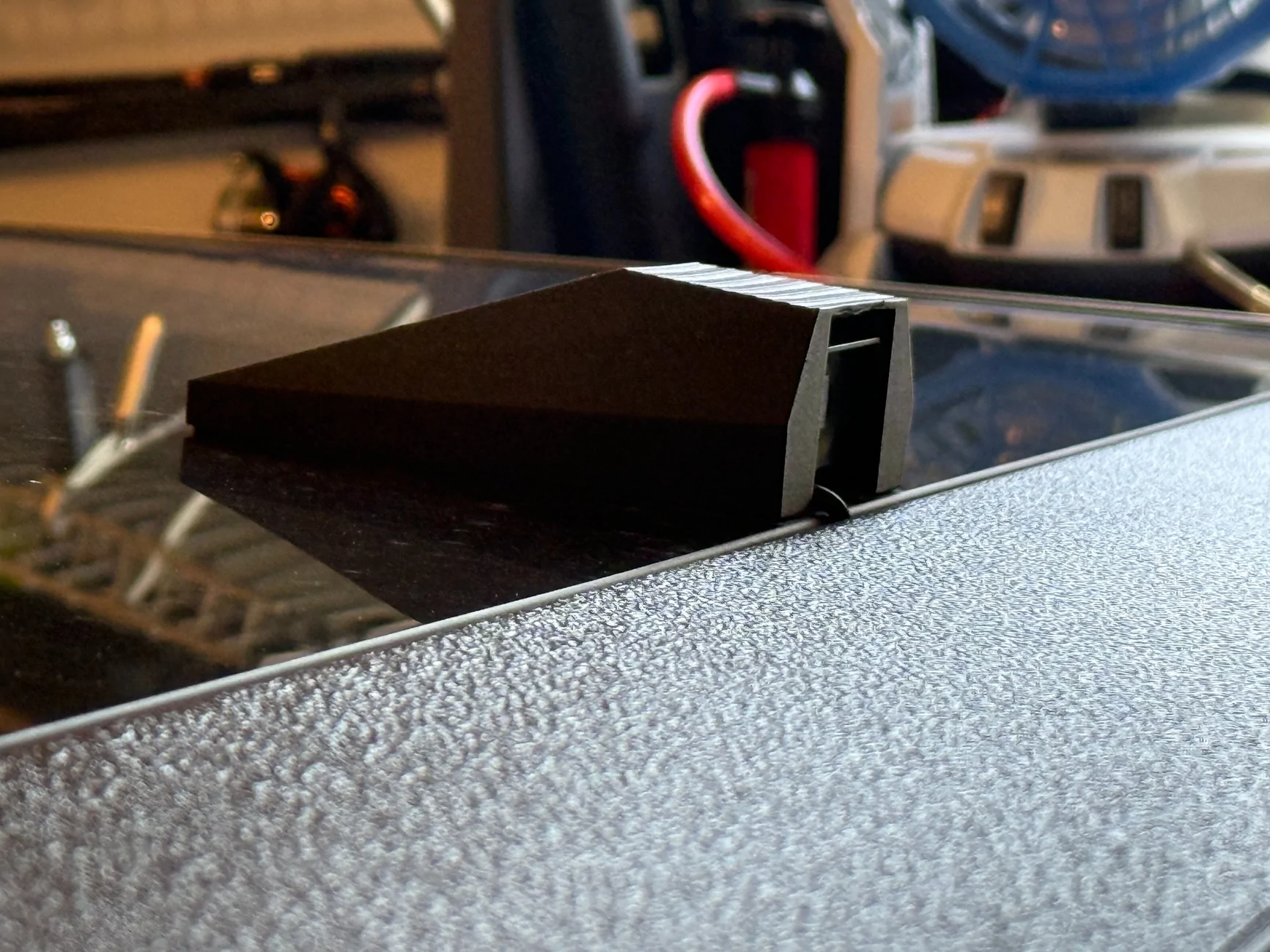

I also mounted the camera and housing on the glass behind the removable valence thing by the bed since I have the rooftop tent and that piece gets removed regularly.

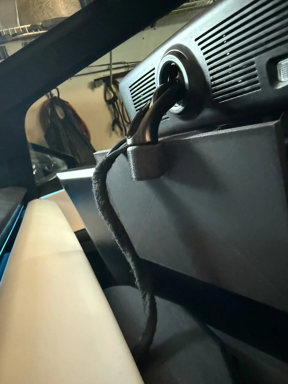

I had to extend the power lines from where the front camera is above our heads along the top down the pillar behind the dash and to the camera. Pictures will hopefully clear it up.
When I had the mirror mounted where it originally was supposed to be, it blocked some of my view and interfered with my GPS signal since there are too many wires needed to be jammed up there. The screw was also stripping as it's a nightmare to remove and reinstall the mirror when you want to clean behind the cover.

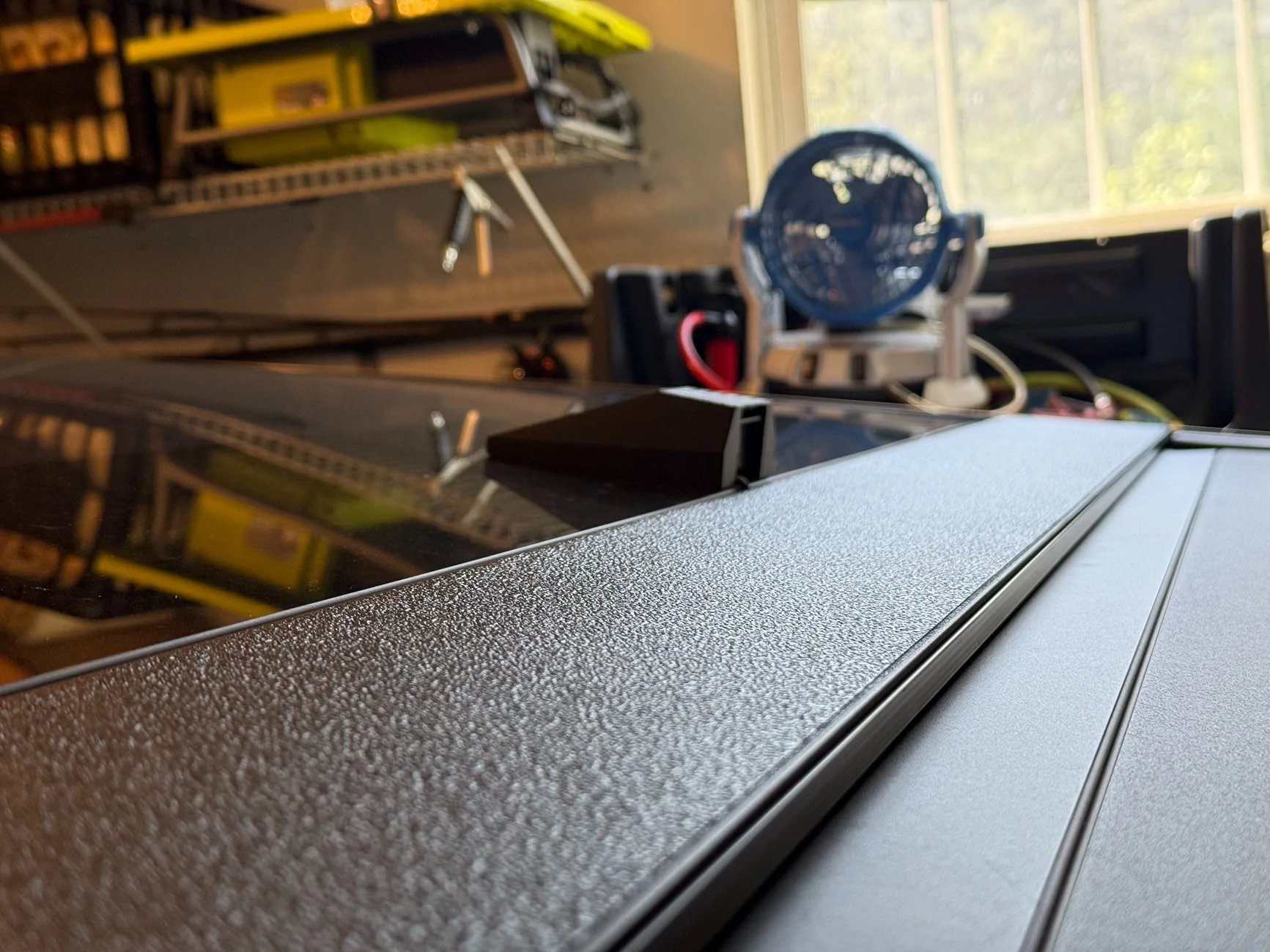

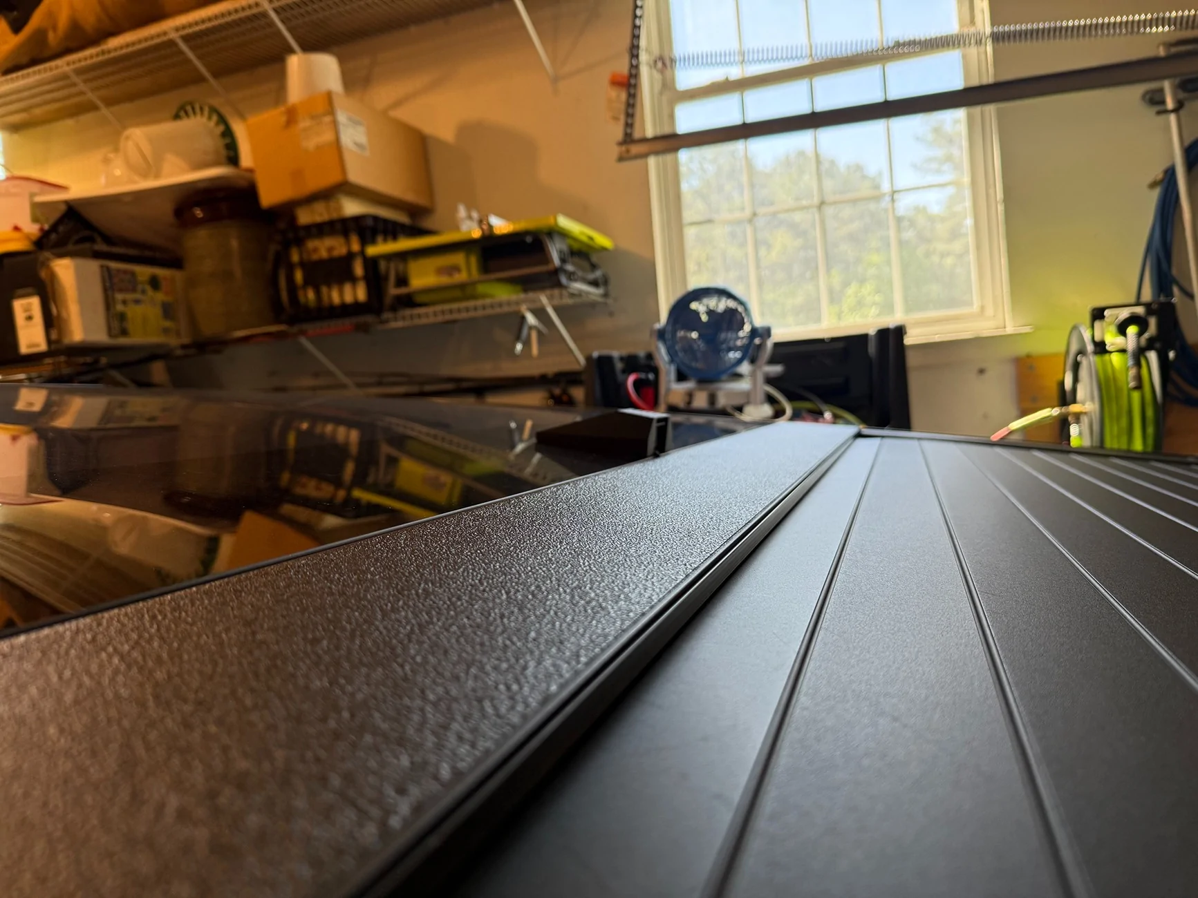

Nice work. Can you tell me a little about your wire management for the back camera?
I mounted mine on the glass like yours because I have a cybertent that requires aeroflap removal to set up and have had to replace two cameras for wire damage.
One was transected by the Tesla service monkeys when removing and putting back the aeroflap and the second one just started malfunctioning over time from compression.
How do you protect yours where it dives down to the rear window area?
I’m about to install a third and was considering just sticking it to the glass headed towards the cantrail without going under the flap vs drilling a hole in the front of the aeroflap to make room for it without compression.
Do you maybe have some close up shots of how you did yours?

I actually routed the wire a year ago. I believe I just pushed the wire into the gap between the aero and the truck. I'll take some pics when I get a chance. I do remember not having much of a gap...
