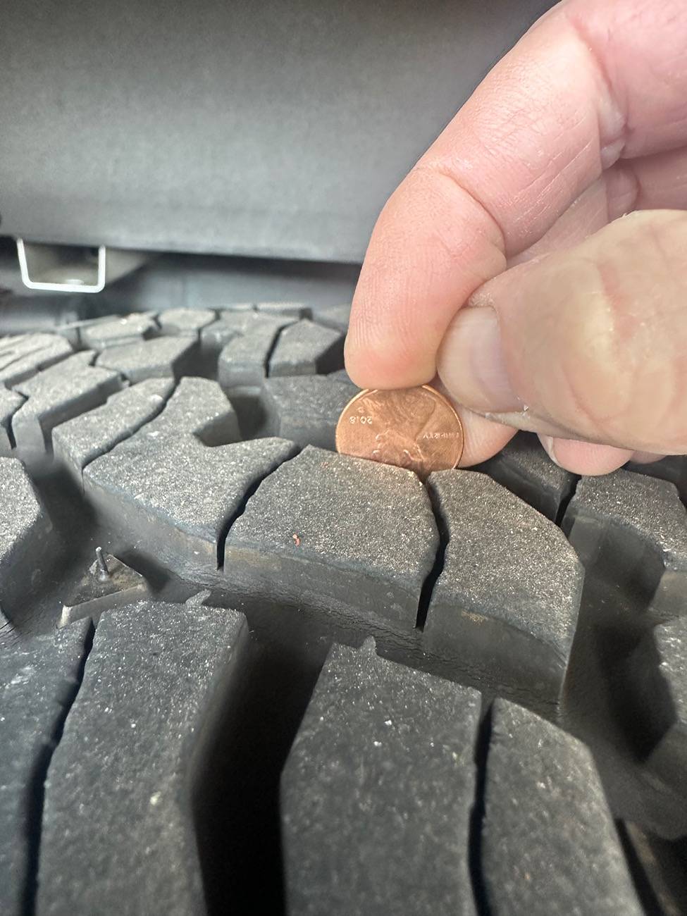

I believe they are T rated KO 2, I was always taught to measure tires with a penny and I have just over 30,000 miles and the depth is to Lincoln‘s nose, I was taught long ago when the tire tread depth gets to the top of Lincoln’s head that it’s time to replace them.

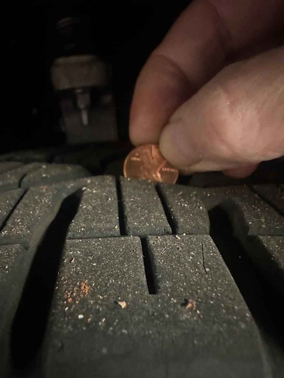

I’m also about the same tread depth on my cyber beast and it has 1500 miles.

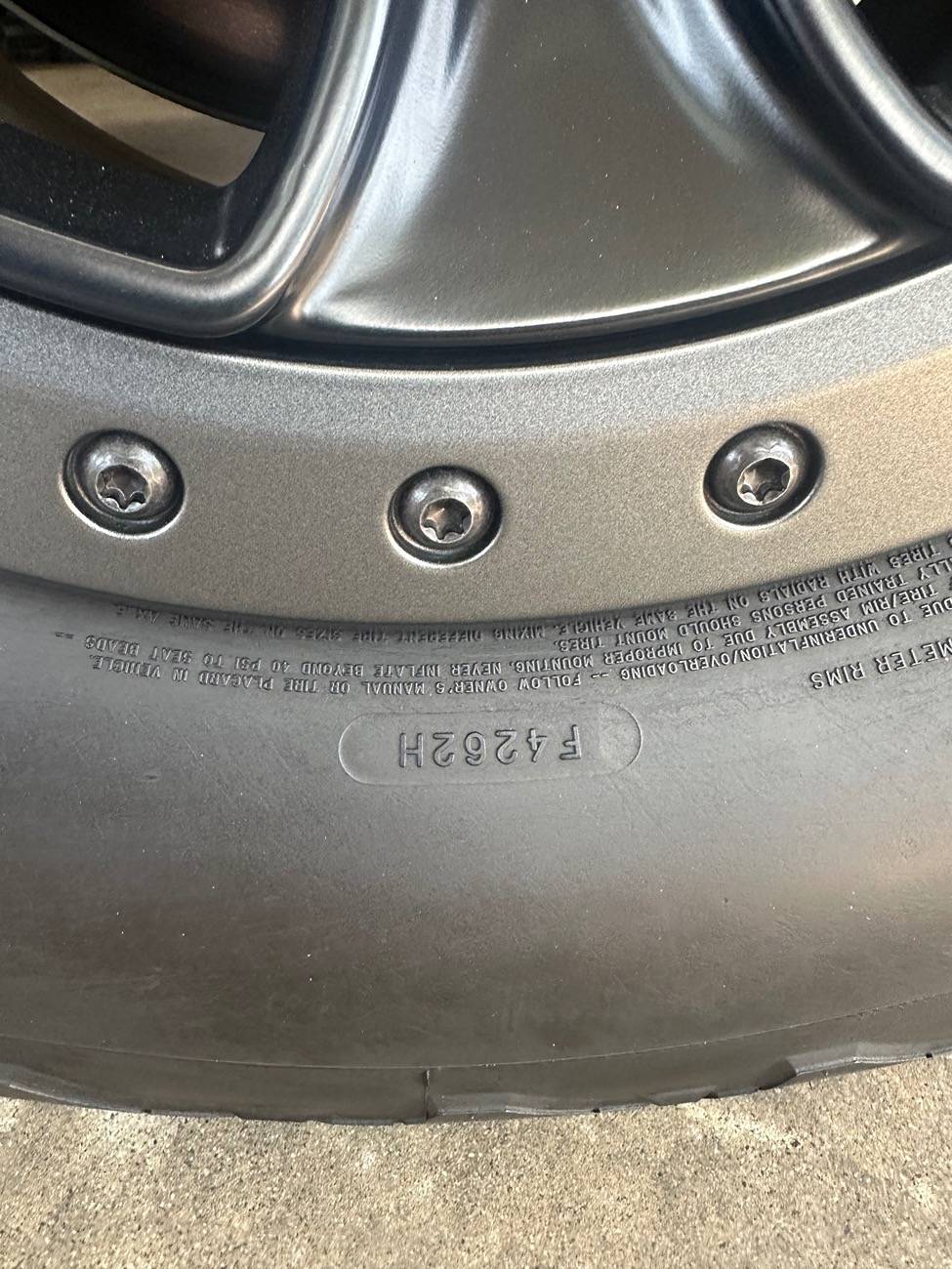

I believe they are H rated KO 2, I was always taught to measure tires with a penny and I have just over 30,000 miles and the depth is to Lincoln‘s nose, I was taught long ago when the tire tread depth gets to the top of Lincoln’s head that it’s time to replace them.
Yours are "T" rated to 118 mph. This tire has been discontinued, so cant get it anymore.

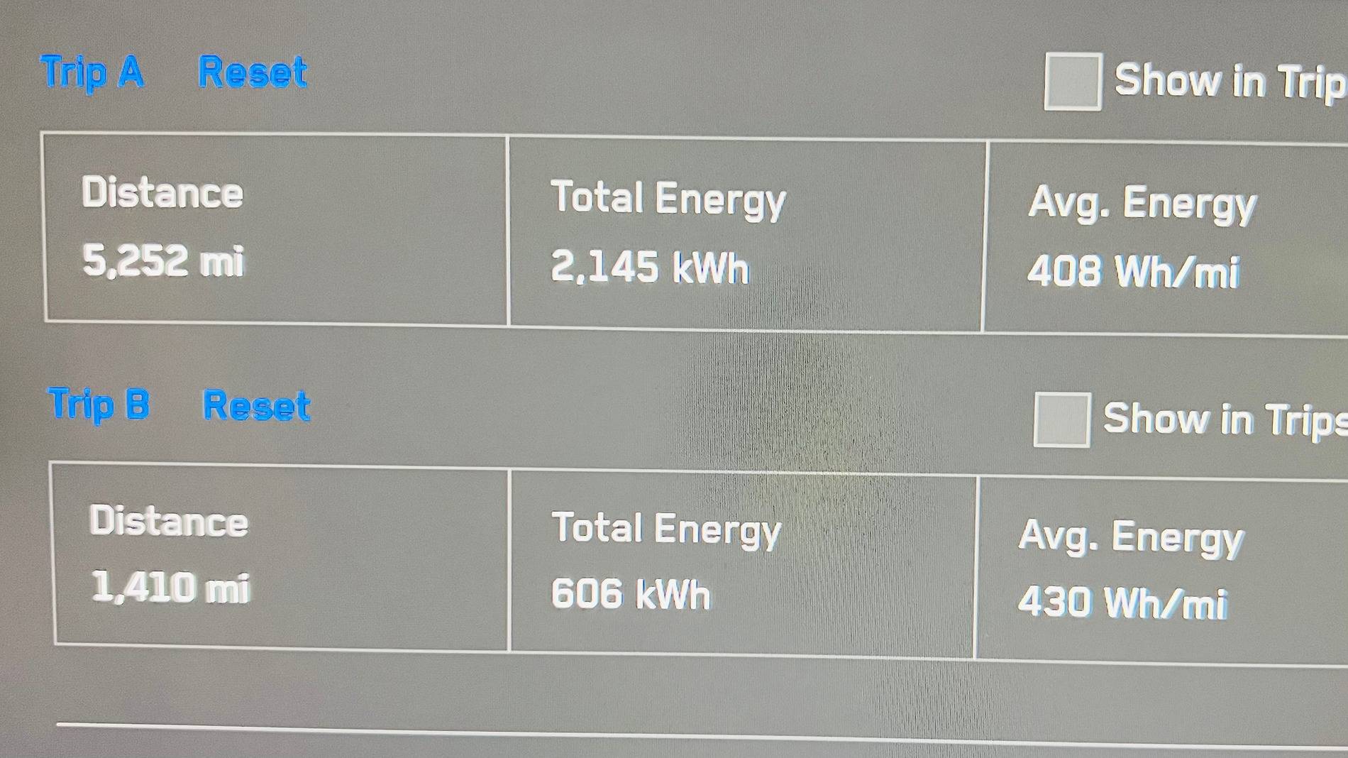

There you go. The Cyberbeast has 123,000 battery that gives 301 miles of range meaning rated spec WH/Mile = 123000 / 301 = 408.63 WH/Mi...
Look at my trip data 5252 miles at 408 WH/Mi almost exactly as rated specs and 1410 miles at 430 WH/Mi only 5% less efficient than rated specs.
This is not the data of a truck that has been driven like a bat out of hell... and yet... the crappy OEM tires are almost shot.
