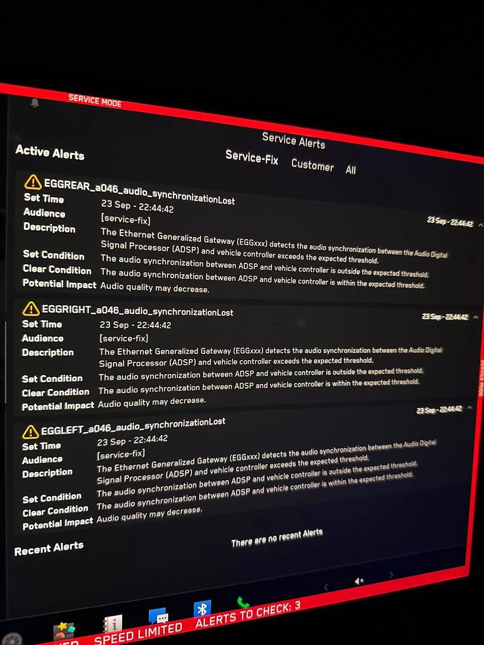

Started getting an error message saying audio system unavailable after the autopark software update, any ideas?

it wasn’t making the front beeps now for the frunk auto-open so I took a shot in the dark and took apart the front of the truck…someone didn’t plug in the front speaker at the factory…but now that it’s plugged in that error message went away, it’s still giving an audio sync alert in service mode with three eggs but nothing that it will tell you when you drive.
