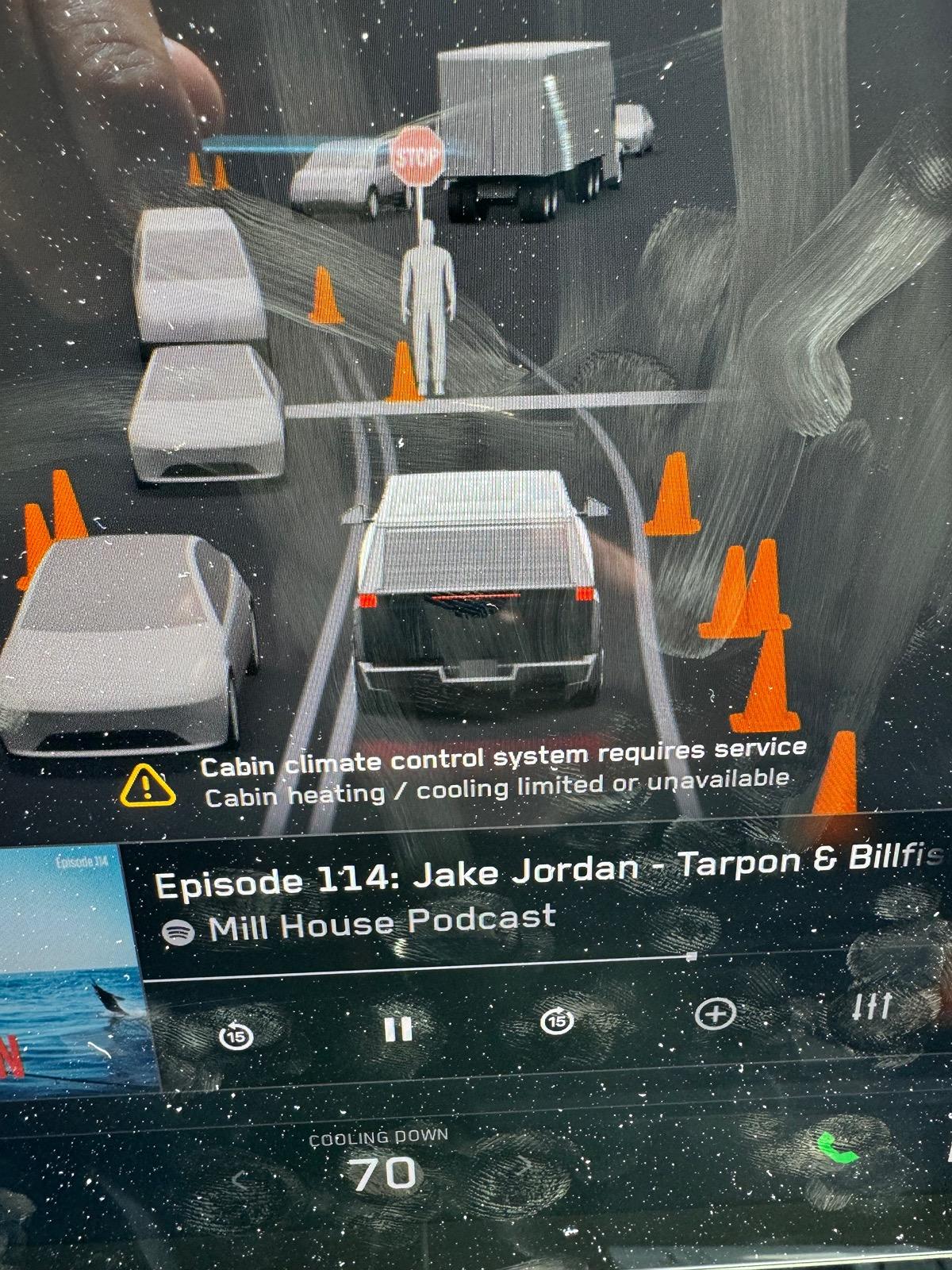

2nd day of having my CT and received a Power Reduced DIR_a126 message that says to schedule service. AC no longer works.
Anyone else see this before? I have service scheduled, but want to see if it's really serious.

Got this message but a/c came back on soon after. That was 1 week ago and no problem since
