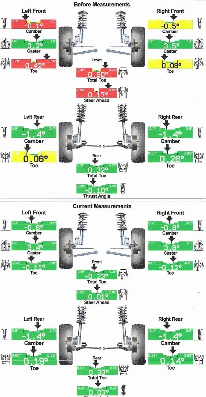

I just got alerted from Tesla service center that my Beast is ready for pickup. Work order shows that the front alignment was out of spec. They performed a 4 wheel alignment on the house thanks to my prior noise complaints found on record. What I don’t understand is why not rotate the freakin tires knowing that it’s 100% necessary. The rear tires are at 9.9 thread and the fronts are 6.5 and 7. I’ll be picking it up tomorrow. Wish me luck.

Thanks to the comments here, I was able to get Tesla service to understand the differences between CT AWD and Tri-Motor, and rotate the tires. They also detected that the final alignment was not up to spec, they found out both control arms from driver side where not allowing the alignment properly adjust, so they replaced and aligned again. Attached is my final results. Blessed be part of this community. I wouldn’t have known the front motor is grabbing first:
