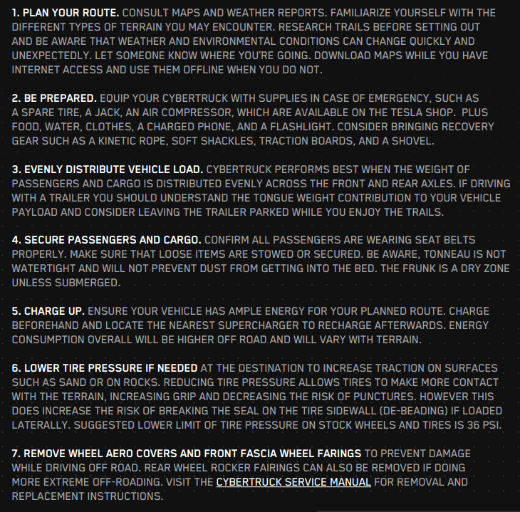

30-32 psi isn't recommended. From the OffRoad guide cybertruck_offroad_guide.pdf (tesla.com)
Look at #6, 36 psi is suggested lower limit.
I'm not sure which is worse, being stuck in the sand or having a de-beaded tire in the sand. Once it de-beads, it's just going to fill the tire with sand.
Tesla Cybertruck Experience on soft beach sand & overland sand mode? 1714763690626-9c
My mistake. I would go with recommended pressure from the guide.
