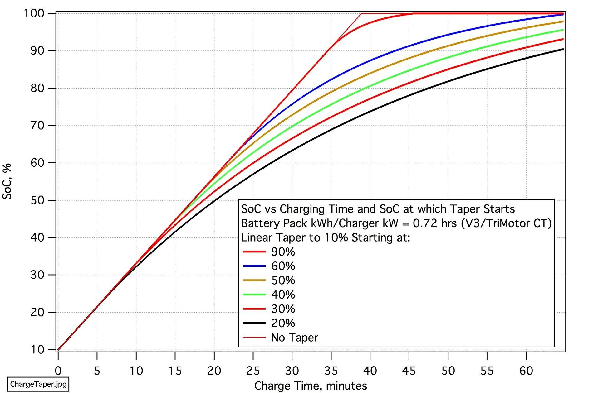

For one, I assume the cybertruck batteries will charge faster because of improved cooling and less resistance, meaning they will not be forced to taper down charging as much as current vehicles.
I kept taper out of it because I wanted to keep it simple but taper really doesn't have that much effect. The scenario I chose has the driver replacing half the battery presumably after every 4 or so hours of driving. If he manages his charging well that will be between 10% and 60% as opposed to 45% to 95%.
As the chart shows it would take 21.6 minutes to do this charge with no taper, 23.1 minutes with taper starting at 20% SoC and and 27.3 minutes were the taper to start at 20% SoC. Tapers are assumed to be linear down to 10% of the charger's capacity at 100% SoC. OTOH if you are talking about a fuller charge, taper has a very great effect and it is clear that a manufacturer who doesn't start taper until 90% can earn big bragging rights by talking about the fact that he can charge to 90% in 35 minutes as opposed to his competition's 55 - 60 minutes time for the same thing. There are many games a manufacturer can play simply by changing the "size" of his battery by refining where 0% and 100% SoC are and there are those who accuse Tesla of "cheating" in this regard. But as I said, I wanted to keep it down to the relatively simple implications of the fact that Tesla's biggest charger is 250 kW while its competitors have access to 350 kW. And my basic questions remain "Will Tesla grant access to the larger chargers already out there?" (have to rewicker the battery and add CCS) and "Will Tesla build a 500 kW charger?" with the 500 kW charger being 2 V3's in 1 cabinet with two hoses (have to add a second charge port).
I am anxiously awaiting any further revelations. I just don't see how Musk could tolerate being in second place on charging.
If tapers happen because of heat, lower resistance and better cooling might reduce the need for them. But I’m not an engineer, obviously.
