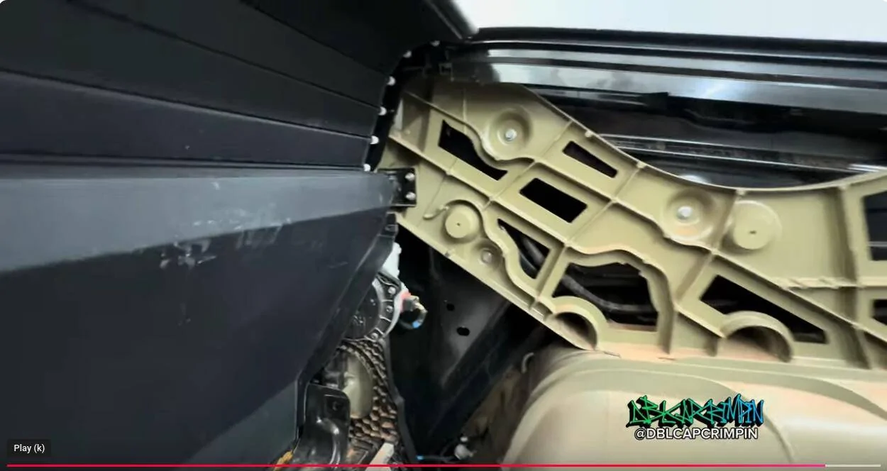

I'm going to run a 48V feed from the roof to my bed for a CPAP. Any tips or pics of how you routed the wire?
