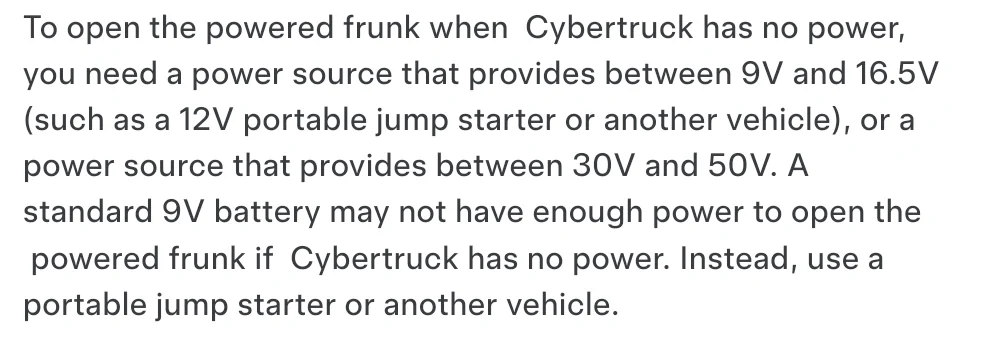

I have several 40v 6 amp Ryobi batteries. I am thinking about getting an adapter that has a switch on it so it is around to connect up to the Cybertruck. I think I can use that both on the connector right outside the frunk in the right wheel trim to open the Frunk and then connect it to the posts to boot the truck. Does this make sense? I see these adapters on Temu.

It looks like 30-50v is fine, see #2 below from Tesla manual. The product basically is a molded device that lets you attach a Ryobi 40V battery and has two wires to connect to. One has switch and the other a fuse. So you can turn it on and off quickly to just pop the frunk. Then hook up to the posts on the inside. The question I have not resolved is the voltage on the posts in the Frunk. Nothing in the manual says how many amps are necessary. This is the only thing I found on the posts in the frunk. " Cybertruck uses a 48V low voltage architecture. As a result, some functions may be unavailable or degraded if you are supporting Cybertruck with less than 30V (for example, another vehicle or a 12V portable jump starter). "
  1. Note
    Applying external low voltage power to these terminals only releases the hood latches. You cannot charge the low voltage battery using these terminals. Do not leave the low voltage power cables connected to the terminals for more than 30 seconds – remove from the vehicle's terminals as soon as the hood latches.
  2. If you are using a variable power supply, set the supplied voltage to a value between 9V and 16.5V or between 30V and 50V.
  3. Turn on the external power supply (refer to the manufacturer’s instructions). The latches are immediately released and you can now open the powered frunk to access the front trunk area.
May 27, 2024
4,646
5,652
  1. Note
Yeah, frunk can use midvoltage
https://www.tesla.com/ownersmanual/cybertruck/en_us/GUID-4EC0FD18-0503-40FD-8C97-0F6BB39DA79D.html
