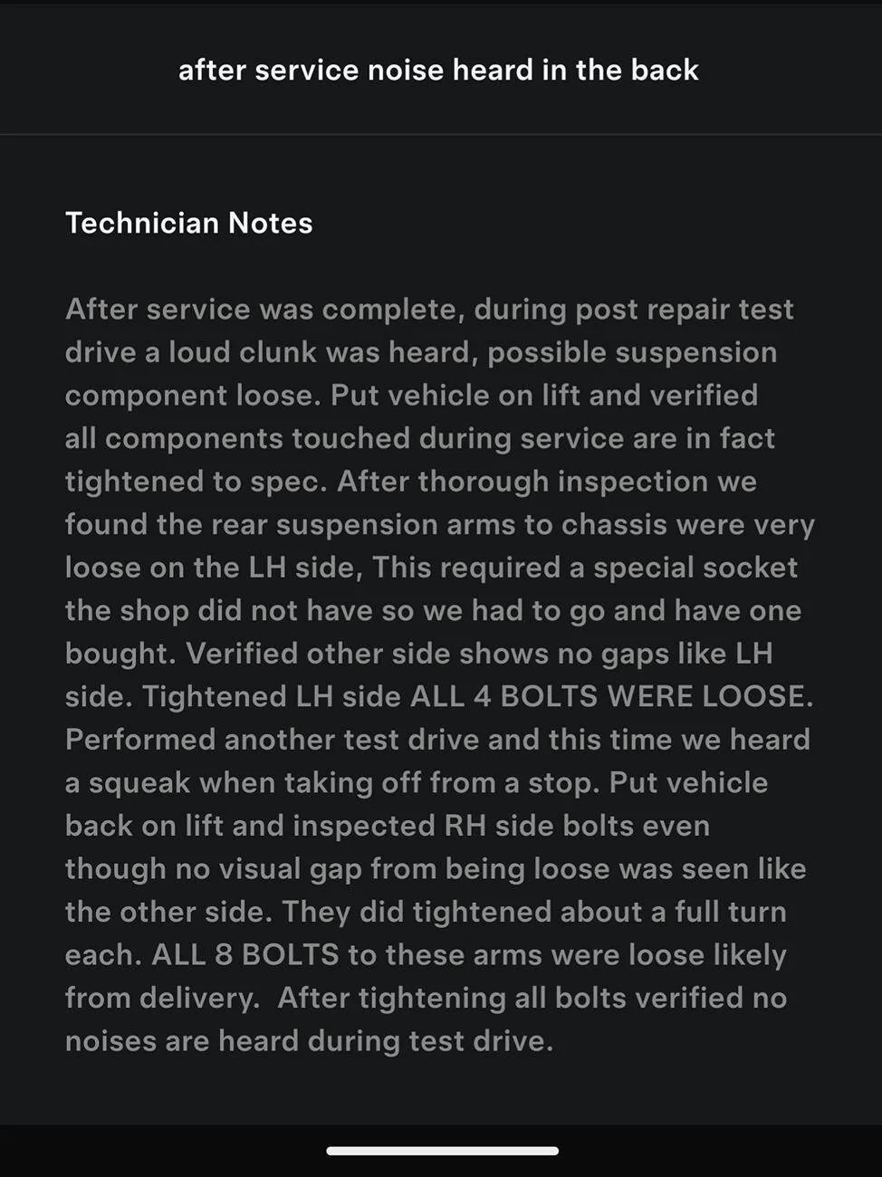

So, I took my CT in for the inverter recall Dublin, CA Service Center. They were done earlier than expected (next day instead of two days as initially estimated). And in addition to the recall work I saw this in the service summary:
Now, I noticed the rattling before, but assumed that's just how the truck was. Nice to get this fixed before having things fall apart on a freeway!
And shout out for the great customer service and doing a thorough job!
This truck was delivered back in February FWIW. If you hear any suspicious rattling or squeaking in the back when driving - get it checked!
