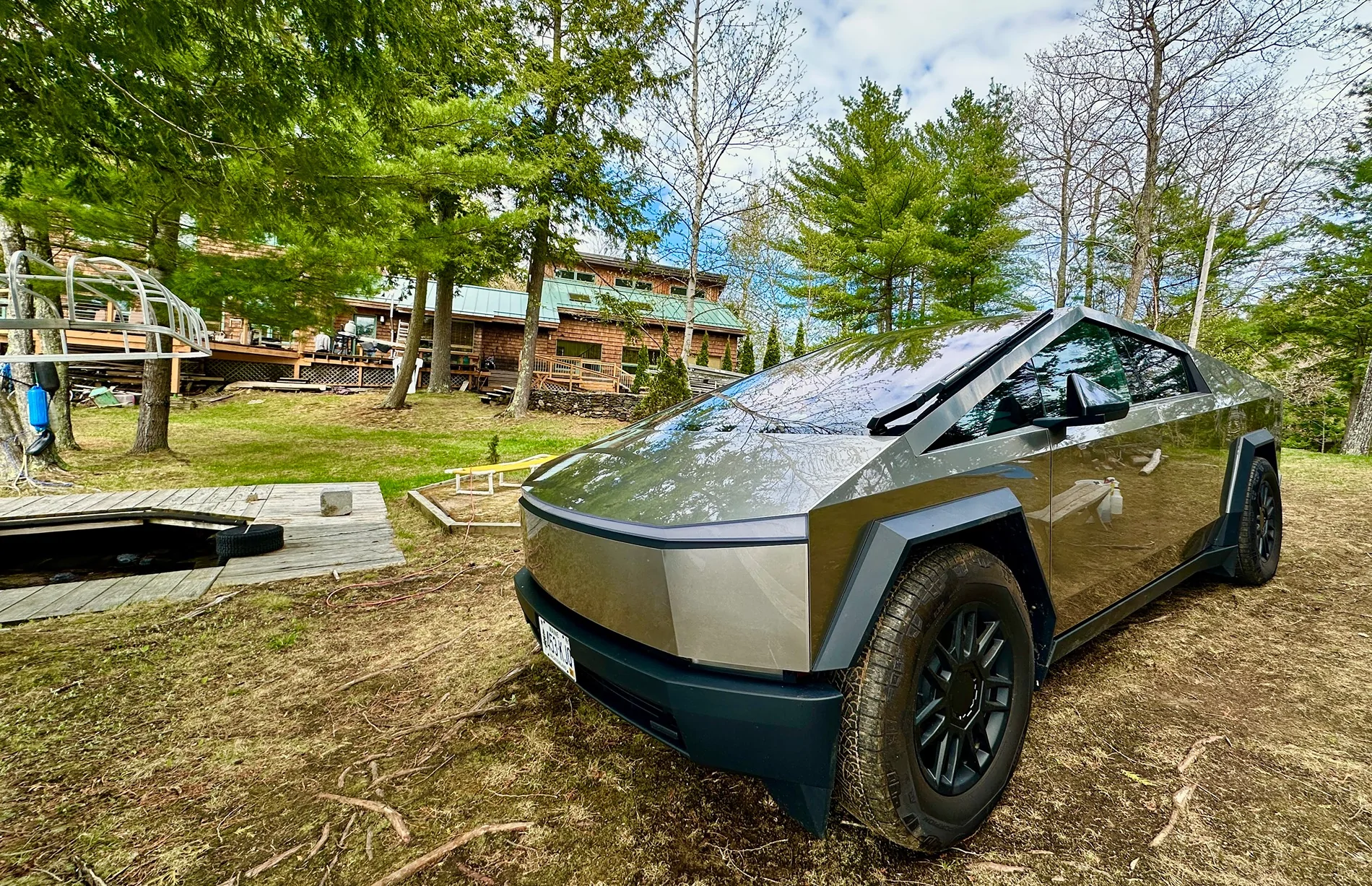

PPF is harder than vinyl wrap due to thickness. I didn't watch any vids when I got my kit for my 2018 Model 3, but the CT is easy compared to that. Everything is flat, curves are subtle.
My tip is to have another person help you to handle the size of the panels, especially the rear quarterpanels!
Tesla Cybertruck For First Time DIY Wrappers- What instruction video is best? IMG_0490
Because I don't have a garage, I had to pick a no-wind day. Shady area if outside. Watch out for bugs! Good luck!
