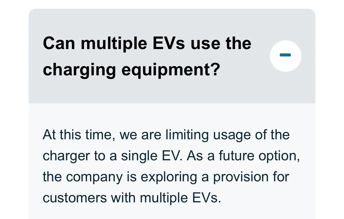

From the FAQ maybe I'm reading it wrong.
At this time, we are limiting usage of the charger to a single EV. As a future option, the company is exploring a provision for customers with multiple EVs.
Maybe that just means one at a time but that is peculiar wording. Nice to have confirmation that this is not the case. As to why FPL would care last I checked they aren't fond of giving away electric for free, even after hours.

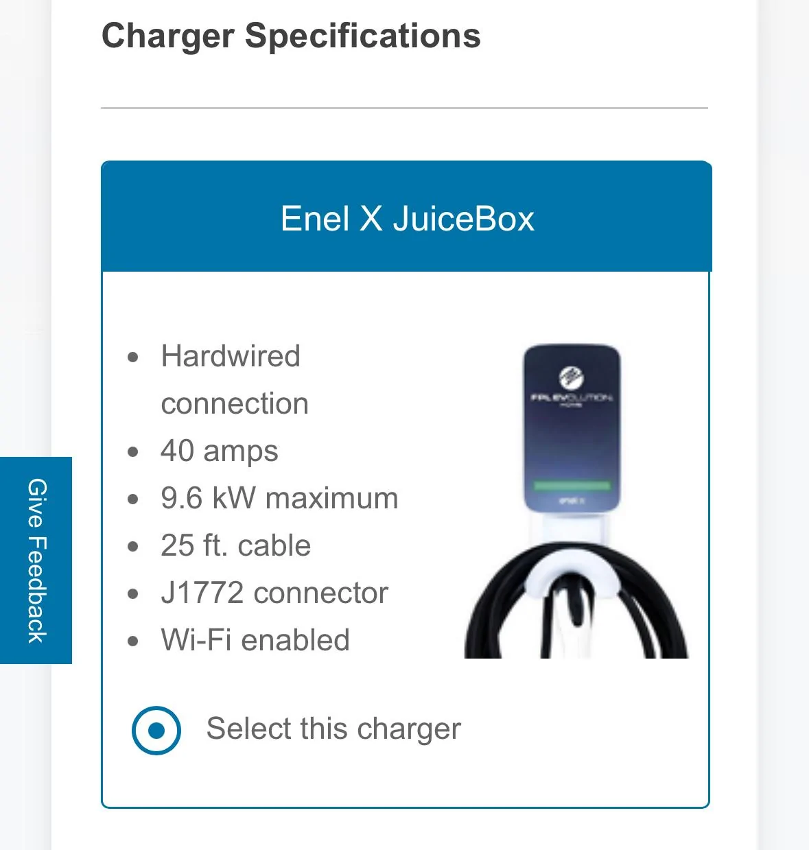

One other question I don't see answered on their FAQ. Does the charger plug into a standard NEMA 14-50 outlet or is it hardwired? The pictures seem to look hard wired.
The charger is hard wired I to your electrical panel. This wording is confusing but what they mean is 2 cars at the same time. Believe it or not, off peak power is not a major issue for FPL (I’m not going to mention how I know this….)

??Hey man I’m just going by the terms stated on the website. I have a 48A charger that I would not want to give up for their 40A one. Are you saying I can keep mine when they are saying I cannot?

1. They are talking about charging multiple vehicles at the same time. At some point this will be possible with Evolution. There is not a chance in hell that FPL or the Evolution system could tell what type of vehicle you are charging. It’s off peak power, why would they care?
2. They are not sending the goon squad to tear down your existing system. You need to run a new 50a circuit from your panel to the charger destination (maybe $300-$400 for a decent job). If you read carefully, FPL will not enroll multiple chargers at the same house in the evolution program which is essentially flat rate off peak $30. Important to note, you can easily slide “off” the off peak mode on the evolution system and charge on peak if you feel like you need to. I find this unnecessary with a CT and model X, I’ve never had to charge peak. Like I said, if you pay more then $30/mo then you are getting ripped off and not taking advantage of a generous program. Anyone who tells you otherwise is either misinformed or stupid because the math is simple.

They're obviously not talking about simultaneous vehicle charging. They state "we are limiting usage to a single EV" not "the equipment can only charge a single EV at a time" but sounds like they have no way to monitor multiple vehicles so it's an honor system that you're taking advantage of. Nothing wrong with that but it's pretty clear.
Why would they care? The program is to provide a small monthly benefit to customers while locking them in a 10yr contract and protecting it with a early cancellation fee. They're not in the business of giving away as much off peak power as possible for the lowest fixed rate. Again, I'm not knocking you for taking advantage of the program, in fact I will probably do the same. I'm not too familiar with vehicle charging technology so I assumed there was some sort of VIN communication or similar between the charger and vehicle that would allow it to be identified as part of the program.

I'm not sure how you interpret "if you have an existing EV charger, it will be replaced by an FPL EVolution level 2 charger" as being able to keep your existing system. Do you know otherwise? When I called them just now, they confirmed I couldn't keep my current charger and it sounds like you're using their charger so you wouldn't know from experience but let me know if I'm interpreting that wrong.
