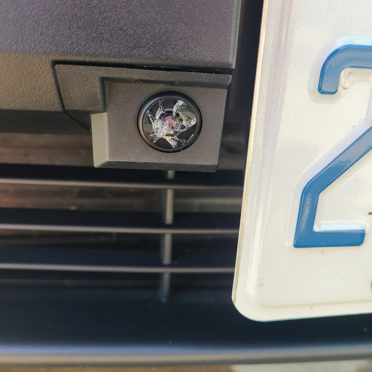

Front license plate camera glass getting worn from road stuff - any replacement or protection options?

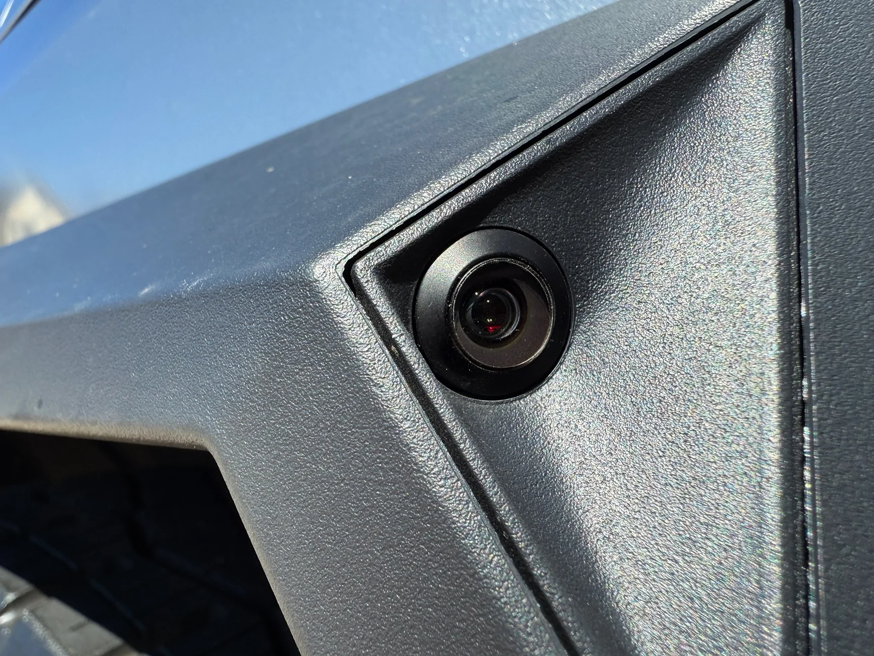

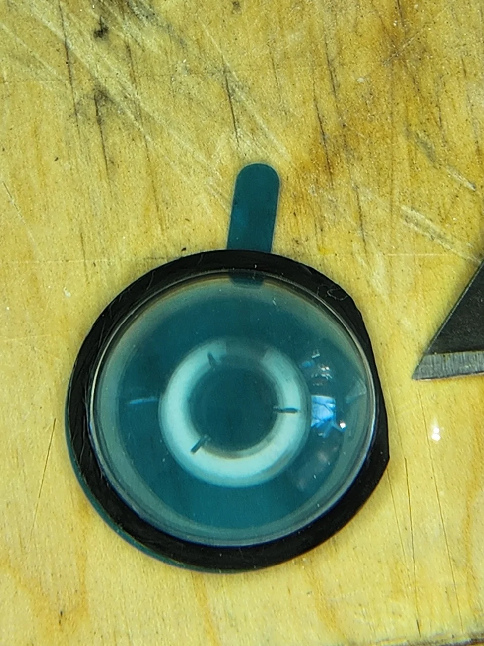

I used a vinyl plotter to cut out some 3m Pro PPF and applied them to the camera lenses. Optically clear and so far no chipping.
I applied them to all exposed camera lenses including the fender ones.

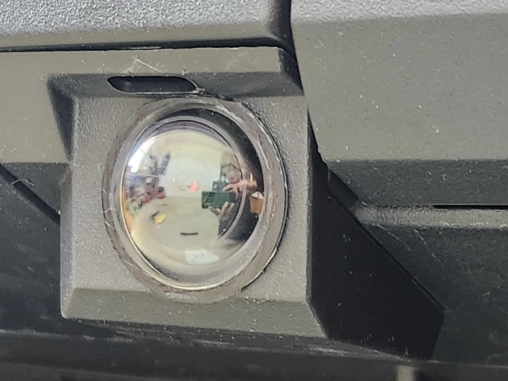

Update.. so my lens covers arrived today. I can confirm they fit - sort of, needed about 10 seconds of modification. I cut the top lip flat so it would sit more flush and not have an overhang on the bottom. There is still a tiny bit as you'll see in the pics but the adhesive is grabbing on the bottom and sealing it.
Here's the cut i made.
Tesla Cybertruck Front license plate camera glass getting worn from road stuff - any replacement or protection options? 20251203_130530
Installed.
Tesla Cybertruck Front license plate camera glass getting worn from road stuff - any replacement or protection options? 20251203_131912
