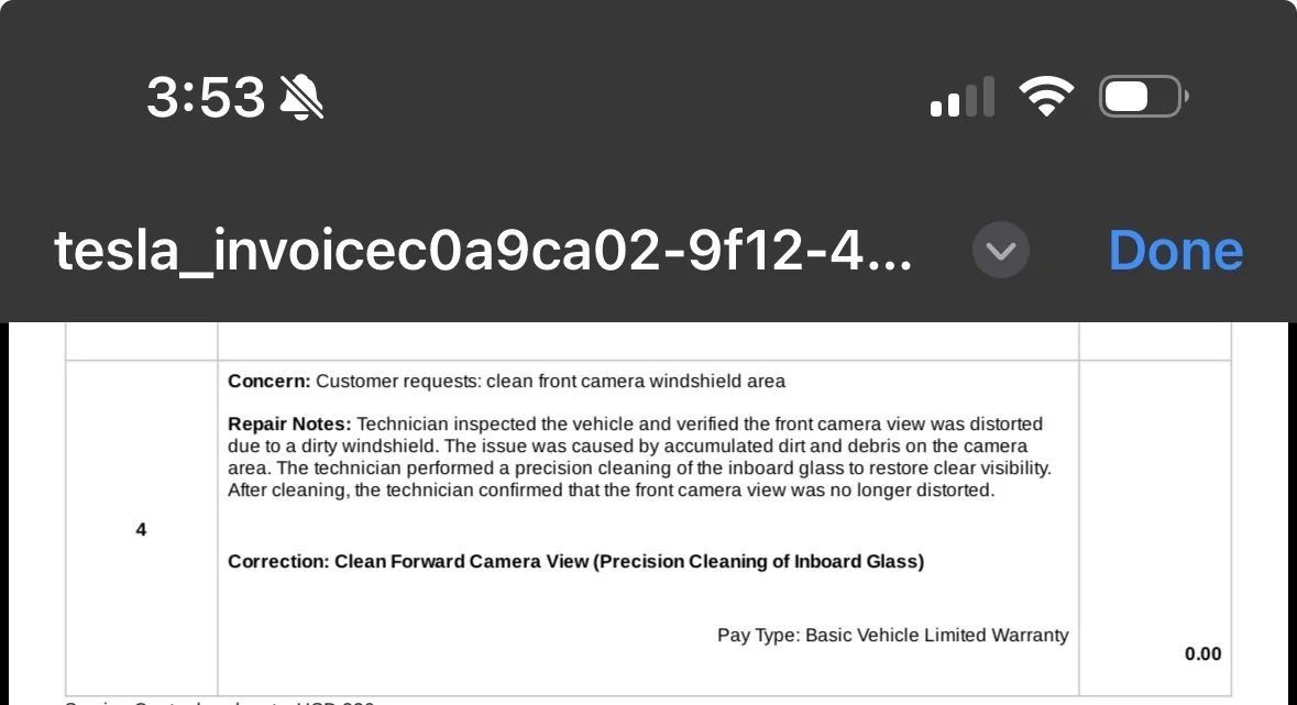

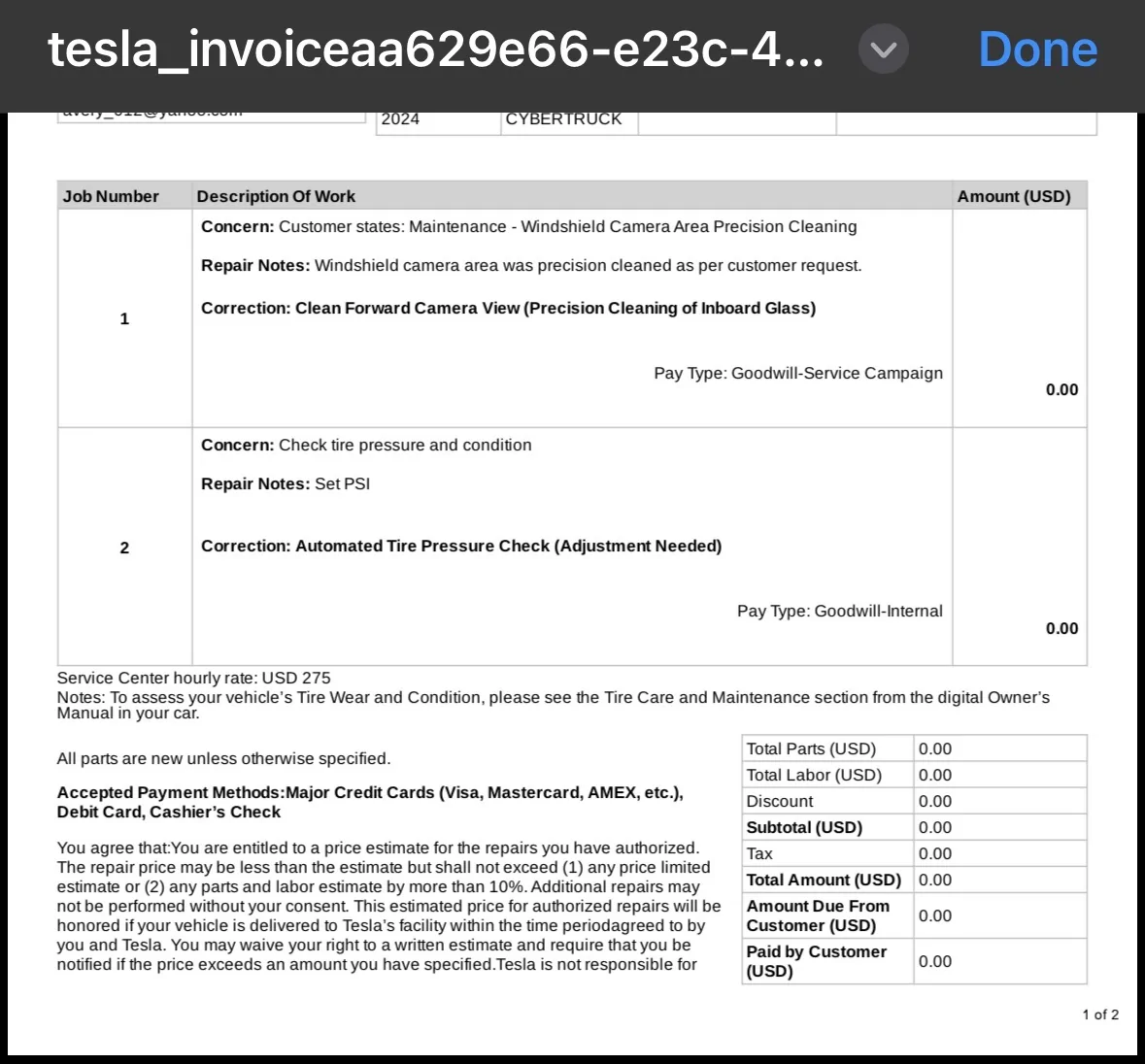

Tesla has cleaned mine twice for free. Are your service centers not doing this for free?
I believe the outcome depends on the individual who provided the quote when requesting service through the app. I received an estimate of $275 last month but requested again this week, there was no charge.
