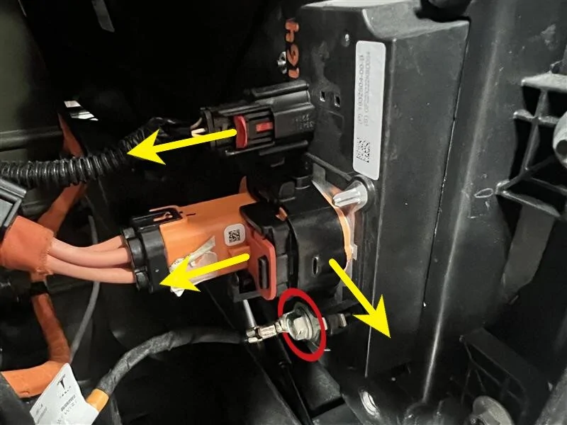

So what’s behind the panel with the 1x240v and 2x120v plugs in the bed? Is it possible to hardwire an extension cord there that does not require the door to remain open?
If that’s the case it’s just a matter of length and routing to make it come out in the frunk.
Wire harnesses :
Tesla Cybertruck Frunk 120v power outlet installation GUID-73E804D5-AB56-481B-BE84-5AB1F2BFD37A-online-en-US

Thank you @mongo. Somehow I knew you would know. I don’t see why you couldn’t hardwire in here with a three prong cable and run it under the sail panels and down to the behind the frunk space and put a plug there. You could then put a dummy plug cap into that bed plug or just fuse your plug in such a way as to ensure the sum of the two doesn’t exceed the limit on the plug (though even if it did; it’s electronically fused).
The only thing I see as problematic is how to deal with Tesla if you have any issues with the system.
