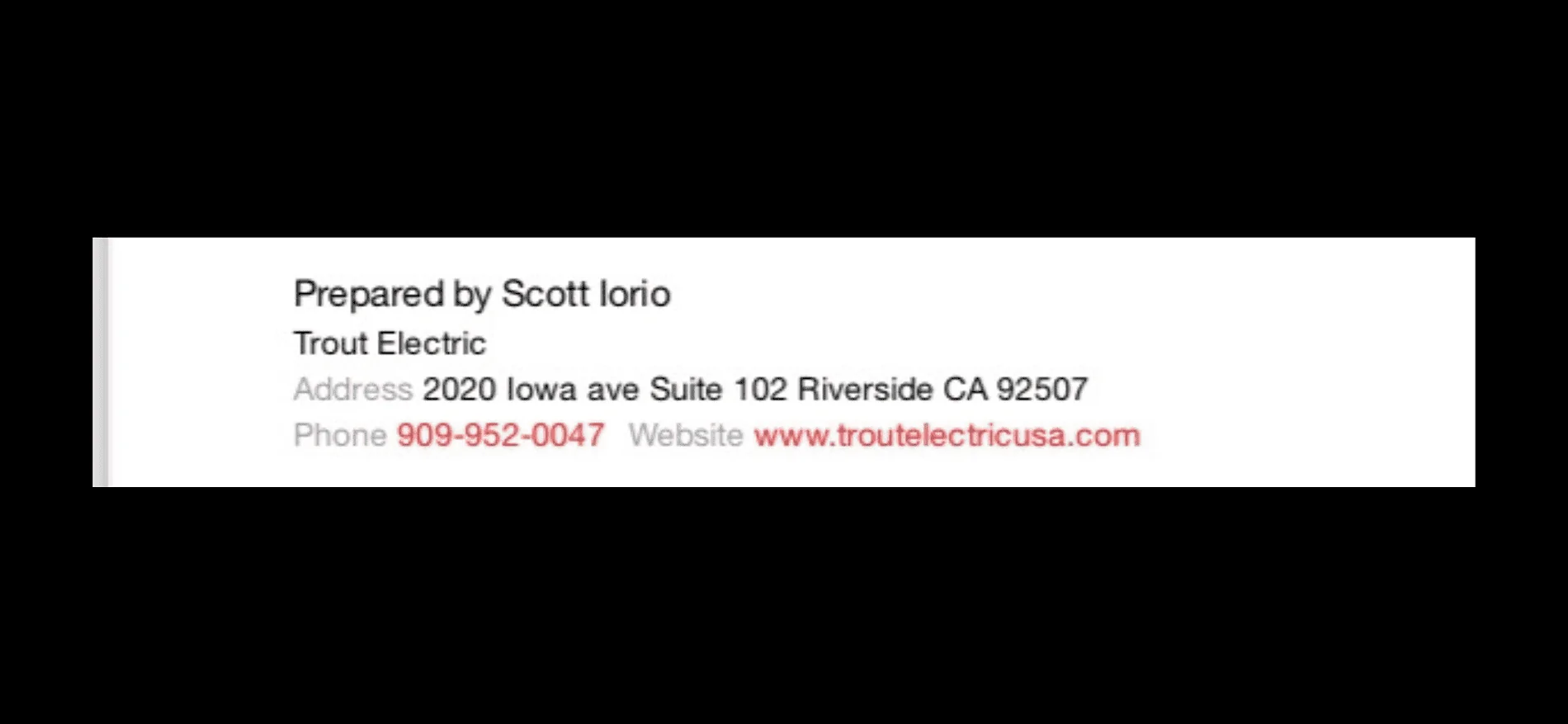

In Irvine CA, here’s the quote I just received. Don’t know where everyone is coming up with $4K-$6K. It’s less than $2K including permits. Maybe just want to be helpful?
Do you mind sharing the install company? I have had my truck since Jan and got an email from tesla that I qualify for powershare and someone will reach out once I am closer to getting my truck. Problem is I have my truck and nobody has reached out, plus nobody from Tesla has been helpful in resolving my issue. I think I may have fallen through the cracks since I got my CT so early. Anyway I think I might just reach out to these companies and find out if I'm on their list. Thanks!

Of course I wouldn’t mind. See attached. They have two locations Riverside and Corona. Tesla actually sent a follow up email stating Trout Electric will reach out to me before they did. Good luck! ??
Tesla Cybertruck Power Share Installation Update and disappointment IMG_3485
