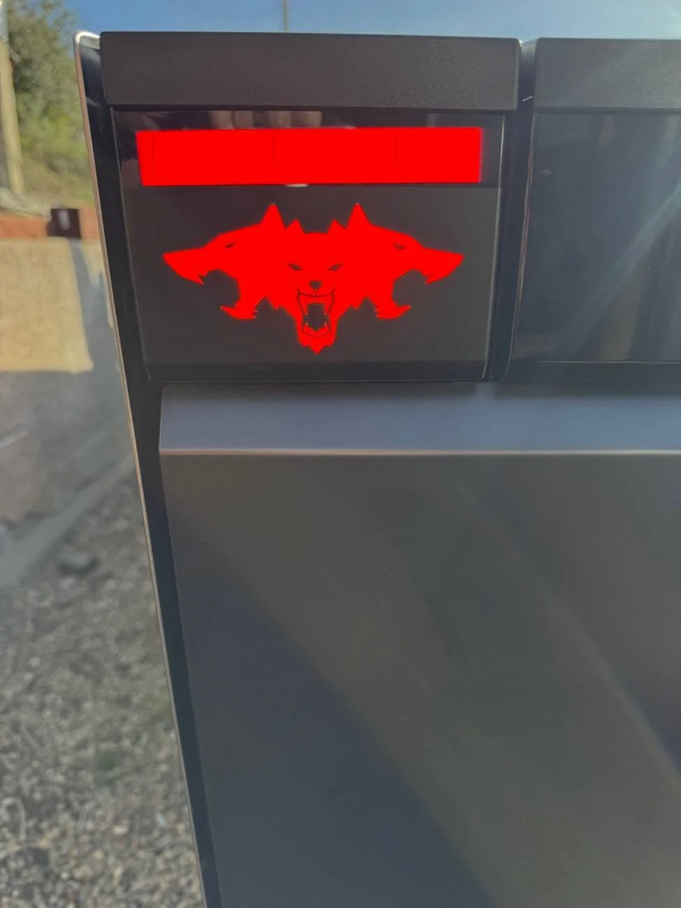

I’d buy a CyberBeast version of the Frunk Light. Better yet, a Cerberus (Three Headed Dog) Logo in Red for a Frunk Light. It would be reminiscent of popping the hood of our old Muscle Cars back in the day! “Let’s see what you got under the hood” ….. “Whoa… a Tri Motor CyberBeast!”

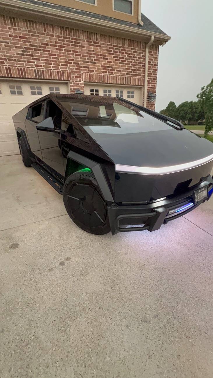

There are multiple automated adjustments etc. that activate when in towing mode. I do not have a Beast so can’t comment on that. I run all auxiliary lighting through auxiliary power found in the Frunk including Rock lights, under-glow, bumper off road lights with puddle. The advantage to a trailer hookup would be that they come on automatically with headlights, and turn signals. The thing missing from this product would be augmented reverse lighting / rear spot light feature.

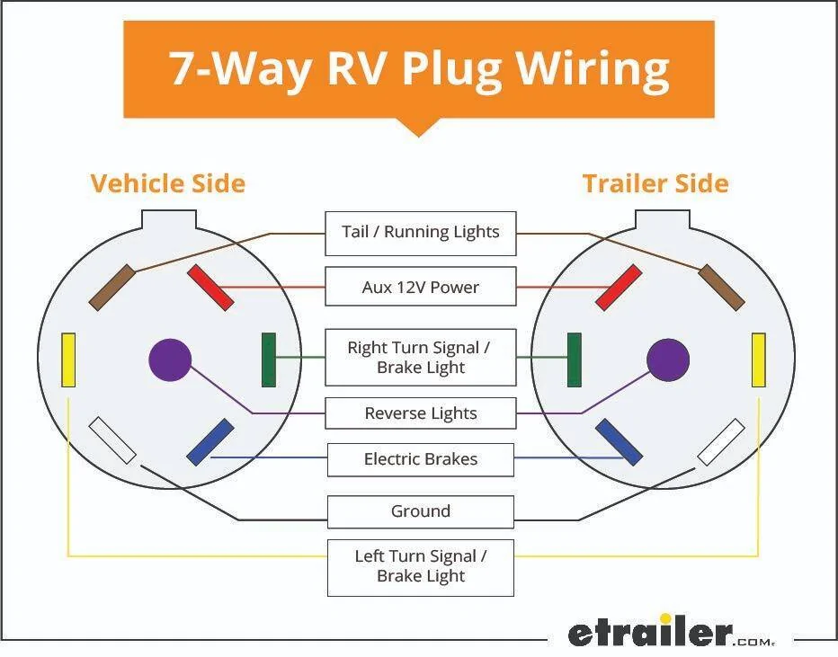

To everyone asking about the wiring. yes you can put a splitter on the 4 pin. yes it will always go into trailer mode. There are 2 trailer modes. one with lights only and one with an actual trailer. it defaults to the trailer (Blue Light) you can then exit trailer mode (light goes Yellow) that is for carrying platforms with lights. also works with tailgate lights. etc. instead if you use a 7 pin connector and cut down the center piece, throw away the outer housing. then your 4 pin is unobstructed, and you can hook up the other 3 wires, Reverse, 12v aux power, and e-brakes. Wouldn't touch the e-brakes but the other 2 work fine. Cutting down the inner piece and not using the housing defeats the only-one-door-open wiring cover.
