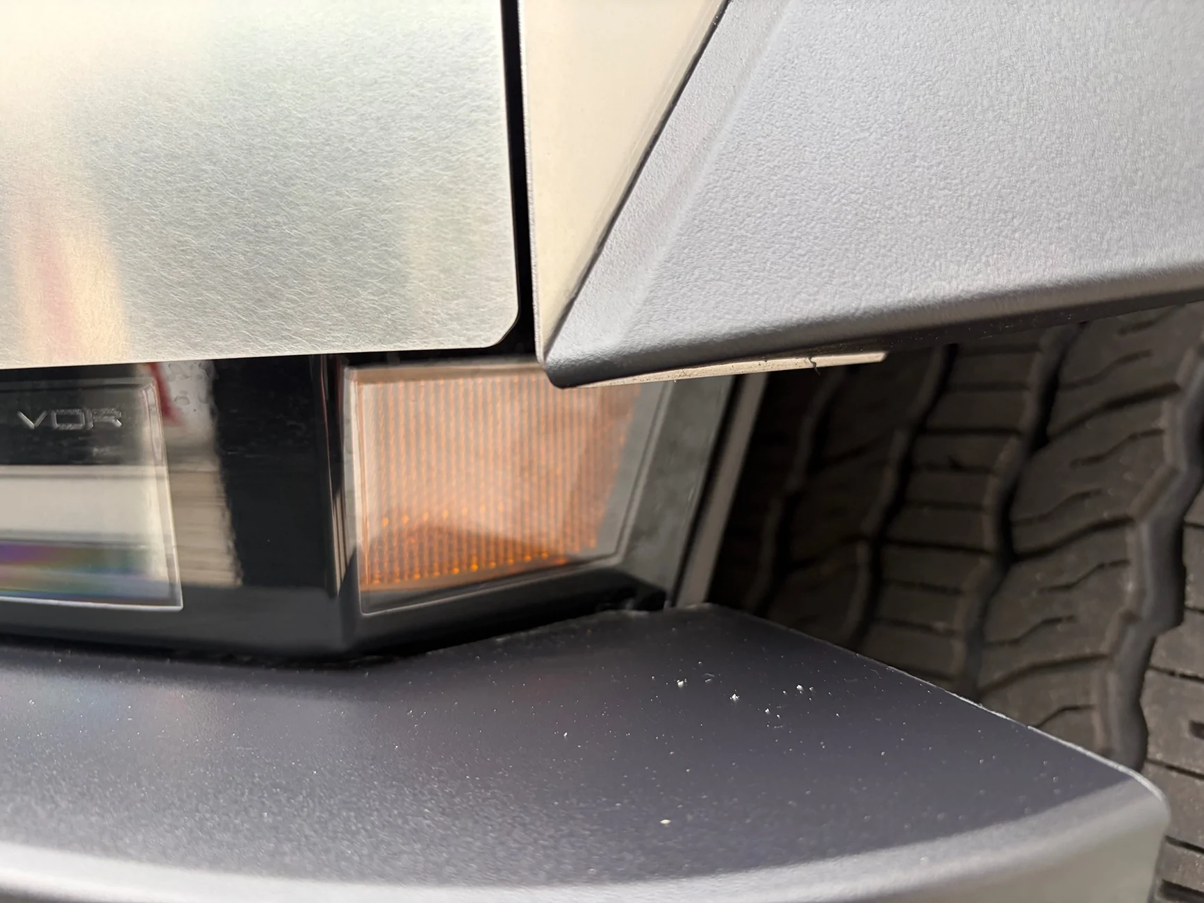

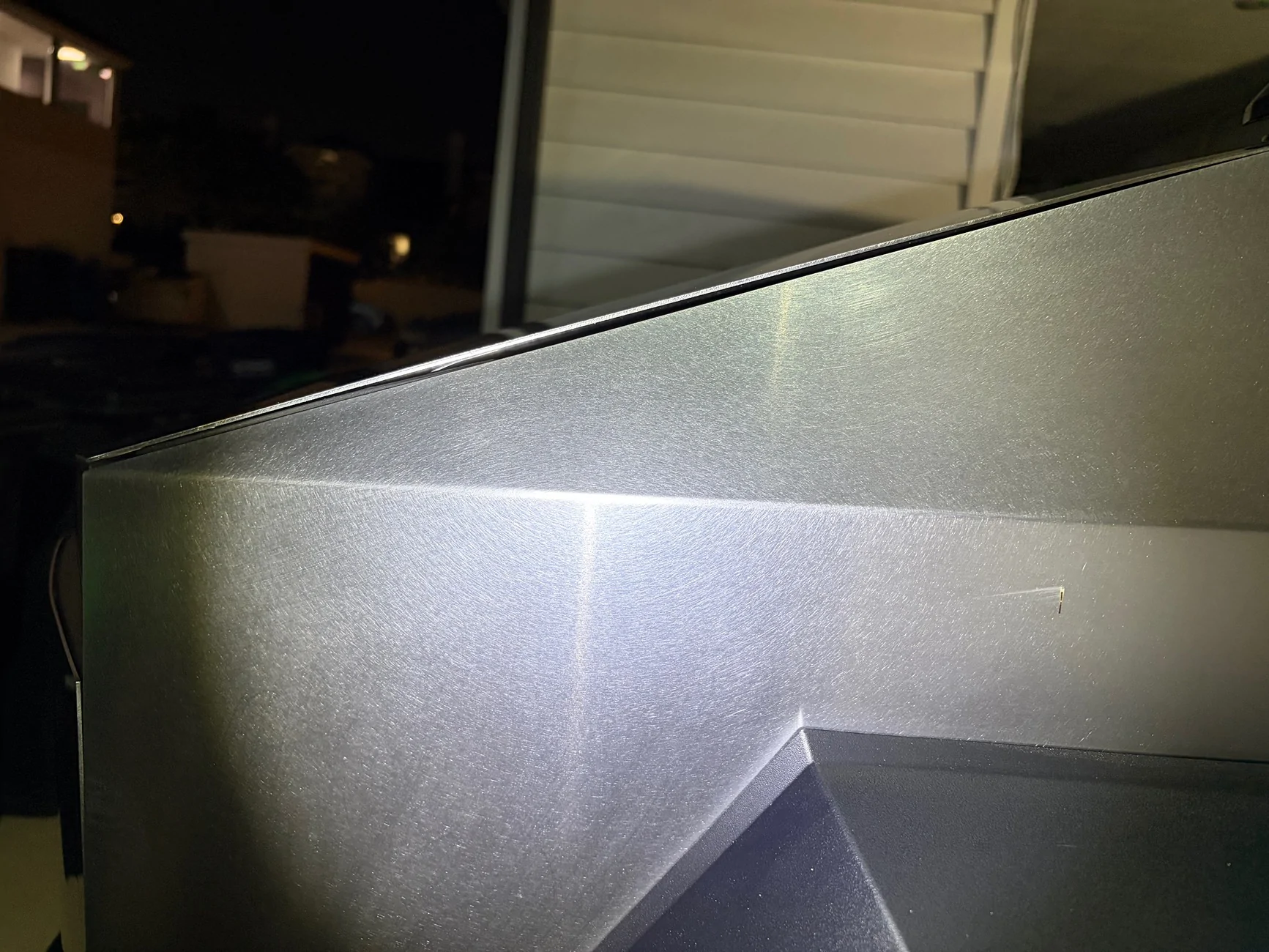

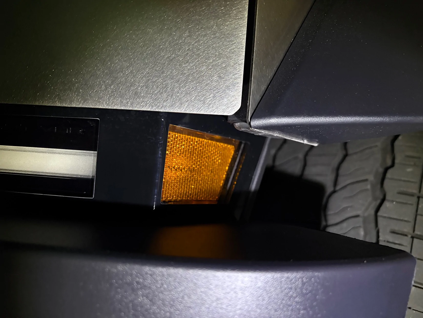

Tesla service replaced my frunk hood a couple of weeks ago and it was not set to the correct height on one side. One side was higher than the other. I have a service appointment Tuesday to align it correctly.

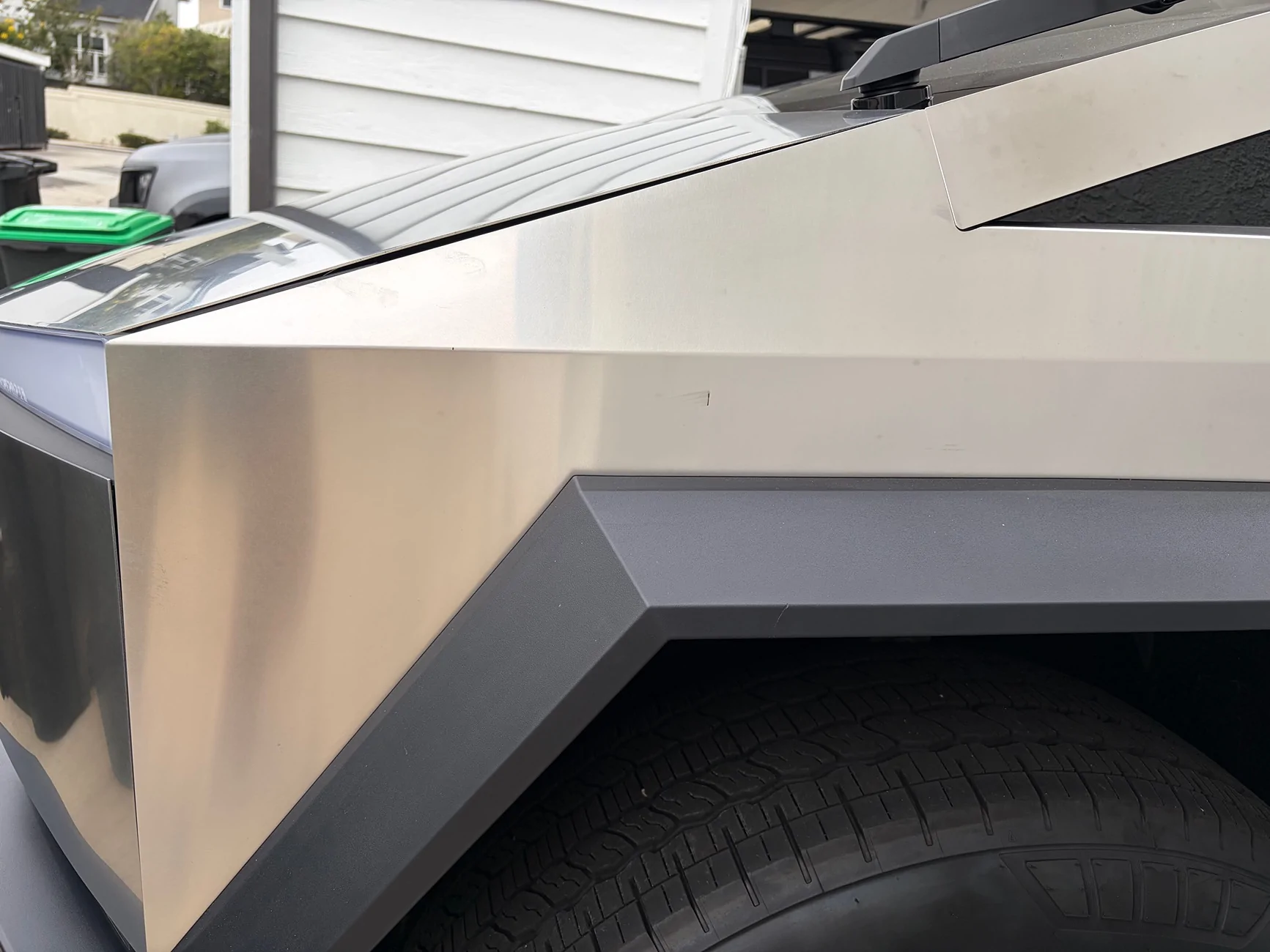

Also, keep in mind the front quarter panels are designed to ride slightly higher than the hood surface. This is really nice when beating through heavy brush because it uses the super tough edges of the front quarter panels to guide the branches up and over the windshield without leaving marks.
