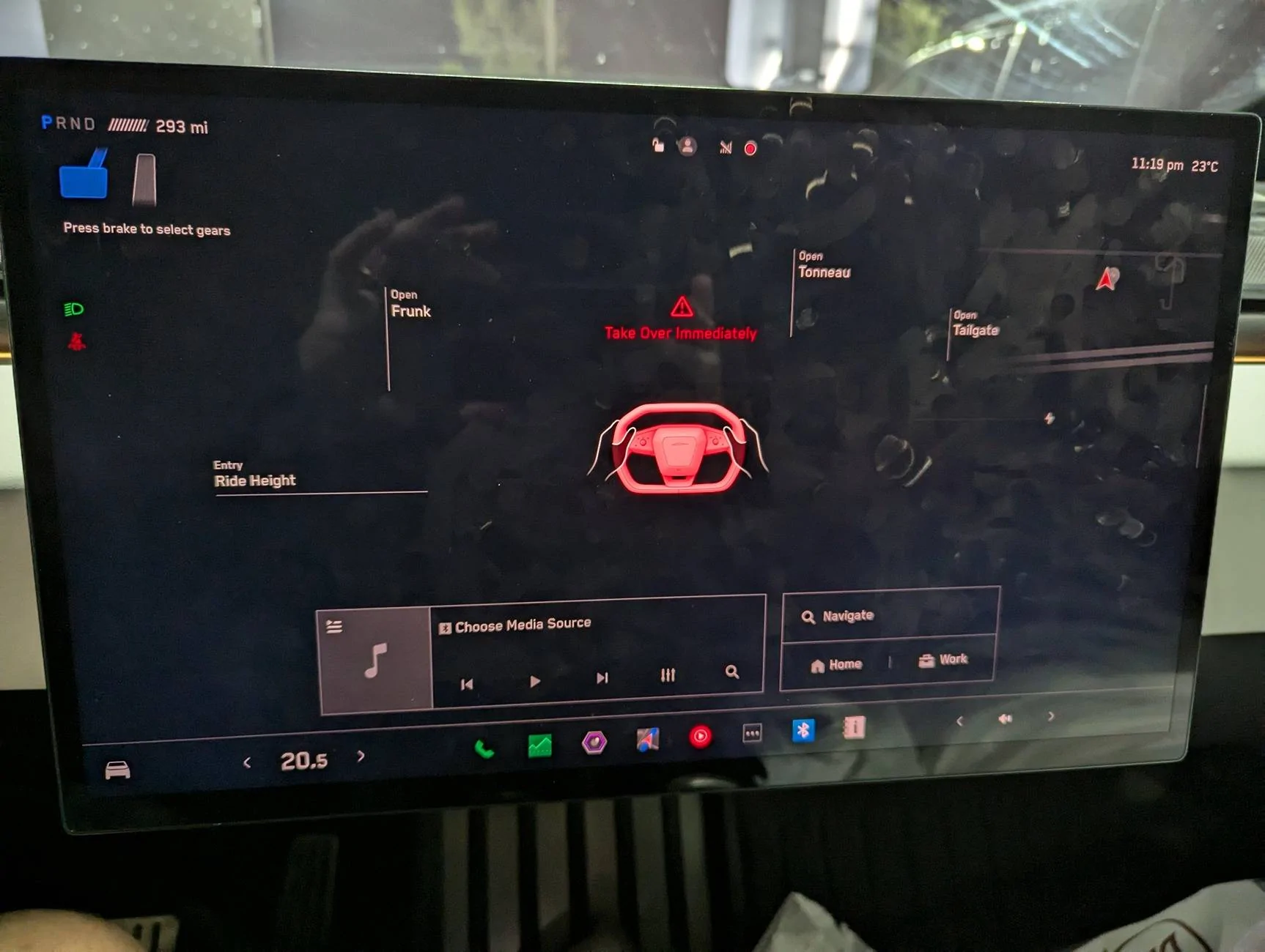

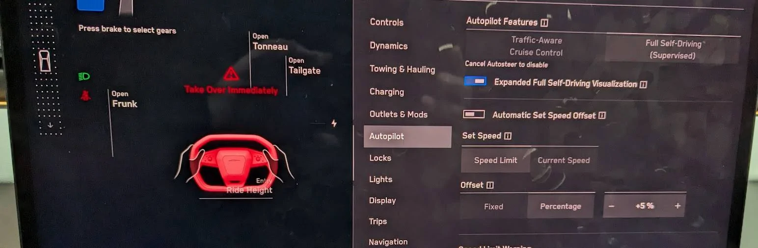

Just drove from TN to CO yesterday/today.
In the middle of KS last night the FSD system froze and gave us the take over immediately alert and was blaring nonstop even though we had control.
After I think the third reboot of the system it stopped making the noise... but kept showing the take over immediately image.
We then tried everything to get rid of the take over immediately image... a few more reboots, into and out of FSD a few times, parked the car, charged it, turned the car off for a few minutes,
nothing helped. While parked it wouldn't even let me get back into TACC as I had to cancel autosteer first!
Then today I was driving with FSD and saw a broom in the road I swerved (i.e. a disengagement by steering wheel instead of hitting the button) and it finally went away... about 400 miles after the issue started.
Tesla Cybertruck FSD attention alert siren won’t stop PXL_20241003_041958696
Tesla Cybertruck FSD attention alert siren won’t stop PXL_20241003_042040412

Hey, the same thing happened to me. Let me preface this by saying I had FSD engaged from phoenix to Anaheim, CA the entire time and it worked amazingly well! Less than a handful of interventions.
The following day I engaged FSD once again from Disney down to Irvine spectrum and once we got to the parking lot I wanted to see what would happen if I just left autopilot once the navigation ended. In the parking lot is where this happened to me. I was really freaked out because I needed to drive back to Phoenix the next morning. The alarm was stuck on, the screen looked just like the screen in these photos. I called tesla support and we power cycled and we reset the display. To reset the display go to display and change the language to Español and then change the language back to English. Although this didn't fix my problem it's nice to know about.
After departing Irvine spectrum we were en route to Carlsbad (screen still stuck). This is when I was thinking of ways to fix the issue and noticed that it blind spot sensors were also affected. I thought we'll hell let's see what happens if I try to engage autopilot again while it's fd up. And BOOM! It successfully engaged! I was shocked! A few moments later the screen went back to normal and all the sensors were back online! It was not immediate.
Give it a shot...
