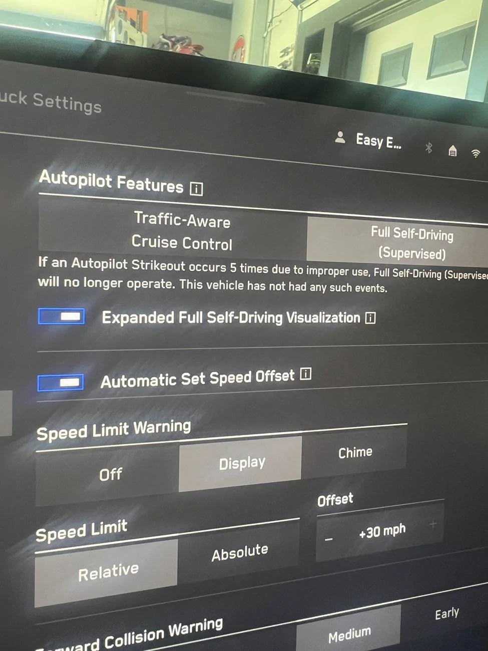

In the autopilot section of the settings menu, make sure to enable the enhanced display. I'll try to remember to take a picture of it later.
I do see the Expanded full self driving visualization but it doesn’t seem to change it or bring back what we used to have.

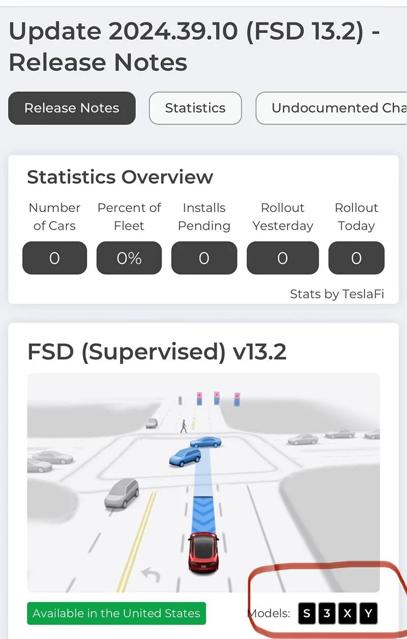

I am sure it sees things but why did they remove it from the screen and why does my Cybertruck ignore the merging cones that it used to display and doesn't anymore is my concern.

The visualization is run by a simpler (earlier) stack than the self-driving, they run in tandem but don't interact in the car as far as I know.
10,361
34,393
Tesla's FSD team has talked about implementing the "Occupancy Network", which is basically a translation of the visual input into a 3D grid representation of occupied space. Once an area is deemed "occupied" there's no point in wasting more CPU cycles to determine what it is, so they're not really doing object-detection any more.
Of greater interest are things that can move, like vehicles and pedestrians. Those must be closely tracked to project if they will intersect with the intended direction of travel.
But for immovable objects, it doesn't matter if it's a cone, or barrel, or trash can. The computer just needs to know that the space is occupied, and thus be avoided.

The problem is that it hurts user confidence in the system. We want to know the vehicle “sees” what we see in a supervised system. I suspect the real reason is that rendering graphics is consumes more compute that they need for something else. They may need to optimize the SW a bit to bring it back.

The visualization does show that something is there, but only minimally. ?‍♂
