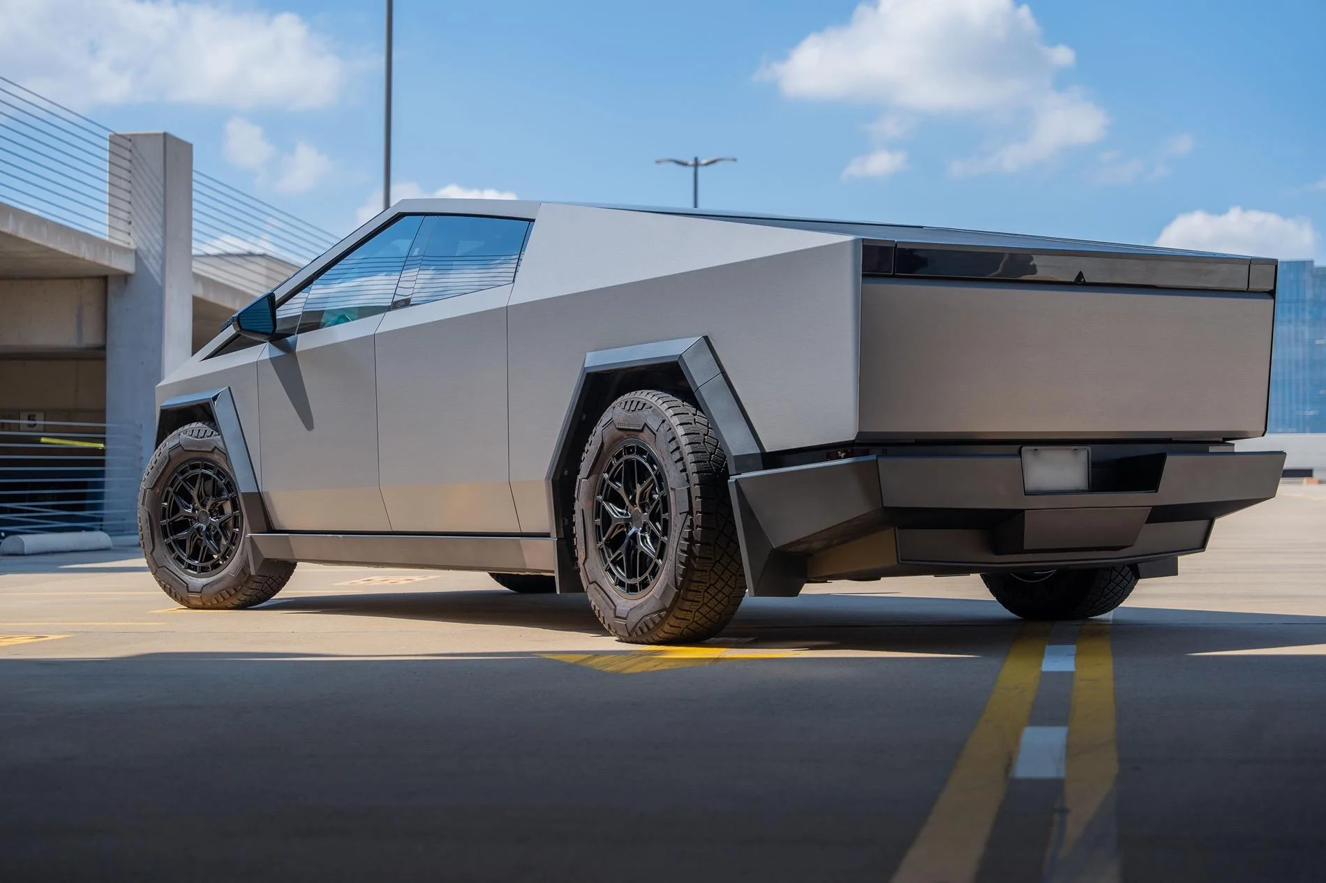

Thanks to @getsometom for reviewing our [AW09] rims for the CT.

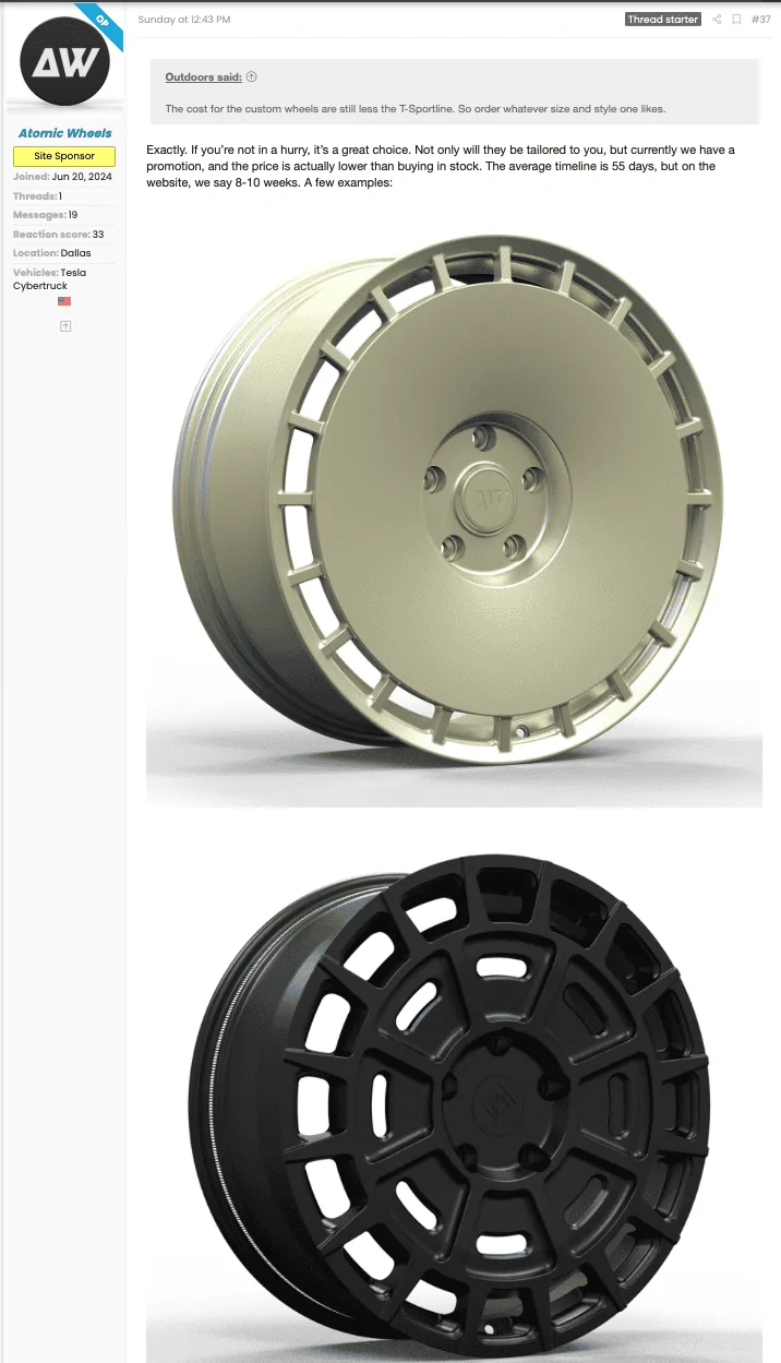

The cost for the custom wheels are still less the T-Sportline. So order whatever size and style one likes.
Exactly. If you’re not in a hurry, it’s a great choice. Not only will they be tailored to you, but currently we have a promotion, and the price is actually lower than buying in stock. The average timeline is 55 days, but on the website, we say 8-10 weeks. A few examples:

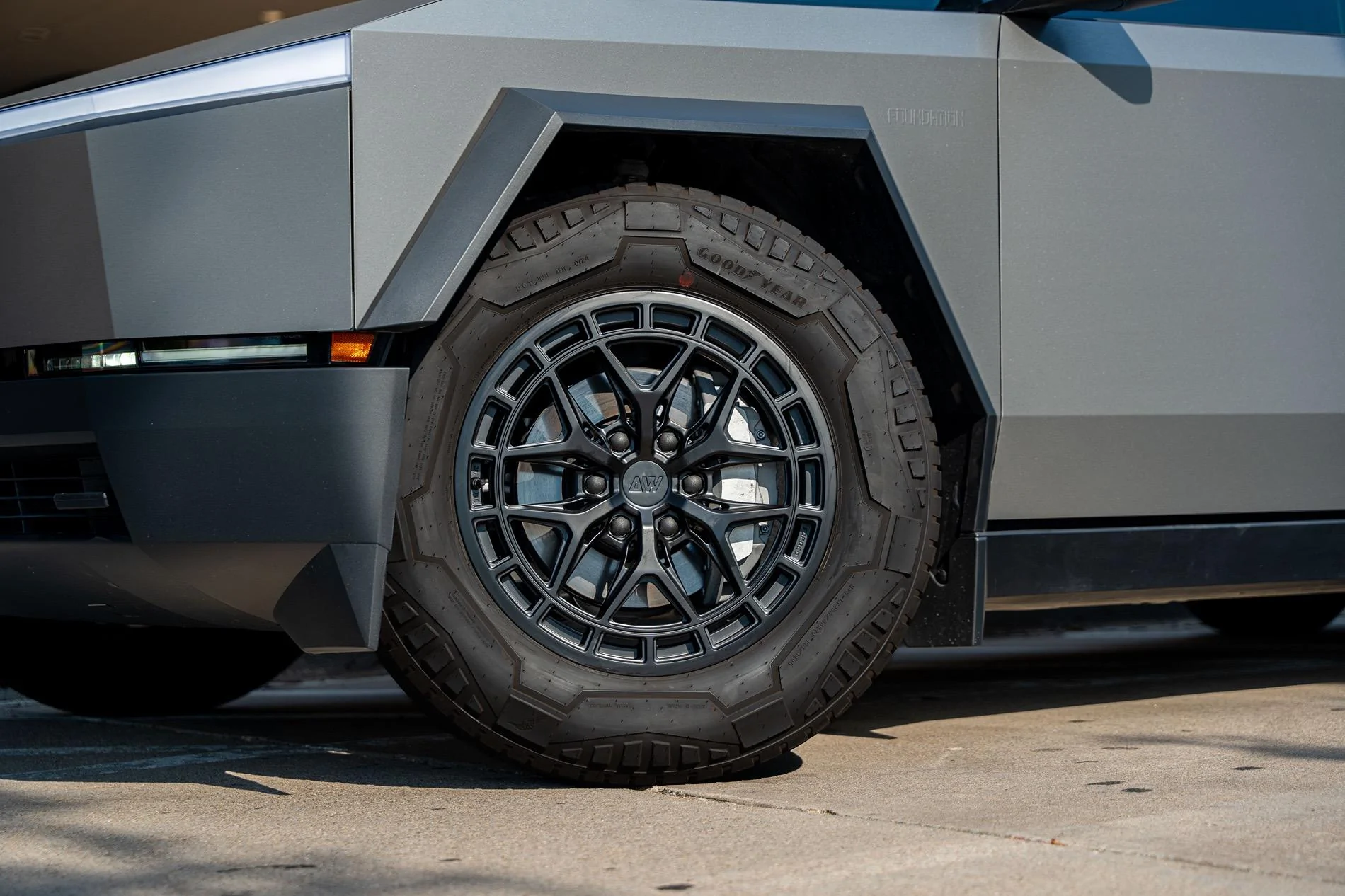

Why not match the CT center bore? Obviously these must be lug centric, but seems odd if you're custom making them to fit the CT.
...Because they didn't know the centerbore of the CT to begin with! "Experimenting and picking random centerbores" ?‍♂ Lugcentric is a NO NO. Even more dangerous on a truck with a gross vehicle weight rating of 9,169lbs! Inevitable for a stud to snap.
Tesla Cybertruck Fully Forged Atomic Wheels for Tesla Cybetruck img_0447-
PSA: Another company manufacturing in China with little to no knowledge about wheel engineering.

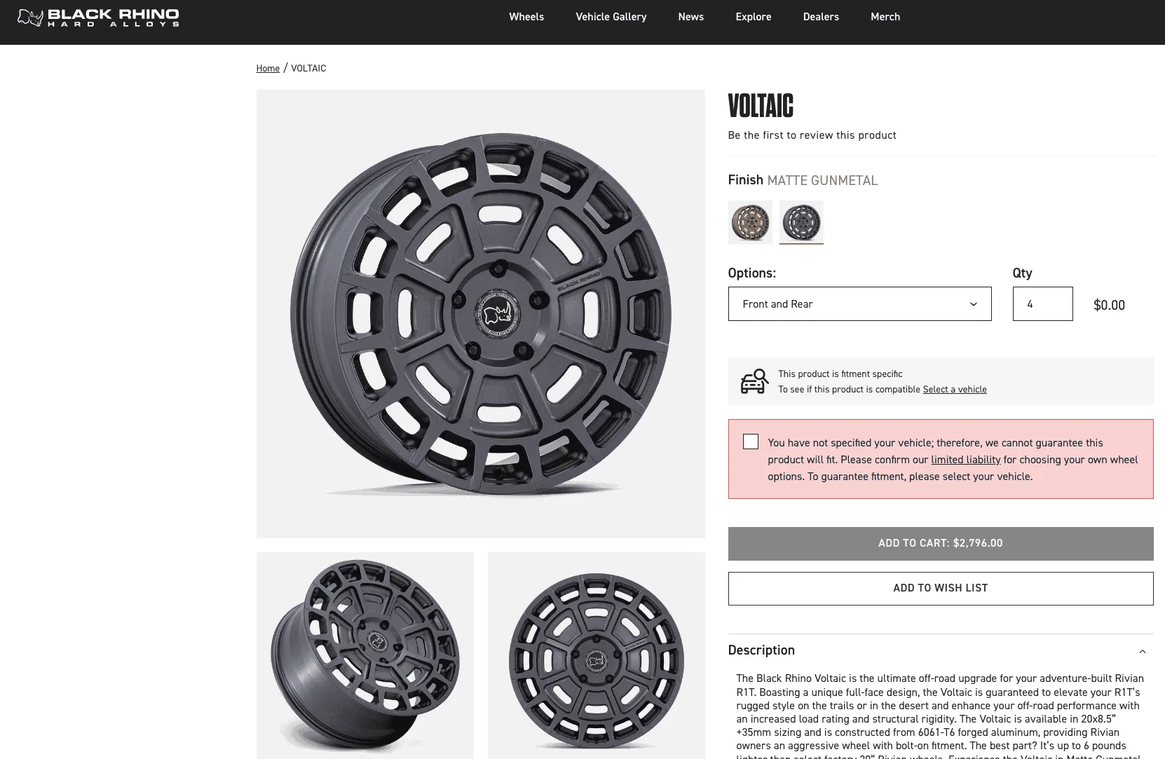

What is this? A dead copy of a Black Rhino Voltaic Wheel? Shame on you @Atomic Wheels
Tesla Cybertruck Fully Forged Atomic Wheels for Tesla Cybetruck PNG imag
Tesla Cybertruck Fully Forged Atomic Wheels for Tesla Cybetruck Screenshot 2024-07-02 at 11.39.54 AM
Black Rhino manufactures in China too, but at least their spec is dead on for the vehicle application.
@DeadSetElectric You're 100% right. Their stated load rating is underrated for a CT. Forged or not. Even the factory 20" wheels have a higher load rating. Load should never be overlooked, especially with a truck this heavy.

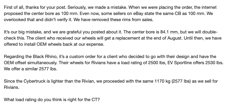

First of all, thanks for your post. Seriously, we made a mistake. When we were placing the order, the internet proposed the center bore as 100 mm. Even now, some sellers on eBay state the same CB as 100 mm. We overlooked that and didn’t verify it. We have removed these rims from sales.
It’s our big mistake, and we are grateful you posted about it. The center bore is 84.1 mm, but we will double-check this. The client who received our wheels will get a replacement at the end of August. Until then, we have offered to install OEM wheels back at our expense.
Regarding the Black Rhino, it’s a custom order for a client who decided to go with their design and have the OEM offset simultaneously. Their wheels for Rivians have a load rating of 2500 lbs, EV Sportline offers 2530 lbs. We offer a similar 2577 lbs.
Since the Cybertruck is lighter than the Rivian, we proceeded with the same 1170 kg (2577 lbs) as we sell for Rivians.
What load rating do you think is right for the CT?
