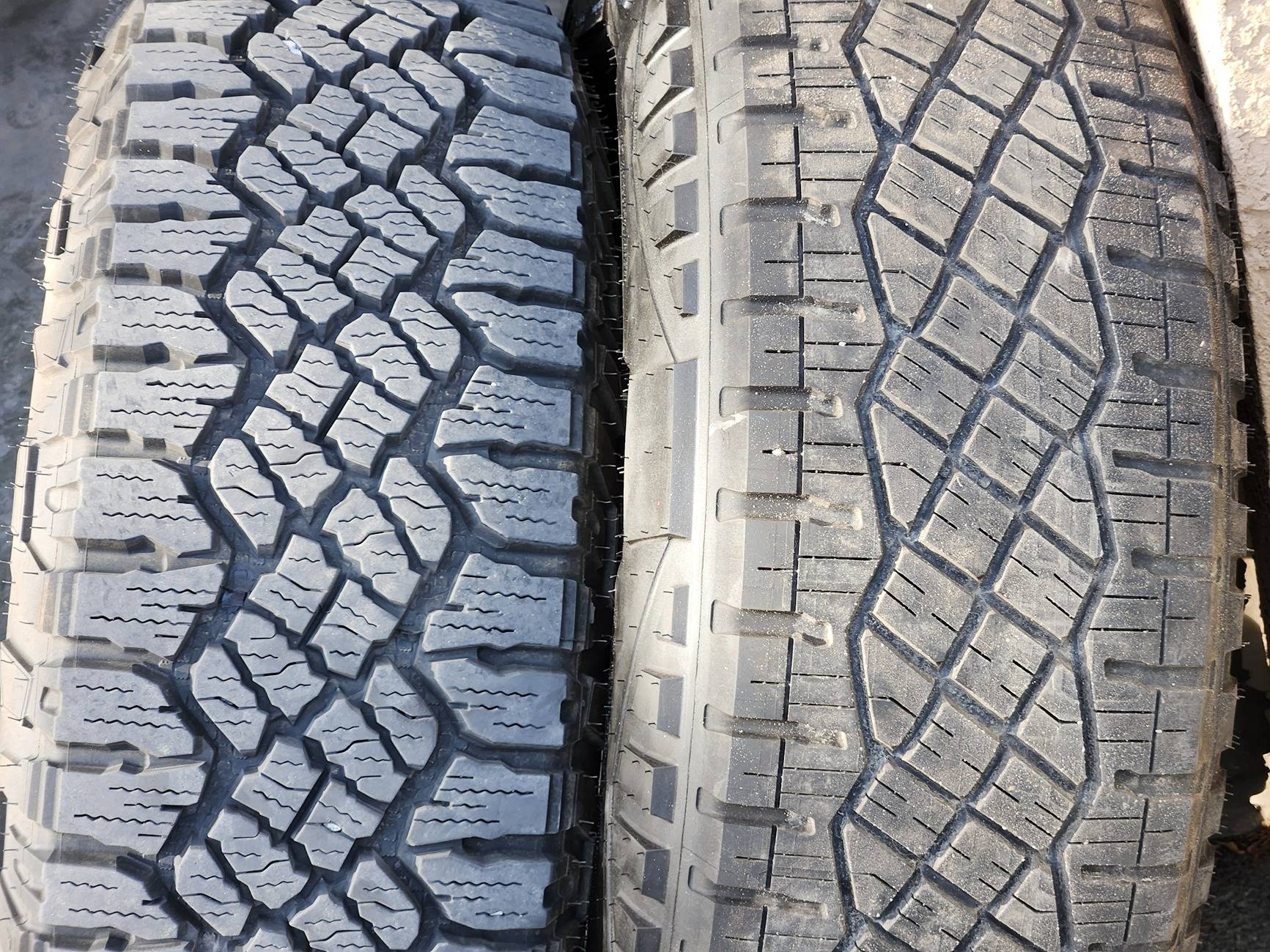

When I talk about siping, and in particular, the siping on a winter tire, I'm referring to the wiggly sipes on the Duratrac (left side of photo). The typical straight sipes for rain never seem to be evident on a true winter tire. Interesting to note the difference in tread shape too. I agree that there probably isn't a true winter ice radial available for this size and vehicle application, but the tread design on the left is certainly more typical of what you'd see on a true winter tire... at least in my experience.
I'm happy enough with them as a winter tire. They could be better, of course, but I'm not complaining! And I agree with your thoughts on why Tesla didn't make them the OEM tire. I mentioned in another thread how much of an efficiency improvement I saw after switching to the ATs - it's significant! The best I managed with the Duratracs was around 450 Wh/mi. After swapping over to the ATs, that dropped to around 375 Wh/mi.... similar temperatures and driving conditions/speeds. Not an insignificant improvement!
And the performance on asphalt is also much improved. Quieter, smoother and just firmer. I hate taking up space in my garage with a second set of wheels and tires, but it's my reality... :LOL:
