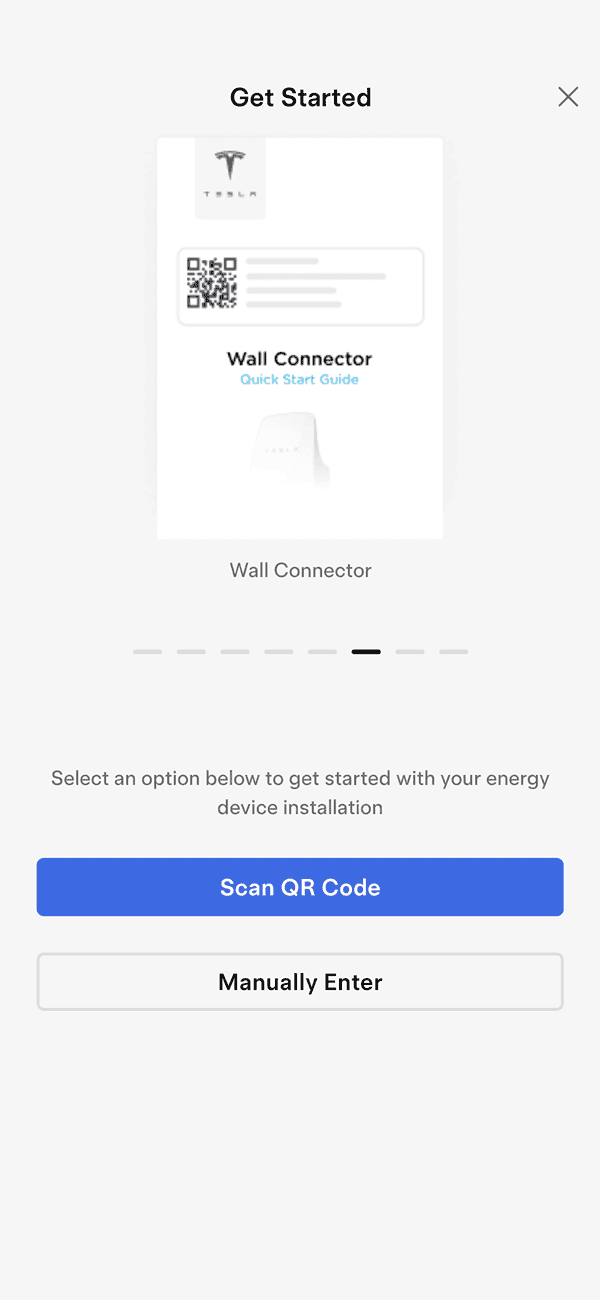

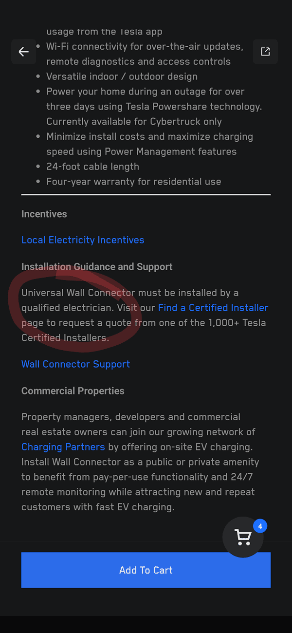

So you were able to log into the Tesla One app to configure it? How did you get an authorized account?
FWIW: I've installed/provisioned two Gen 3 (one Wall Connector, one Universal Wall Connector) myself without issue. They are connected to wi-fi and show up in the app.
You can log into the Tesla One app with your Tesla credentials. Just pick "Outside Partner" after launch.
