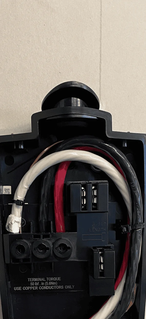

I installed both of my Gen 3 Wall Connectors. It is not crazy. My advice is to run a 3 wire with a ground. This will allow you to convert it to something like a NEMA 14-50 in the future if your needs/desires change. You can simply tape or cap off the extra (white) wire on both ends.
I ran some 3 x #4 with 1 x #8 ground. That is more than you need me for the Tesla Wall Connector but gives you room for other options later. I will say it is thick and difficult to work with. You will use some four letter words while working with it.

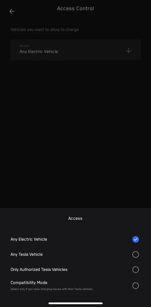

You don’t need anything special to configure it. You connect to the Wall Connector wifi and then you connect it to your wifi. You can then add it to the Tesla app as well. You can then do things like control what kind of vehicles can change at it.
