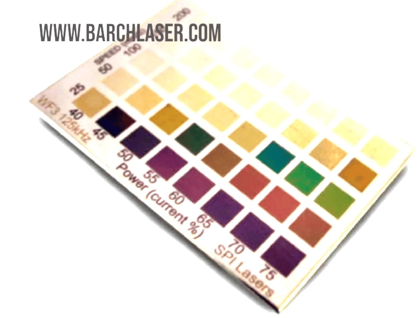

Granted it would be a royal pain to do much more than pinstripes, but a mopa laser can do color on stainless steel and it doesn't affect overall strength. As someone mentioned its more of an oxidation layer on top vs trying to color the whole panel through and through
Tesla Cybertruck High teat treatment to achieve exterior color? mopa color laser
