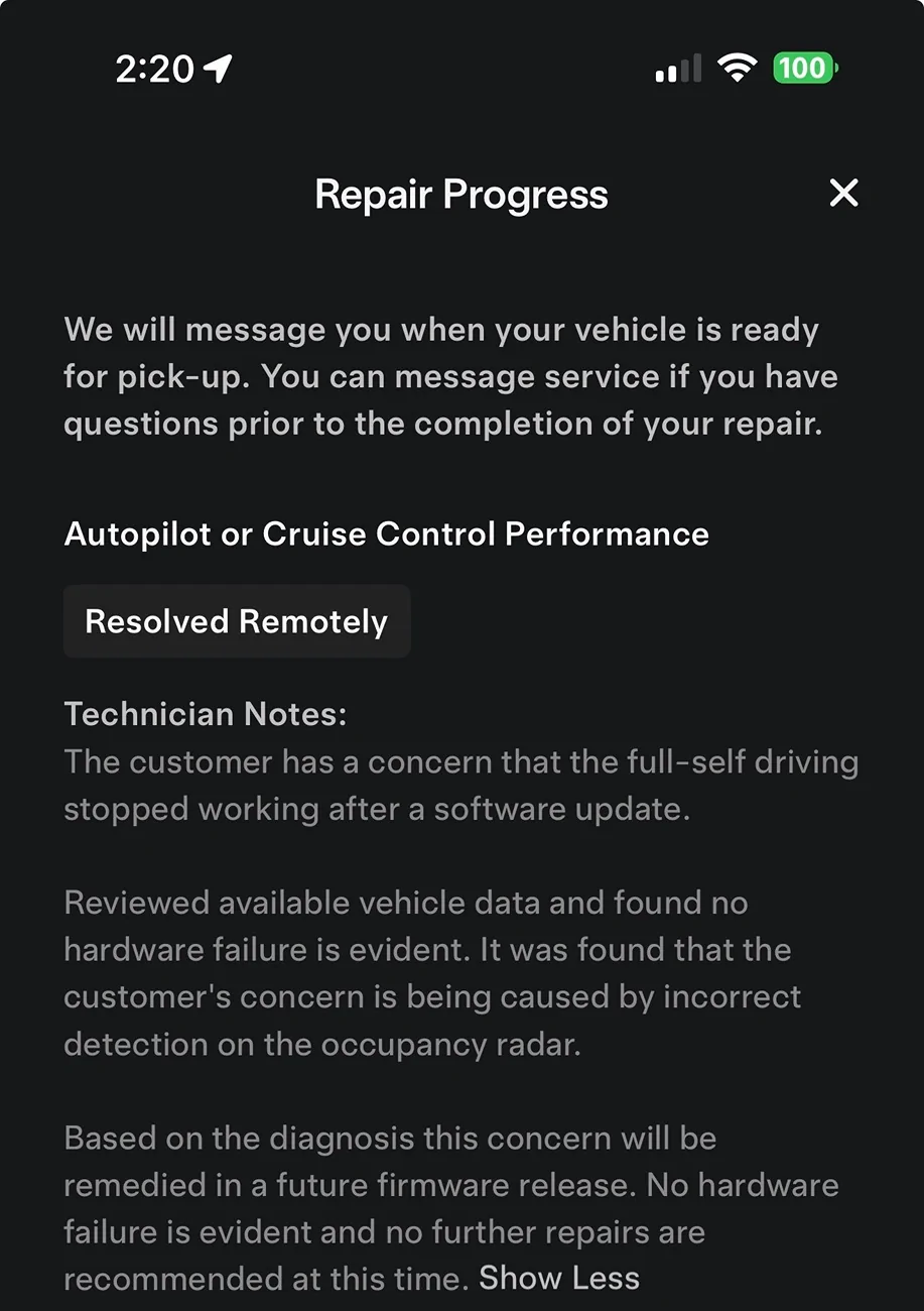

I wonder if this has something to do with it? I have a bumper light bar installed which plugs into the right front speaker harness. It caused a small error message shown here
https://www.cybertruckownersclub.co...umper-light-bar-installed.37114/post-30589801
It has not caused any functionality issues and I’ve ignored it for months with everything working perfect. But I wonder if everyone that has had issues with this last update has some modifications to the truck?
I got the service center to push the update to the car again since reinstalling from the service menu did nothing. Before trying to install I’m going to unplug the spliced connectors and get the truck back to stock to see if that is somehow interfering with the update. Of note, I’ve had the light bar Installed for many months and through many previous updates with no issues before. Perhaps this one updated a module that has not been updated before so now my spliced connector is causing the issue.
I can confirm that removing the front light bar harness from my truck fixed the issue, the seat detection now works and FSD now works. Why something changed with this update and how seat detection was implemented I do not know.
I did leave the Hansshow mirror harness in place for the time being and it is not affecting the seat sensor or FSD.

Ok I can confirm that at least some accessories that plug into the passenger side wiring harness prevent FSD from working properly after this latest update. It appears as though they interfere with the driver occupancy detection.
current solution is to remove the intermediate harness.

giusep
Giusep
Nov 20, 2024
SoCal
24 Cybertruck
Truck in today No fix and the just wait for update
Tesla Cybertruck Holiday software killed FSD! IMG_0179

Also confirmed removing the wiring harness for the bumper light bar resolved the issue with not having FSD after the holiday update.
