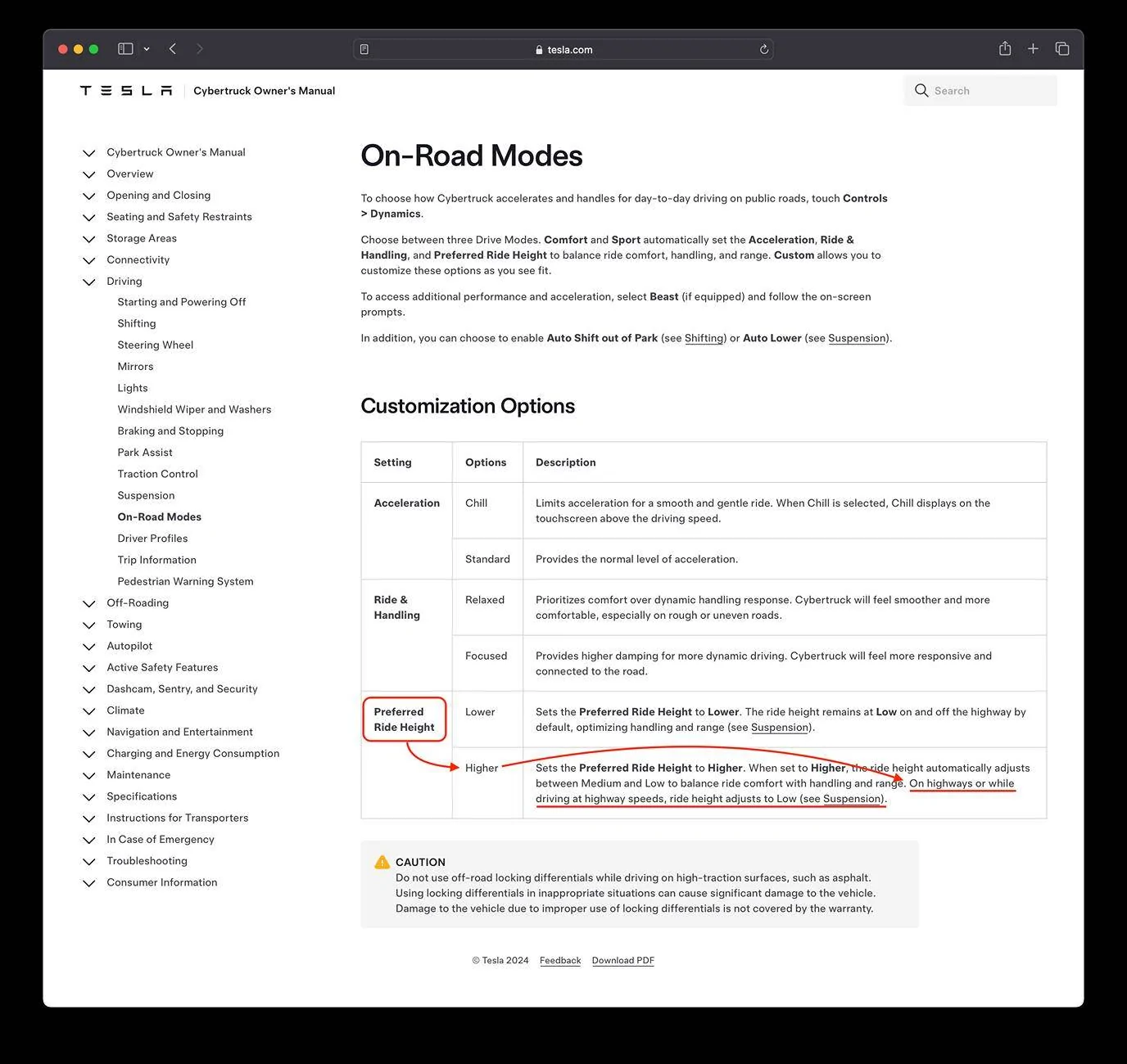

The default is always back to medium on freeway, how to bypass it to keep it in Low?

Try the custom dynamic setting.. Lets you choose lower or higher

The more 'sporty' the mode the lower it should go. Whatever your performance mode is should be driving in low. Also if you set everything to performance and low in custom it should be driving low.
With the cyberbeast in beast mode it is always driving in low.
10,319
20,736
The lowest driving mode has about 8.4"-8.5" of ground clearance. That is also the "normal" driving mode at all speeds. The only lower mode is "Easy Entry" which is handy for loading heavy items or people with limited mobility, but it is too low for driving comfortably (or safely) so the truck raises back up to around 8.5" as soon as you put it into drive.
If you want to drive in a higher mode, you can select that in driving dynamics (select Prefer Higher). It won't corner as well (there is more body roll) but it's handy if you think you might need the additional clearance.
It will go considerably higher than that if you put it in Off-Road Mode (where you will have multiple higher modes available) but the highest modes are limited by speed.

I take it u have read the owners manual? And don't understand it??
