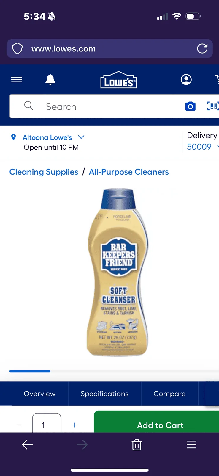

Barkeepers Friend and Windex. Very, very easy to remove.
Tesla told me not to use barkeepers. I did try and it works but leaves a shinier appearance than the rest of the car. Didn’t want to ruin anything.
It can stain the plastics. So be careful.
And yeah, that's how stainless cleans; it makes it shinier when you clean off the patina. If something is embedded into the patina, that's how you get it off.
But the thing about stainless is... You can always get back to that clean level.
You can't always get back to it with standard paint.
