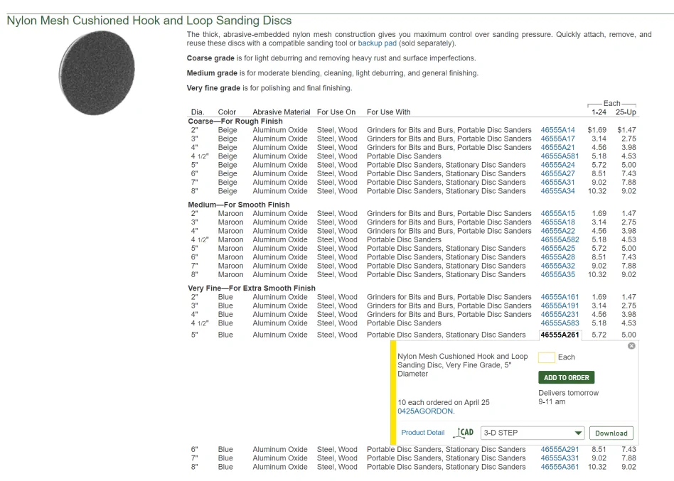

Alright, for anyone who was following along with what I was saying earlier... I did some experimenting.
The 12v battery powered buffer mentioned in that video early in the thread works very well in combo with the soft buffing disk and spray BKF. it takes off discoloration that would normally be very difficult to scrub off manually. It also allows you to effectively clean much more area at a time within the 60 second time that you have to start removing the BKF in.
As far as panel refinishing... The maroon scotchbrite on that buffer perfectly matches the factory finish, and may even be a hair less coarse. I had a whole door from the factory that was not the correct sheen vs the door next to it, and this process completely solved it in a way that nobody would ever know the process was done. In the video the guy says to press very lightly, this was not my experience. Pressing very lightly puts swirl marks in because the oscillation isn't happening correctly. I had to press pretty firmly (and as I increased the speed, had to press harder). You do not need the blue scotchbrite as I had theorized (and the blue stuff used in the video does nothing, because it's a non scratch pad).
The maroon pad can achieve an even better sheen than from factory (depending on how they finished yours, mine has 3 or 4 different levels of sheen on various panels) if you make enough passes. In some cases it's possible to not have to refinish a whole panel, but those would be case by case, and you can't take very many passes if you do that.
If you attempt this process, you are going to be tempted to finish a small portion to get the process down, and then go further along the panel as you get what you are looking for. Do not do this. It will make your job much harder. You want to touch every piece of each panel the same amount. If you do what I did here for my test, and then try to apply it to the whole panel, it becomes more difficult to blend what you did as a test with the finish on the whole panel.
You can see below what I was talking about with the weird mismatched finish on my doors. Left of the door seam is OEM finish on the rear door. Right of the white line is OEM finish on the front door. Between the door seam and the white line is where I used the red scotchbrite pad on the battery powered buffer, and it is a very good match for the rear door now.
Tesla Cybertruck Need Help! How do you get rid of water spots? 1714225813348-sq
Seeing how easy this is, I'm probably gonna just do the whole truck myself. I don't really care if the panels are shiny or not shiny, but I want them all to match, and they simply do not match from the factory.
The parts I listed from mcmaster are completely the wrong kind of thing, and I'm gonna remove it from my previous post. The grits may be right, but the pad isn't soft enough to conform to the truck.
