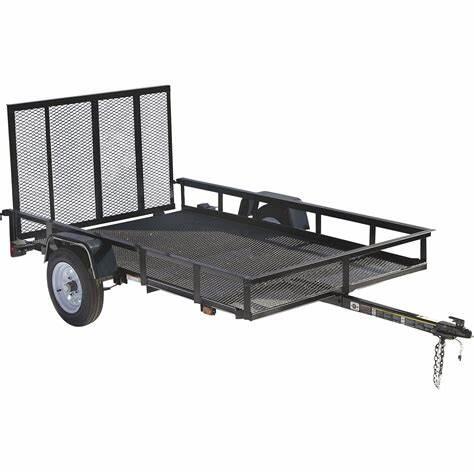

I'll be next to a curb, and I can go into service mode and completely deflate the suspension (or is that a bad idea?). I'll look into which one would be easier, but I prefer loading into the bed because my trailer doesn't have any good tie down points (and idek if it'll be able to hold it lmfao).
This is what it looks like, will grab an actual photo once I'm home.

Sorry, just saw this. Excellent trailer. I’ve used ratchet straps on these all the time. Does it not have D-rings or loops? Otherwise loop the ratchet straps around the bars?

It does, my hooks are just really large and any time I tie something it feels like it’s going to pop off.

Thanks for confirming. Ok, you have to loop the hook end around the bar and then hook the ratchet strap to itself. There should be YouTube videos showing what I mean

I have the same trailer. Along the bottom, outside of the bed, should be angle irons welded vertically. Put the strap hooks in them, facing up.
