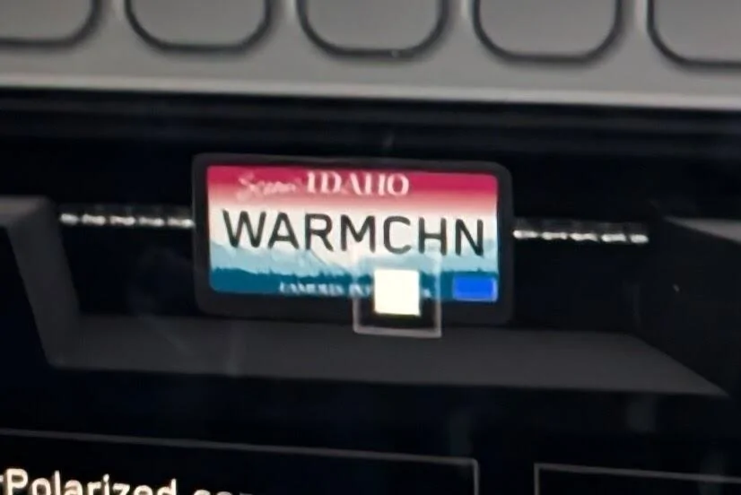

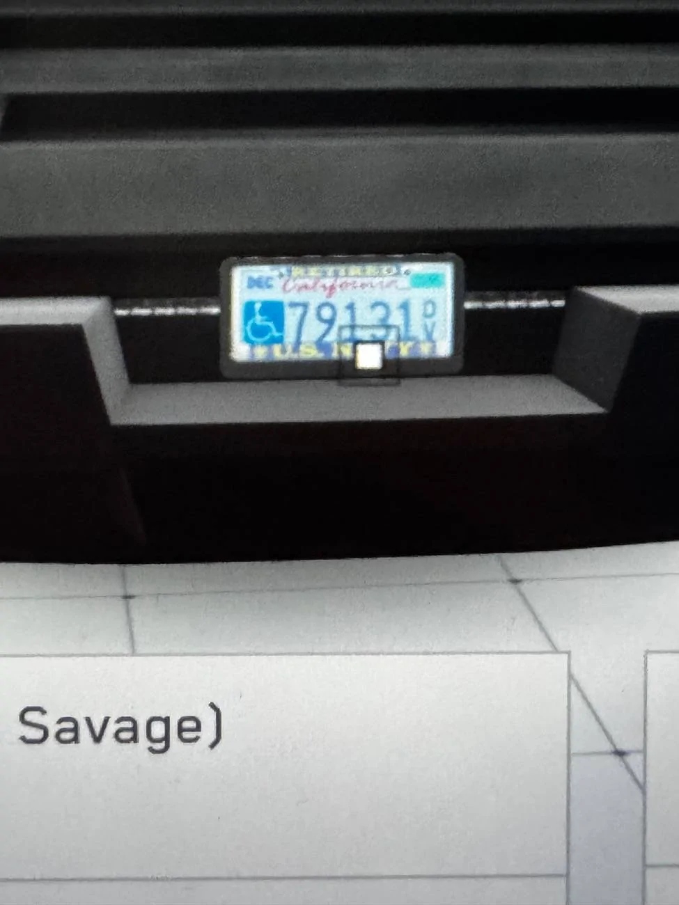

Has anyone figured out how to upload a license plate image? In my first attempt i put my license characters on and moved the Cybertruck graffiti image up but it doesn’t look like a license plate. If I can upload a blank CA plate, or a photograph of mine, it will look like the real thing. There is an images tab in the Paint Shop but I do not know where to put the image to get it to upload.
There isn't one at this time, at least not anything that Tesla has shared publicly. You could creates a Plates folder off the root and put an image in there but I don't know what the pixel resolution or size would be.
True about creating a folder, but wouldn’t Tesla have to look for images there? At least I could begin working on it.

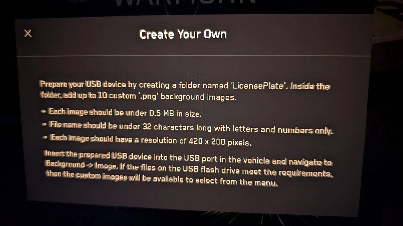

BTW I forgot to mention that I took a picture of my plate, converted JPG to PNG and scaled it down to 420x200, then created a LicensePlate folder on my main USB drive and put the image in that folder. (Image was named KSPlate.png), plugged the USB back into the truck and went into paint shop and it shows up under the background tab. I selected that background and then deleted my overlay text for the lettering on my plate which I was using previously against just a black background so I didn't have double image of the text. My background plate image showed up just fine, saved and it now shows up on screen. I need to get a better pic at some point but for now it works great. I need to post these directions on the www.CybertruckCustomWraps.com website.

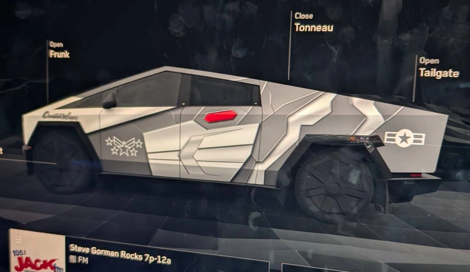

Here’s mine, pretty basic but I think its fun:
Tesla Cybertruck How to: Create and load your Cybertruck custom wrap images onto your Tesla's 3D car visualization (instructions) Shuttlecraft
