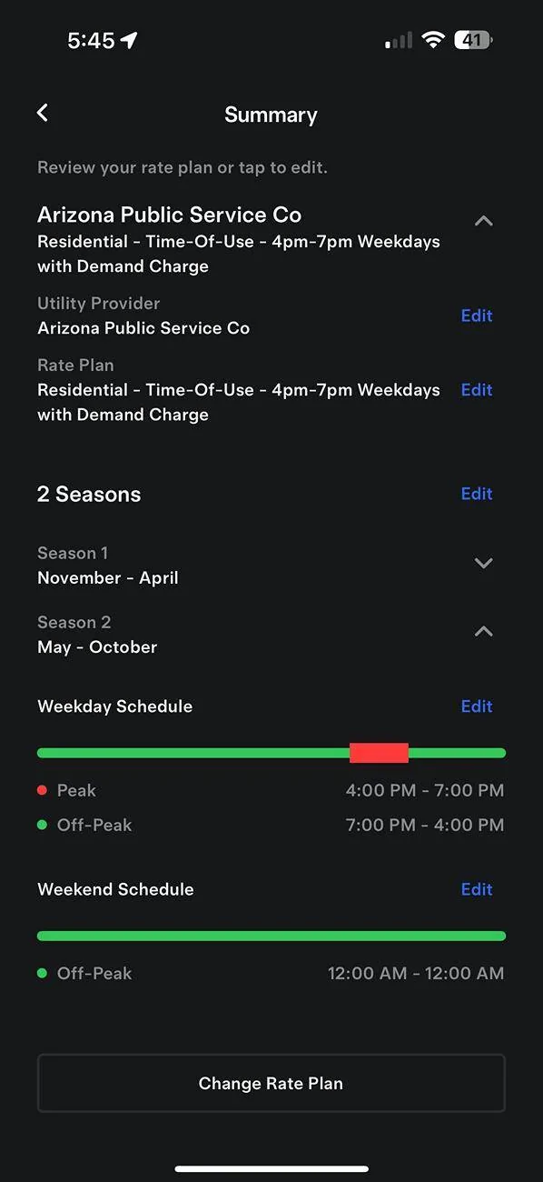

So, I think I’m doing that…
Does this look right to you?

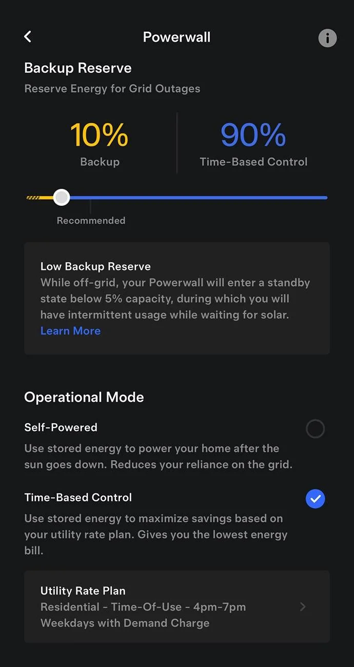

I have tried this with the backup reserve set higher too

It’s the “demand charge” part it doesn’t seem to grasp

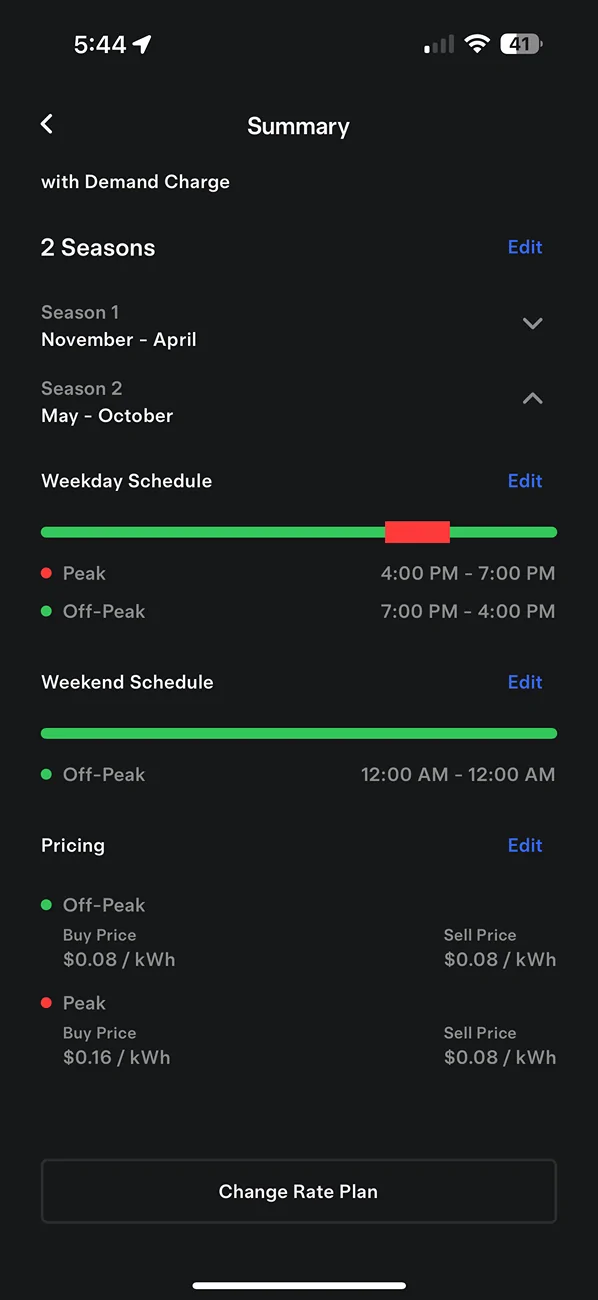

It just says “demand charge”. Not otherwise specified. Not” tyrannical overbillling for five minutes of accidental use.”? seriously though, I don’t know how to see what it means by “demand charge”
That’s what gets you. Not the 16 cents per kWh

Yes. All the above statements are true. First I thought it might be vehicle charging because I think that preferentially will take the difference between UWC demand and solar production from the grid rather than drain the powerwalls due to “powerwall priority. “
So I turned off “charge on solar” and set a hard stop in the car menus right before peak time but that changed nothing. Going off grid did though. The price difference was pronounced.

Not sure I understand what you mean by expanding the peak window. Wouldn’t I have to create a whole custom rate plan to do that? This is the Tesla generated APS plan profile.

I *think* you can click edit and bump start time to 3:45. (Don't have a system to test on).

You’re right. Was very simple to edit. I made the peak hours 1500-2000 rather than 1600-1900 to see if it makes a difference
