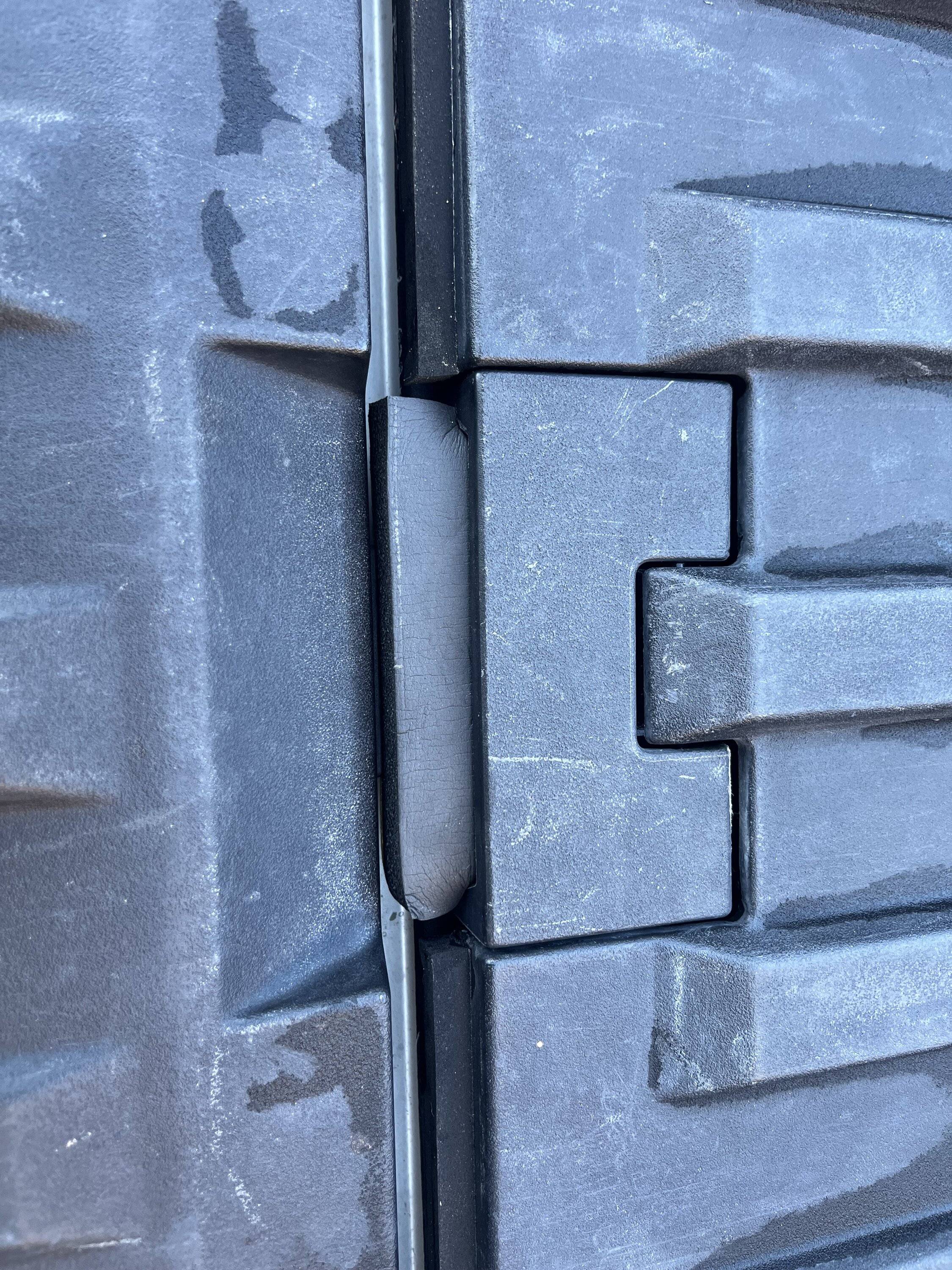

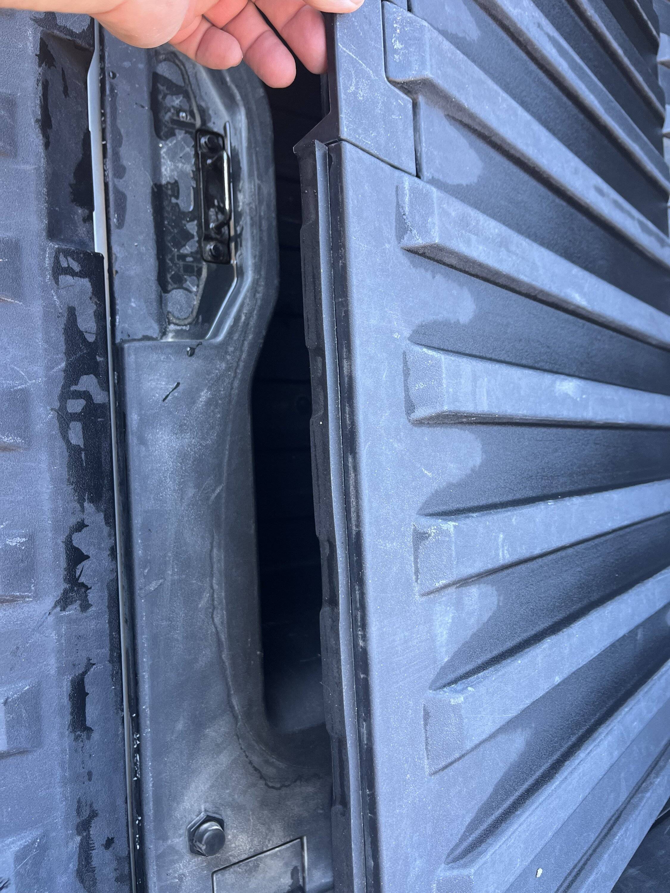

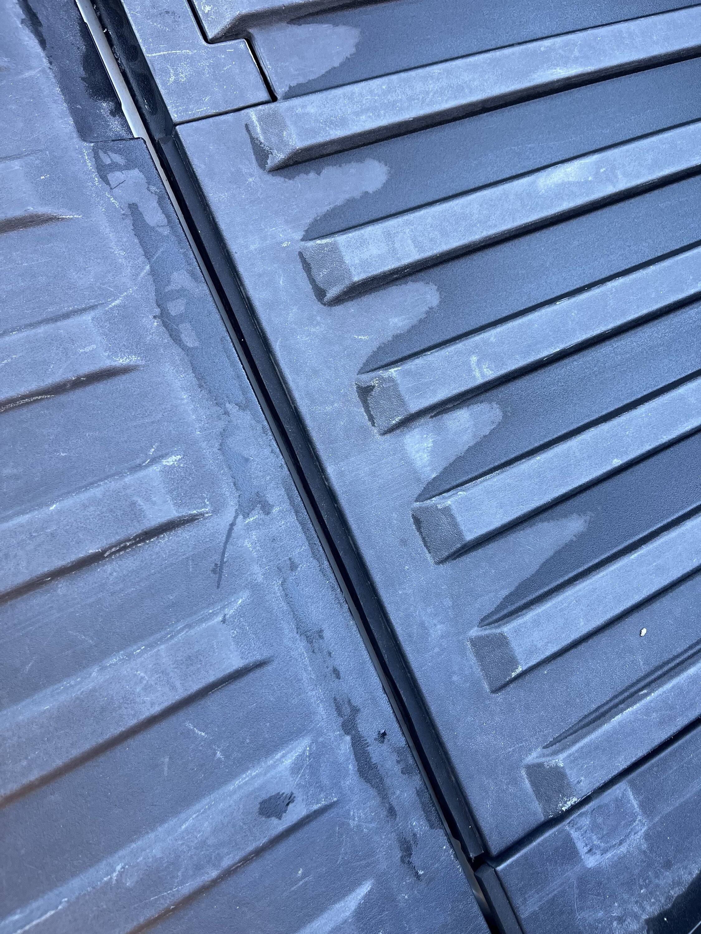

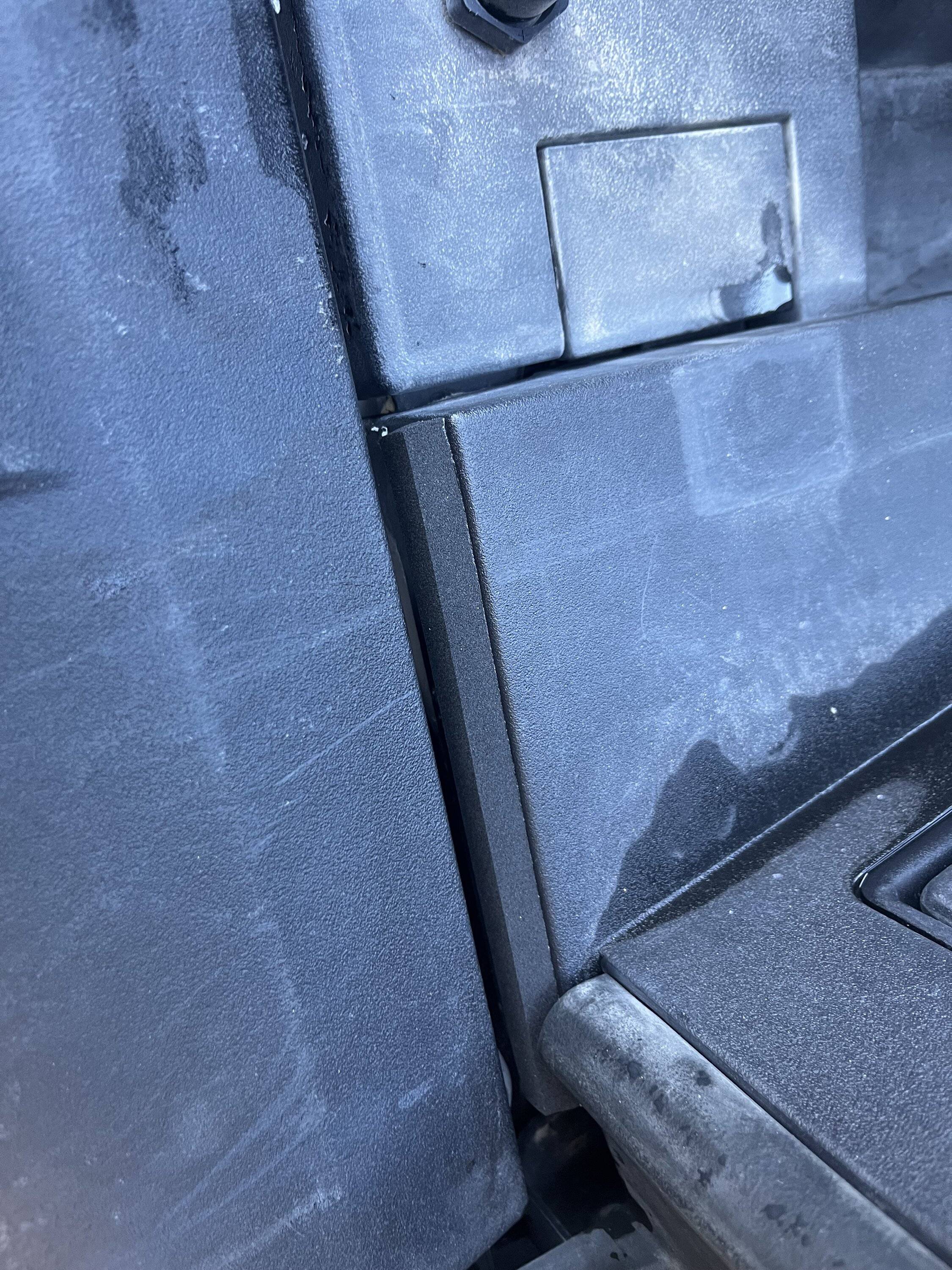

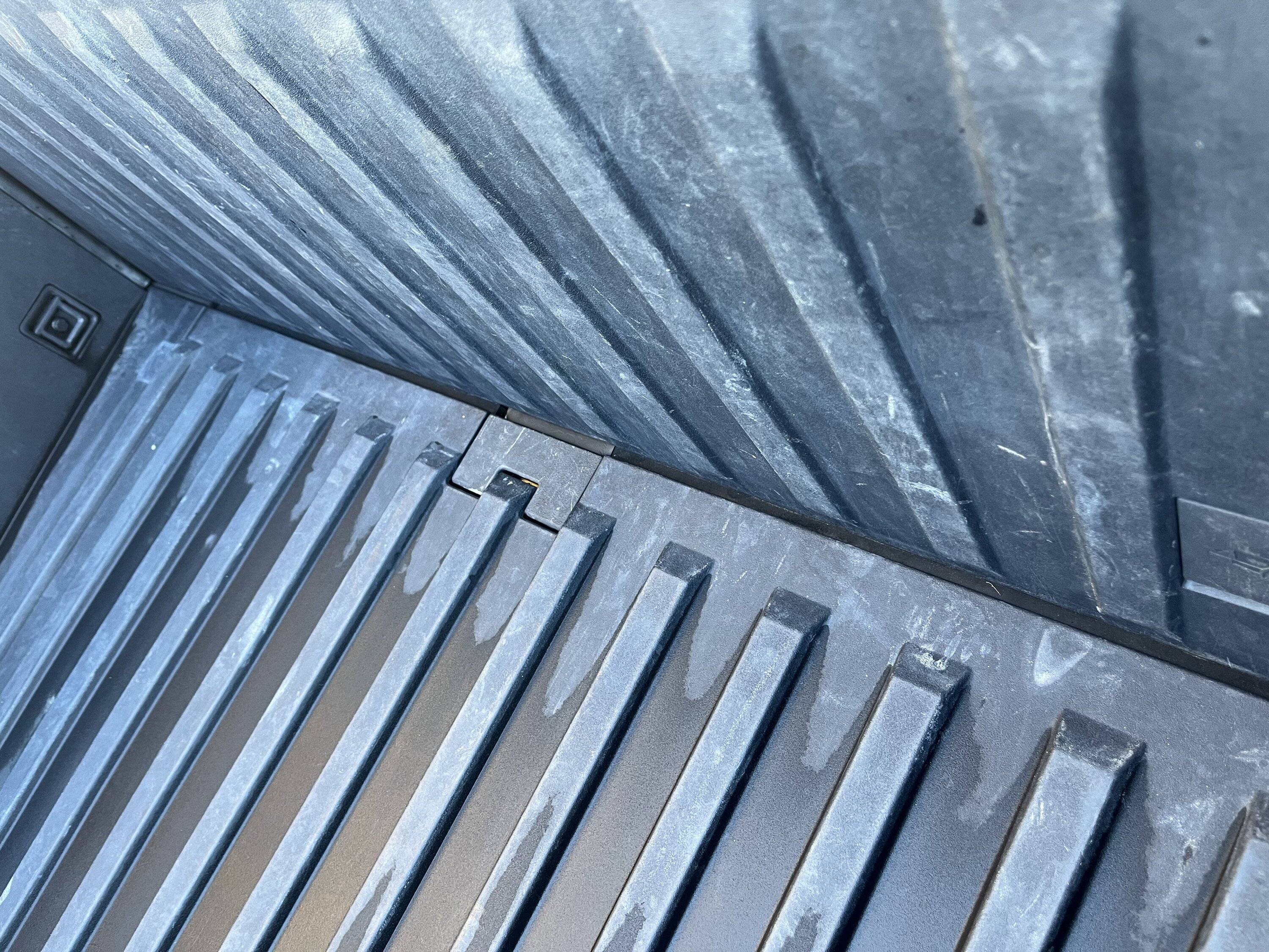

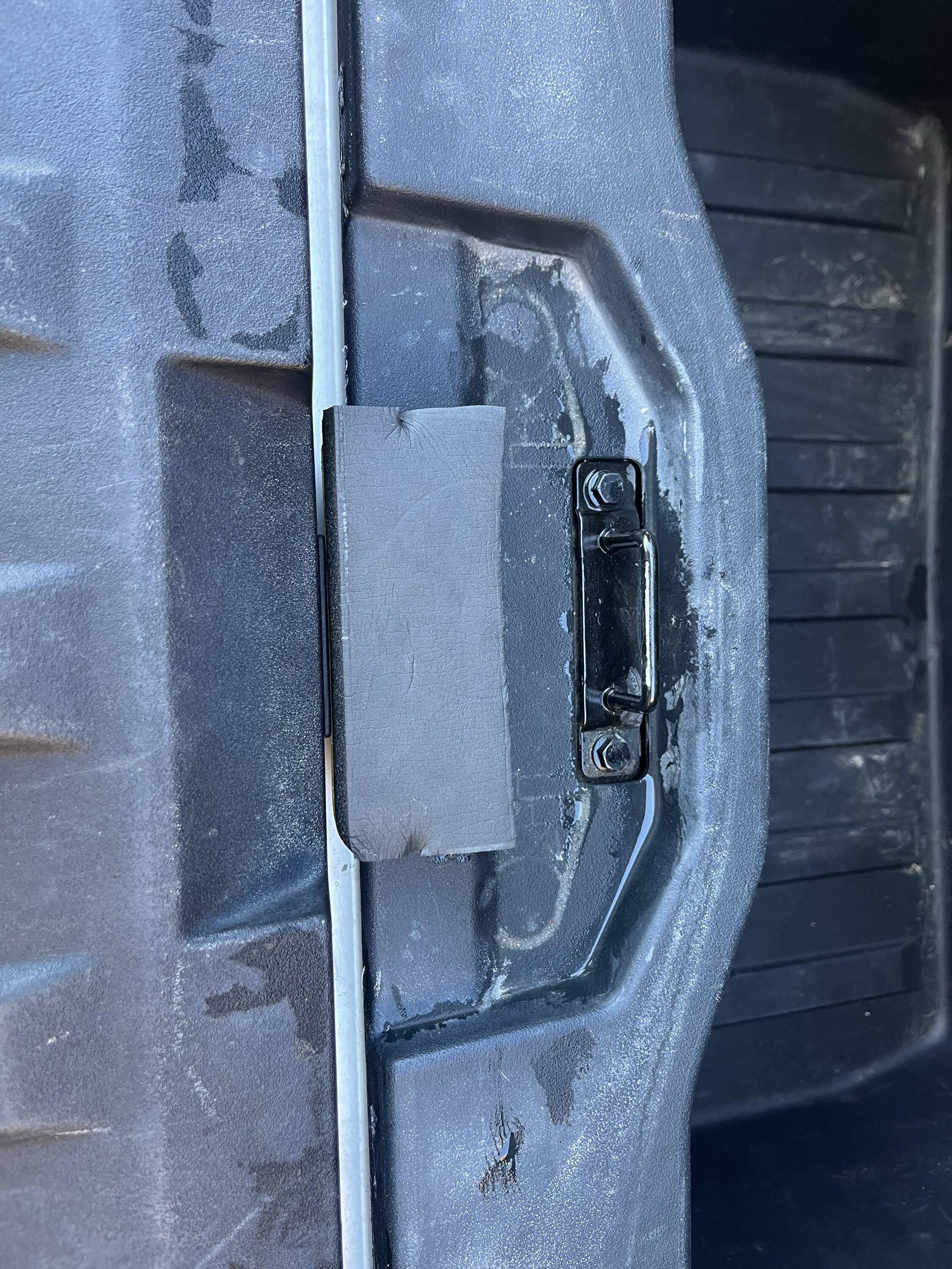

When the vault is closed there is a massive gap at the tailgate, and if you drive down a dirt road, it is a vacuum environment and will pull dust in and literally get everything in the back dirty. Even driving on city streets and highways it pulls dirt in.
The “traditional” pickup solutions dont work because of the rear storage that lifts up.
Anyways it is a simple solution, get some closed cell self sticking foam 1/2 wide by 3/8 tall. Stick on the lid and the bedside gaps. For the handle gap its just a chunk of foam that the handle holds in place.
Clean bed at last!
