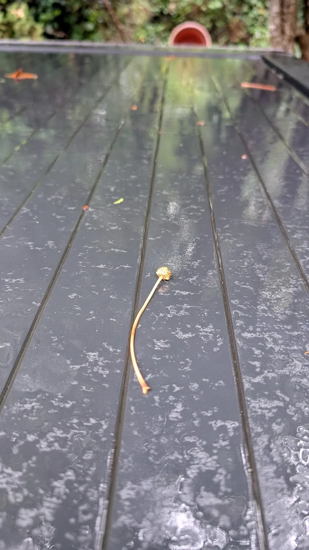

Just found a new (to me, anyway) water intrusion vector - it rained here for the first time in a few weeks and I found water in the center of the bed, not close to the bulkhead.
Turns out one of these stems had gotten caught in the rubber seal between slats, and created enough of a gap to let water in. That's what I get for parking under a dogwood tree, I guess.

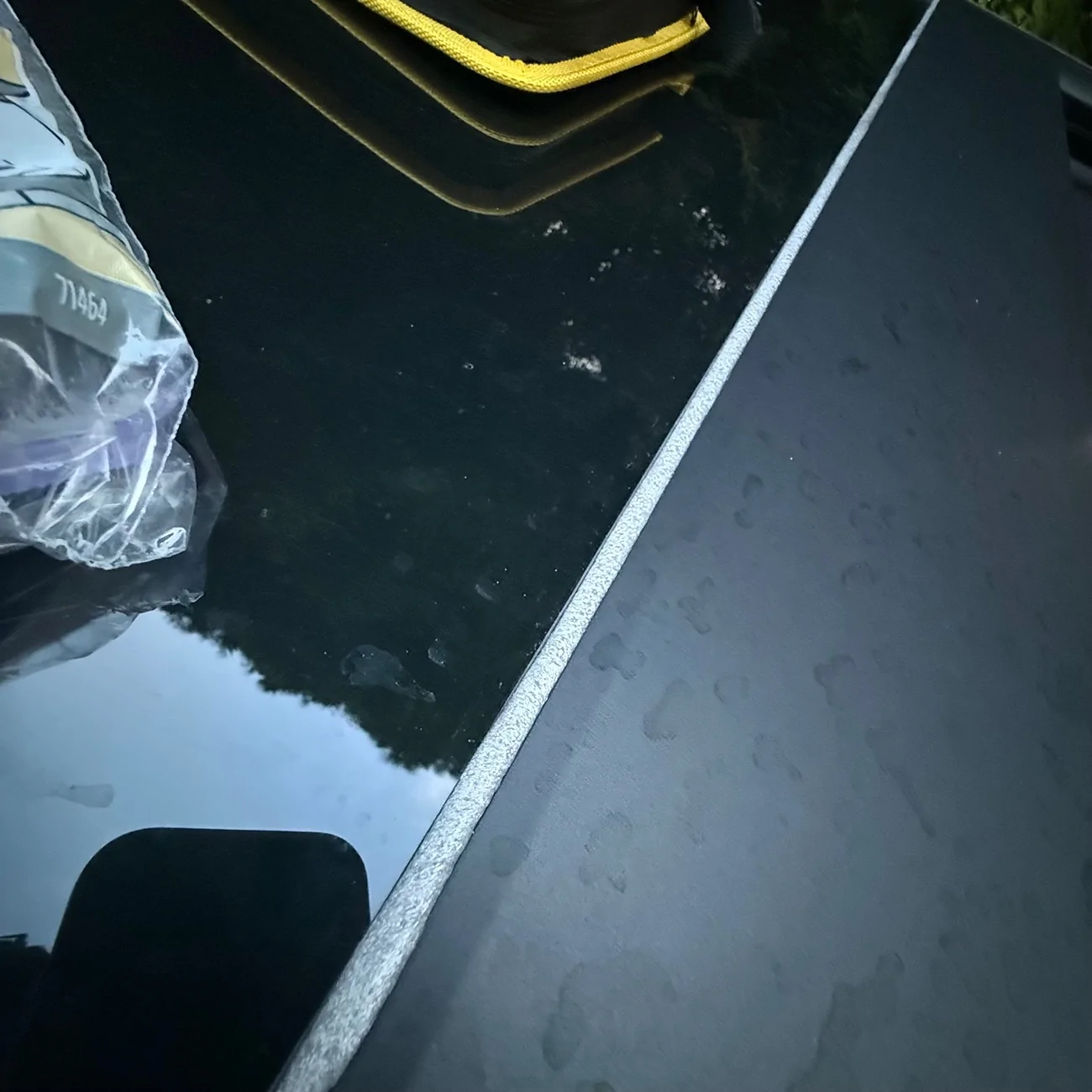

as promised heres pics from my fix:
I used this:
Tesla Cybertruck Waterproof your bed vault - how-to DIY IMG_0650
and basically stuffed it in here:
Tesla Cybertruck Waterproof your bed vault - how-to DIY IMG_0651
I left the old seal in place and from below made sure it was seated properly. this worked for me.

my fix would allow for that. the backer rod is just pressed into the gap. no sealant. its a bit slow though. they really should just create a better seal that we can slide into the existing track of the appliqué

This is really smart. I ordered this on amazon, I’m gonna do this today and then put a weatherstripping seal over it too. I’ve been use auto weatherstripping on that gap for a couple weeks and that’s been working decent, but this should do the trick combined. Nice work!
Mine is coming today and will be trying the same. Anything to avoid the service center is a damn gift.
What size did you get? I got 3/8 and there’s no way it’s supposed to fit in that gap

Ok I stuffed the heck out of it in that tiny gap. And covered with auto weatherstripping. I’ve never used backer rod before, do I have anything to be concerned about wet or freezing weather and that foam expanding and causing any other issue?
