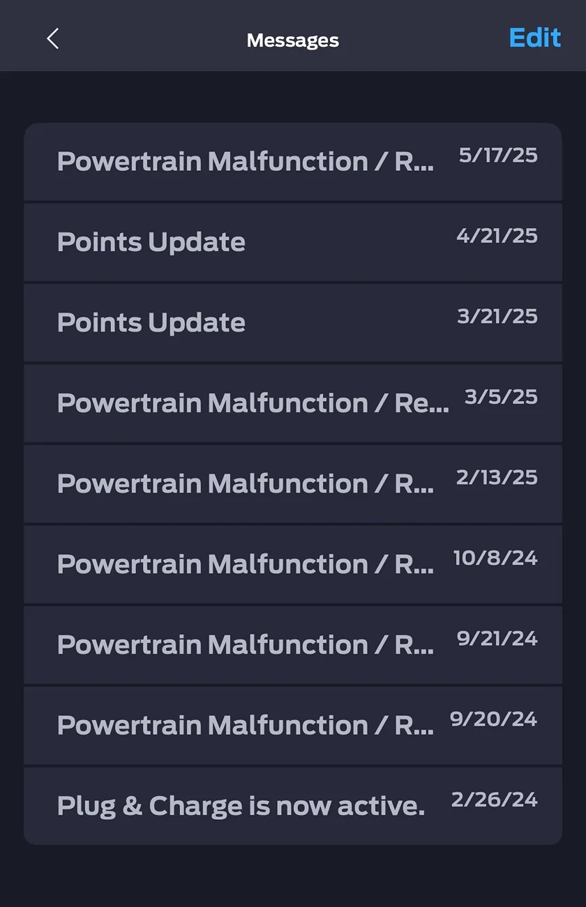

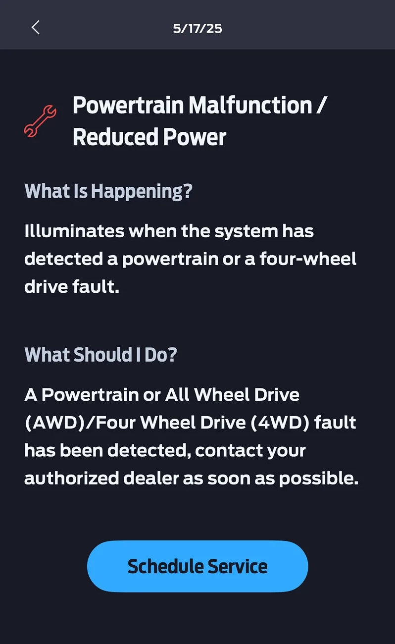

So sad to see this, had similar errors on my Lightning, Ford could never figure it out, just kept replacing parts in hopes that it would correct itself.
