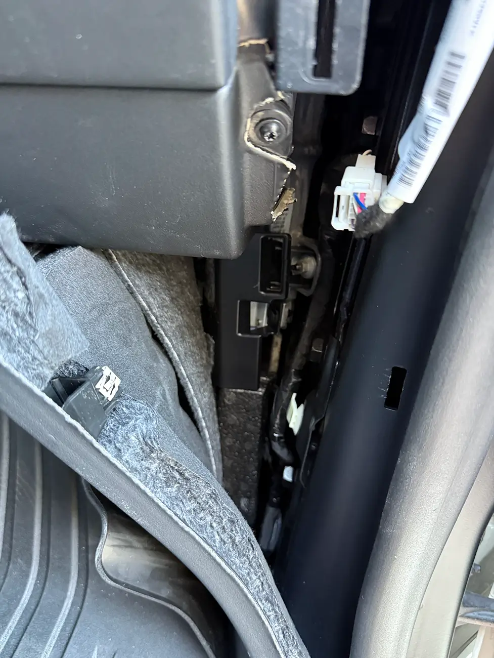

The harness is this one by the passenger door footwell.
Tesla Cybertruck I gave Grok an Upgrade! IMG_5606

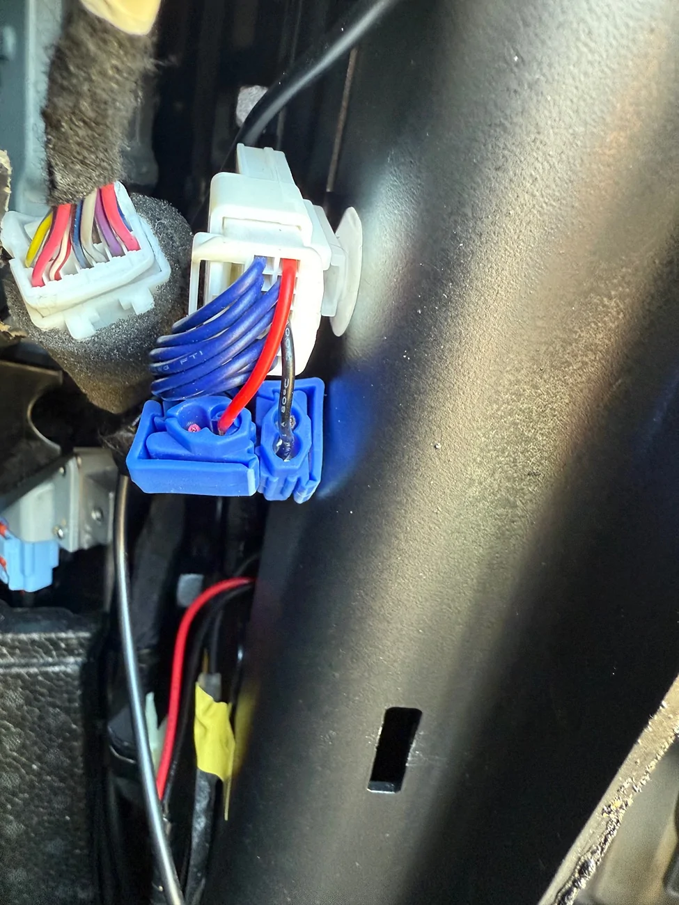

Yours won’t have those blue crimp connectors on it.

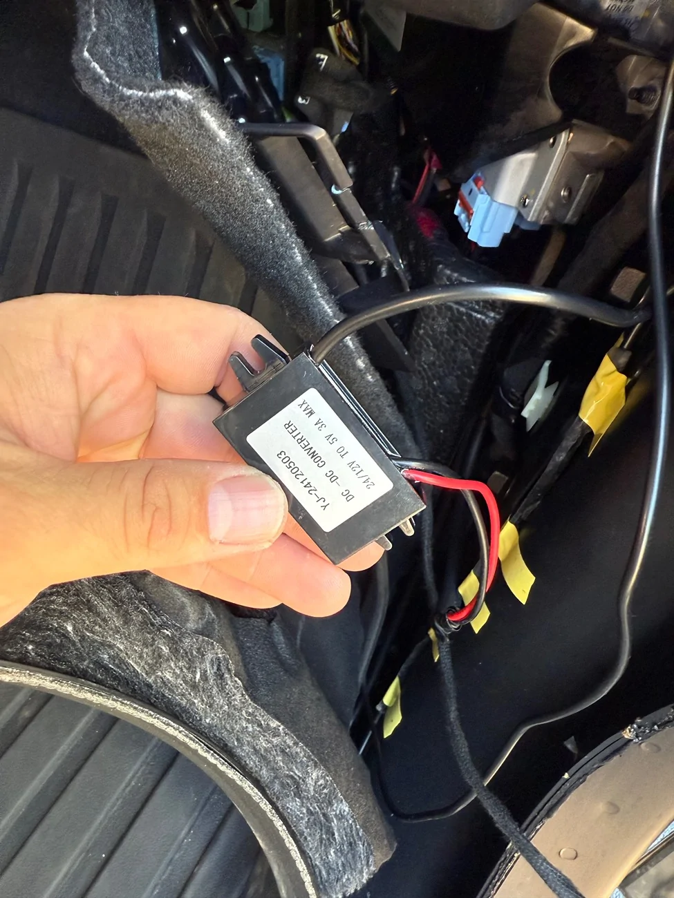

I wired a little usb a breakout I got from Amazon. In my case I got one with a 3 way connector because also wired my fiber optic stars to it.
Tesla Cybertruck I gave Grok an Upgrade! IMG_5607
This is the little breakout I got.
Weewooday 12v to 5v Dc Converter... https://www.amazon.com/dp/B08RBWX2GL?ref=ppx_pop_mob_ap_share
Note: this appears to be 12v power, not 48v

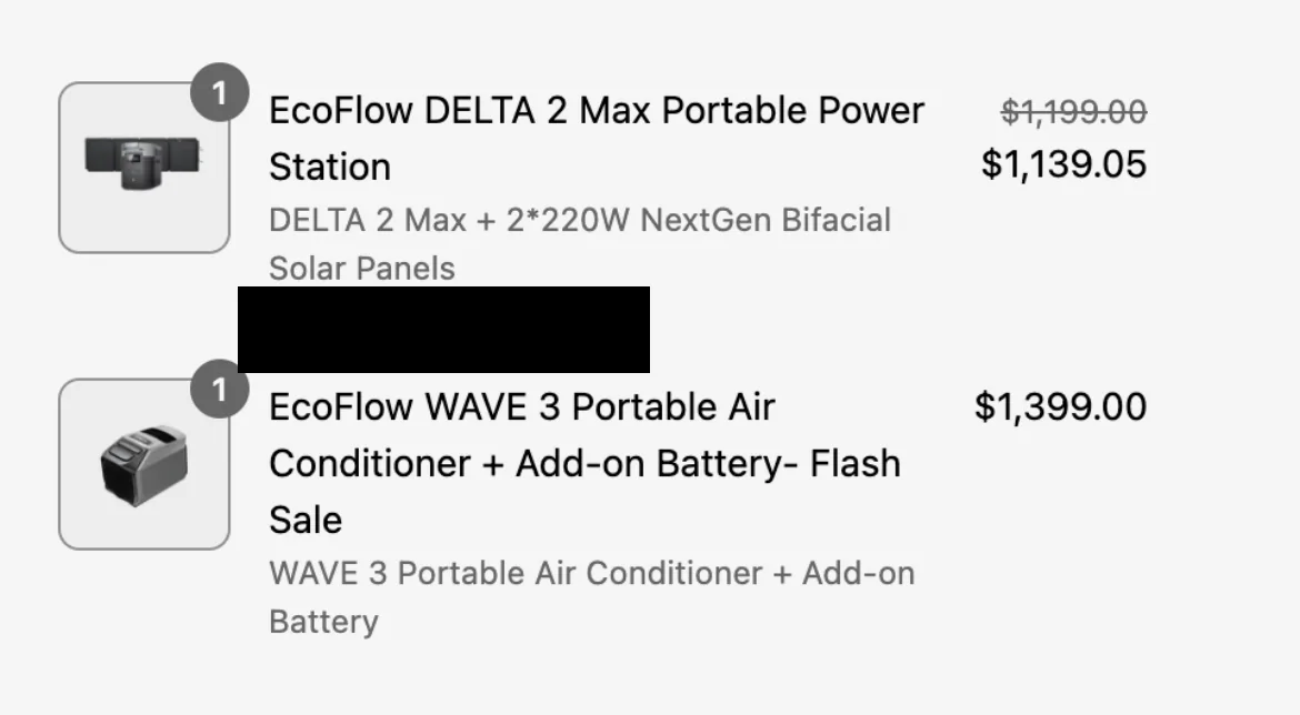

You know, good question. To be honest I read what you said somewhere about leaving things plugged into the Cybertruck would drain the battery pretty quickly...like they were innefficient. And with my Cyberbeast already marginal on range, I figured I would want to minimize battery drain from it for powering external things like an electrical cooler (perhaps an Ecoflow Glacier...haven't decided yet....I think it won't fit below the L-Tracks in the bed, or an Ecoflow Wave 3 (not arrived yet) for the RTT, or anything else that needs electricity (I also have a toy remote controlled Cybertruck like you 😆).
I'm pretty much trying to make smarter decisions on the electrical useage of this Cybertuck from reading what others, who are smarter about these things, like you, say about these things on this forum. I mean, I like being indepenent with a mobile battery on wheels, except it doesn't have the range and capacity that we all originally signed up for, so I'm trying to supplement that battery capacity, I guess, in after-market ways...
I currently have this in my shoping cart, but haven't ordered yet because I might add a Cooler and if I go over $3K I get a free 220W solar panel on their Labor Day promotion (which will make 3 total):
Tesla Cybertruck I gave Grok an Upgrade! 1756567336502-0a
114
8,353
9,582
The delta 2 max is a great battery for that AC and/or any fridge you get. It will live in the bed though and have to charge off the ac outlet which will happen pretty fast (about 1600w).
It will serve 90% of your needs. It’s also really cool it has two 500w solar inputs. It’s powerful enough that with a bonding plug it can give you a couple of miles of charge to get to a supercharger in an emergency which is awesome.
if all you want do in the frunk is charge up toys and tools and such, I’d get something small like this:
https://a.co/d/f5TbGnS
Ecoflow makes a similar product but I think for the money you get a less complete product.
no app control, slightly slower charging etc
https://us.ecoflow.com/products/tra...hPNL8RwwuI4sSuk1SRmtDlahPZkHFRIsaAo_DEALw_wcB
With respect to fridge, I eventually nixed the ICECO go 20 I love (just moved it to our model x) for the 18L Chinese center footwell fridge because nothing else comes even close to taking up less room.
https://www.tesstudio.com/products/...qt8zJxBn942bqXE1zG74luLLdIvKx3M0aAluWEALw_wcB
You could then get something else to use as a freezer if that’s something you need.
the river 2 variants add some ac plugs for a frunk setup if you need that and also adds the ability to use the frunk feed as a source. So does the Pecron with much bigger inverter but takes up a lot of room in the frunk.
A lot of options but in my opinion those are the best.
You can’t go wrong with the delta 2 max to pair with the wave 3 though. It’s a really good choice.

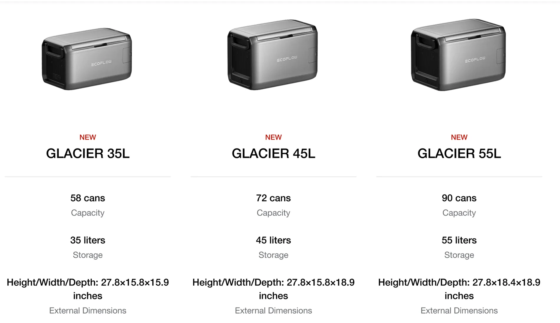

Thank you for detailed response!
With respect to the fridge, I did not think any Ecoflow Glacer would fit in the Frunk at all with their dimensions:

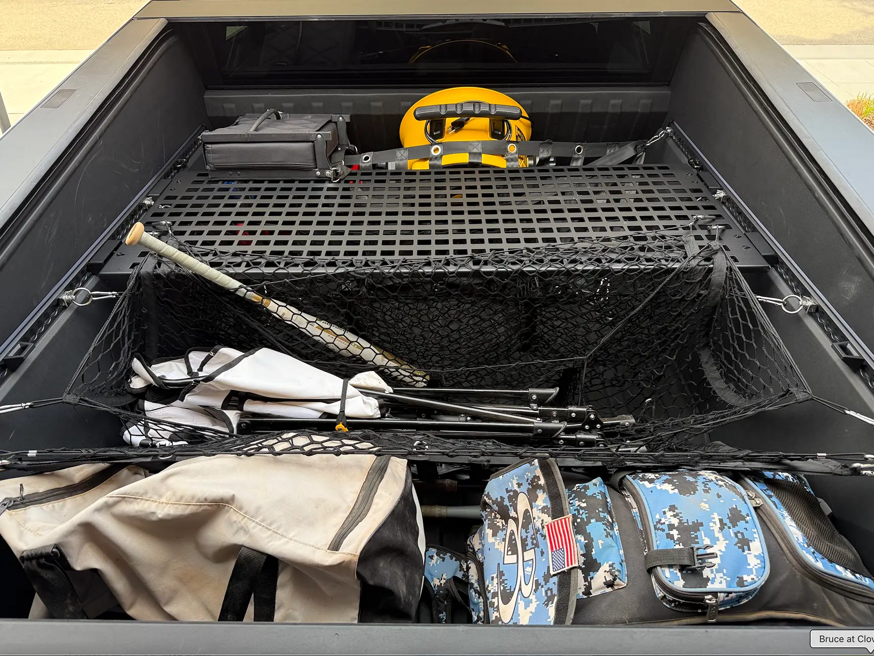

I am not worried about using all of the Frunk's space, if necessary, if a Fidge/freezer will even fit there. I just thought the biggest challenge was finding anything decent, at all, to fit in that restricted space. I figured I would at least get something that could fit under the L-Track in the bed because I don't have a Cybertent, but I do have a horizontal Mole panel back there which I am kind-of fond of:
