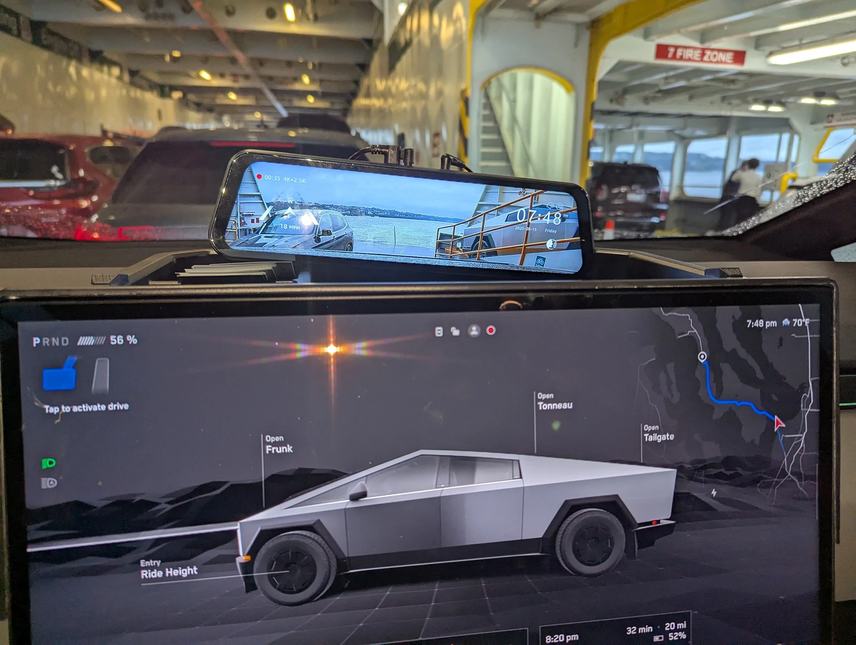

Note that I found that I choose the wrong material for the 3D printed mount for the Wolfbox. It's pretty heavy - and I had the truck parked out in the sun for 2 days.
The mount sagged....
So, don't use PLA, I'm going to print it again using Nylon.
