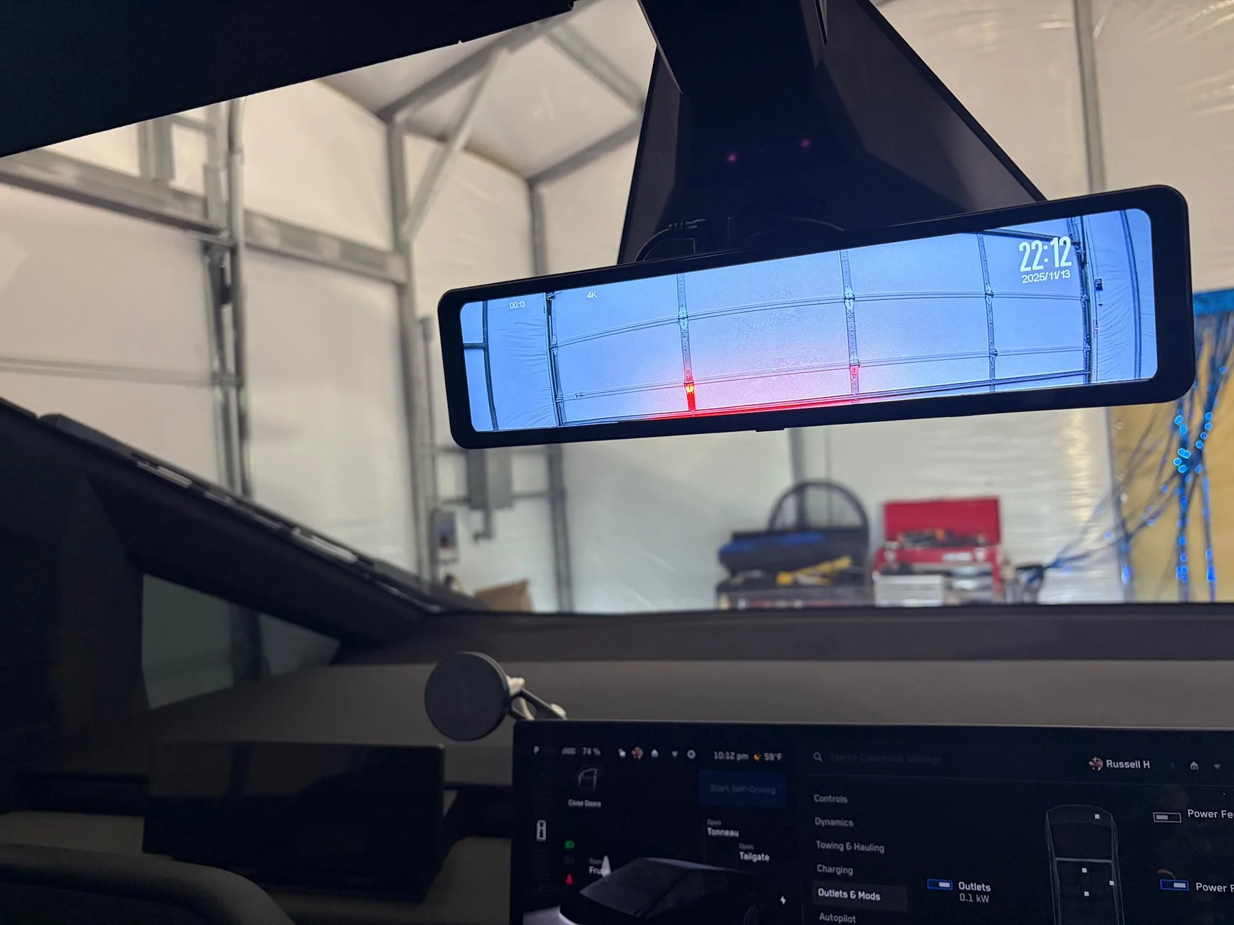

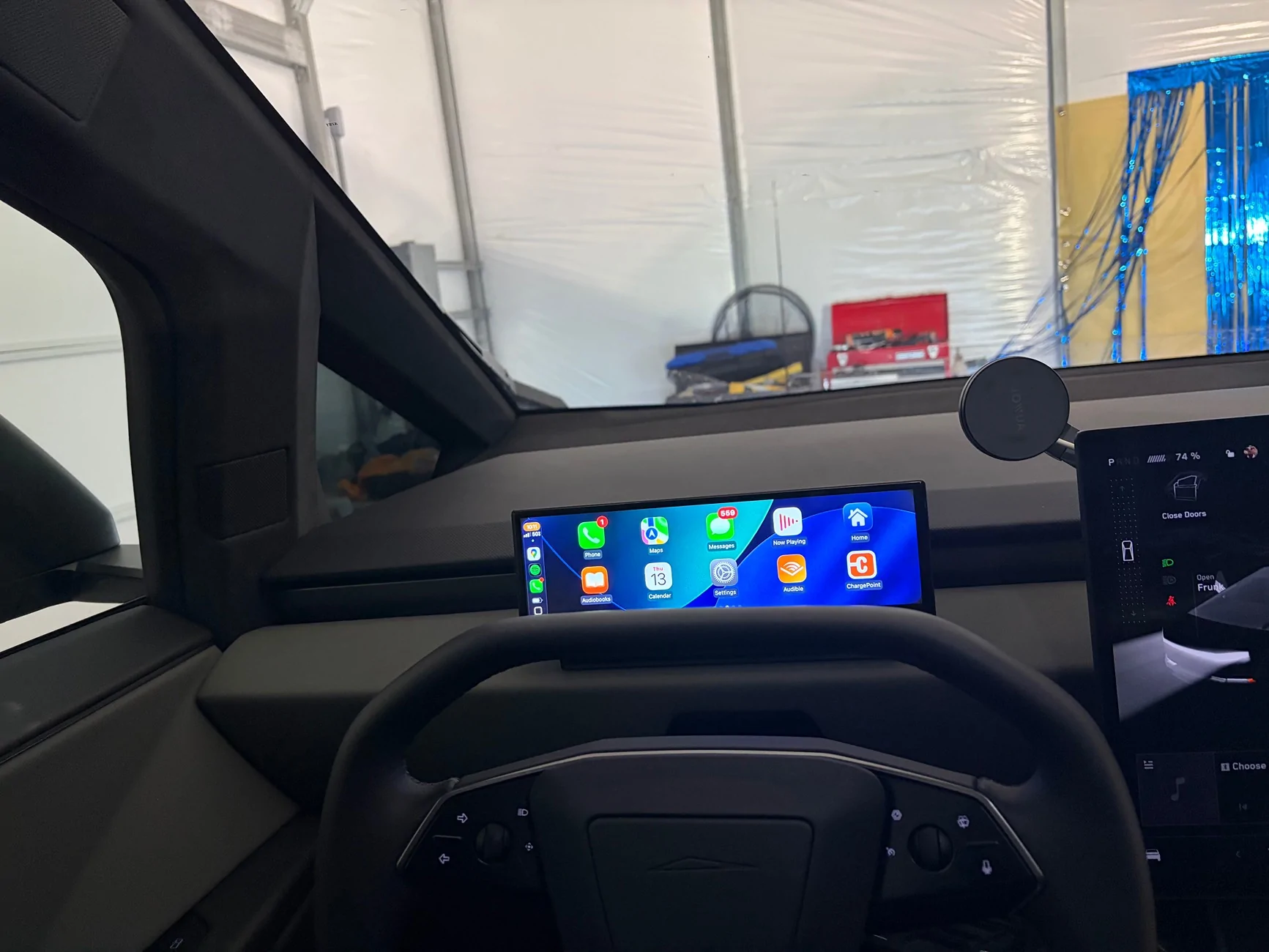

I have the 10.88" screen installed on my dash and I just installed the Hansshow V2 rear view mirror. I have hit a problem and hoping someone could point me in the right direction.

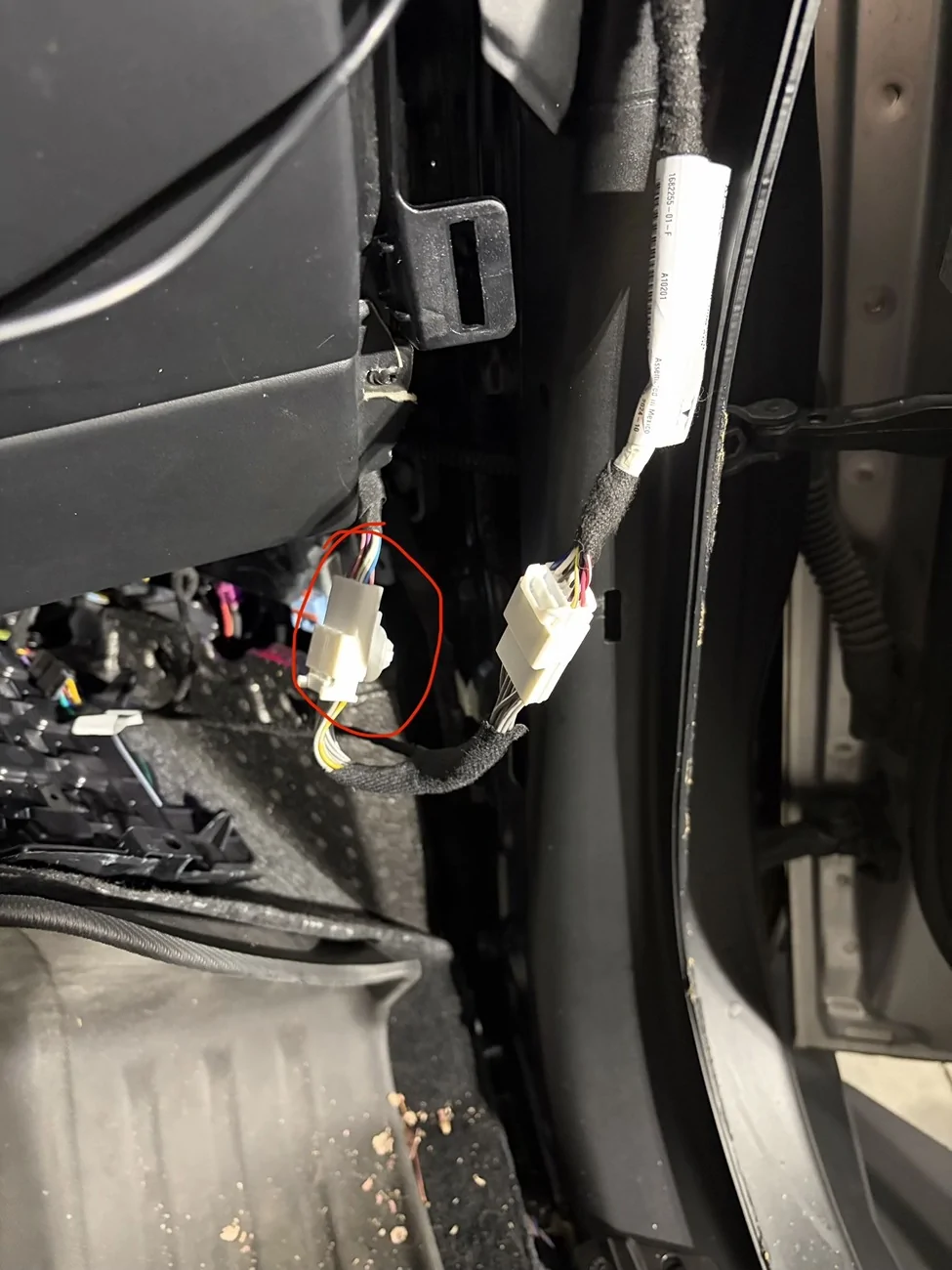

1. Both devices have a wiring harness that connects on the passenger side floor/door. In the picture below, I have the screen connected. The circled plug is providing the power. If I disconnect the screen and connect the mirror, the mirror will have power but the screen will not.
Originally, I plugged in the screen then for the connectors that are not circled, I connected the mirror connections.
What am I missing? How can I run both accessories?

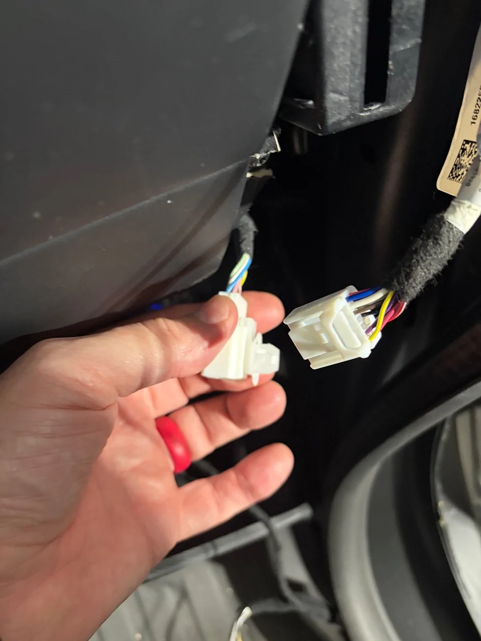

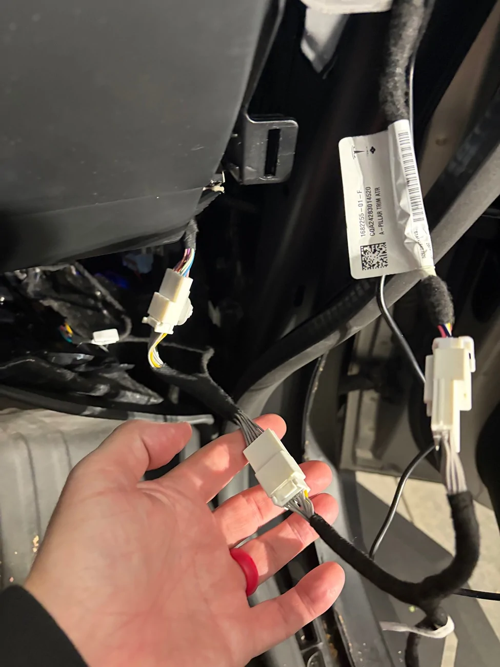

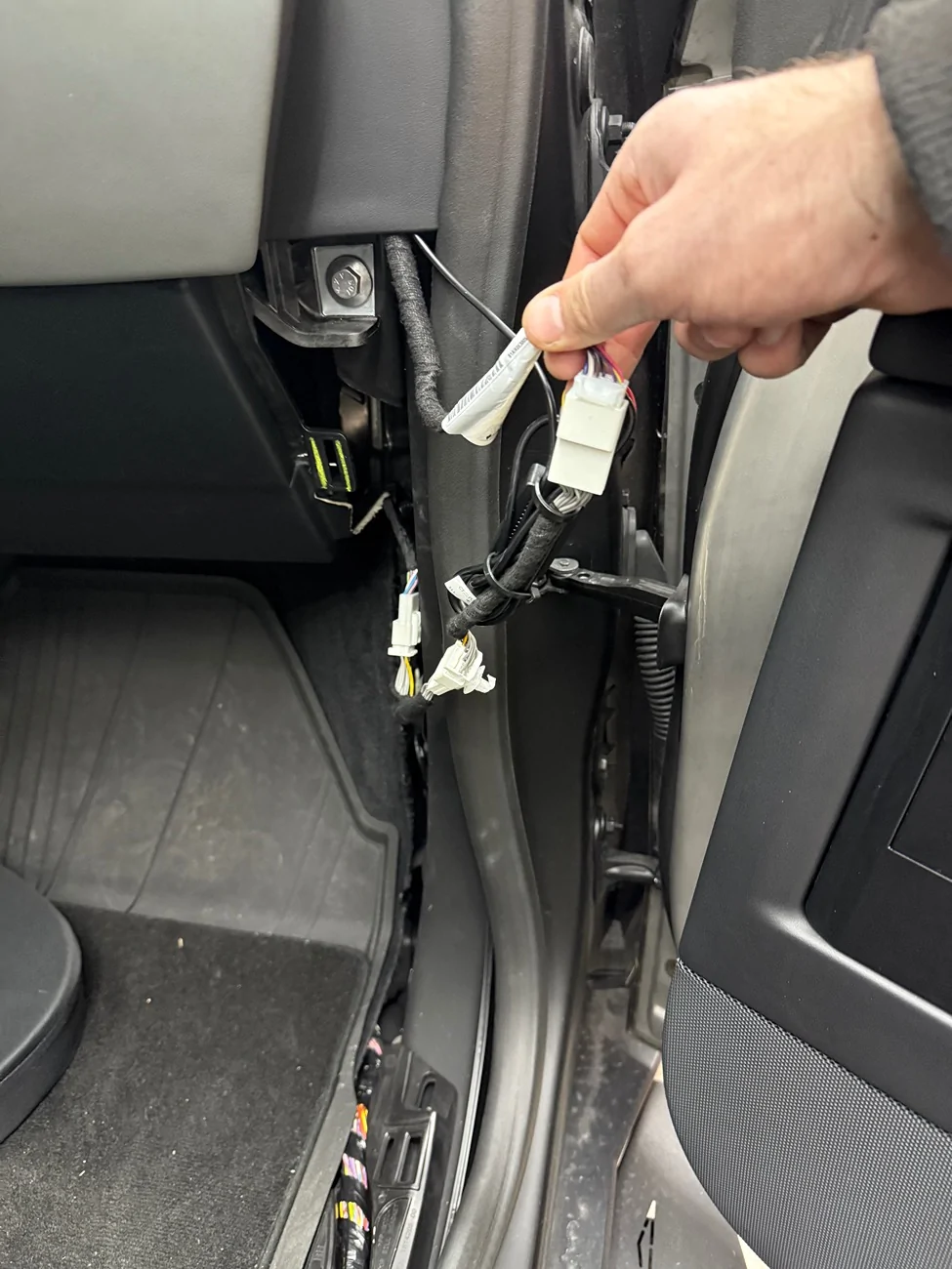

The issue is, on the right side, there is one plug that carries power. The two wiring harnesses both have male and female connectors. Whichever plug I connect to the original plug with power, lights up.
The second item down line doesn’t get power. That tells me the wiring harness, has both data and power feeds. The power runs into th side connected to the hot conector…and runs back to the display (mirror or display). Then the other side is just carrying data.
as a result, I can’t daisy chain to get both on.
I need to find a way to get power to the second display. I also have the refrigerator in the floor…but that just plugs into the under console outlet.

The issue is, on the right side, there is one plug that carries power. The two wiring harnesses both have male and female connectors. Whichever pug I connect to the original plug with power, lights up.
The last picture, the plug with the extra part on back is the plug that carries the power. Whichever male plug goes into that will turn on.

I figured out a way to make this work. I will have to get more pictures after I am done running wires. I got a 2-port surge protector for the 110 outlet under the rear screen. My refrigerator is plugged into one outlet. The other outlet, I used a 12v DC converter plugged into a cigarette charger plug with a USB and a USB-C plug. Using a USB to USB-C wire, I have routed the wire under the driver seat up to the dash behind the center console. Then routed the USB cable up the A-pillar and headliner to the mirror.
Using a USB voltmeter, I confirmed that the mirror needs 5a of constant power.
If I had this to do over again, I would probably have just got a MagSafe mount, placed it in the center dash behind the wheel and used an iPad mini as my dash screen. Instead of a screen primarily used for CarPlay. Regardless, this will work and the screen looks really nice. It’s a 10.88” screen
