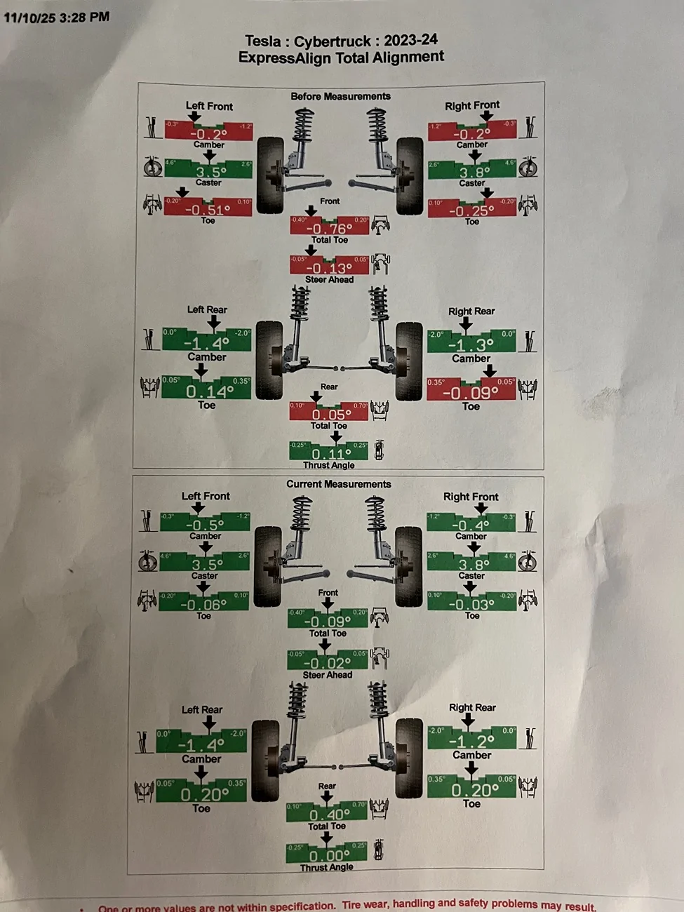

Looks like a few discrepancies there. Did you get things into spec and how the tread wear now?

It hasn’t been that long since the alignment, but I do expect it to wear better in the front now. I hope I keep a better eye on it to see. I noticed the uneven wear, even though it had been in the shop for something else and they didn’t mention it a month earlier.

So had to get 4 new tires. That was a painful checkout🫤.
The alignment did have some minor outta range stuff which was tweaked a bit.
BUT one that was way out was front cross caster which is the difference between left and right casters.
Normal is -0.2 to +0.2.
Mine is -0.9 😶
Anyone have any bright ideas and whether I should work that up. I sent them a mssg to see if we should pursue that but would like to hear any other opinions.
