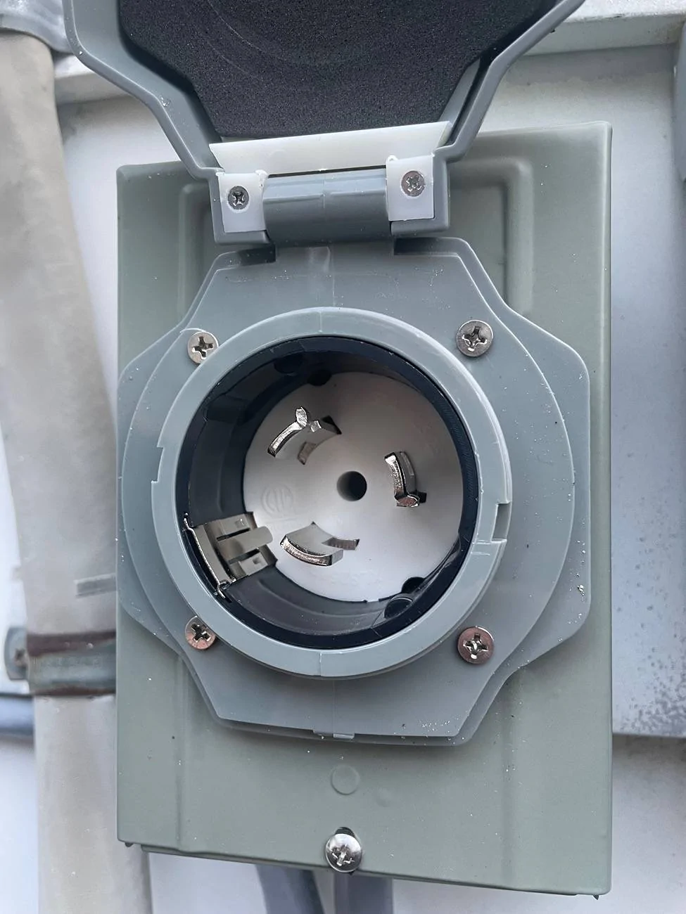

Just purchased this kit to provide emergency backup power to my house. I've been looking for quite a while for a safe and simple solution, and this one seems promising. Hopefully I'll remember to document the whole process for others out there like me who can't really justify spending thousands on materials, labor, and permits for an automatic transfer switch (we have extremely reliable power where I live).
I'm also thinking about implementing a throw switch and/or interlock; not sure yet though. Open to suggestions all around. If nothing else, I'll place a lock on the box to prevent shock or electrocution, should the breaker be flipped on by someone unawares.

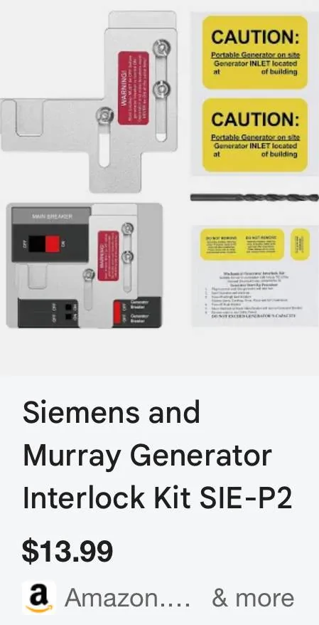

Did this. Interlock kit is a must. Double pole breaker located directly below main breaker, fed from receptacle mounted on outside of house.
Interlock forces the main breaker to be disengaged before engaging the new circuit from external outlet. Cybertruck powers the house for critical items not exceeding the current provided by the Cybertruck. For example I wouldn’t energize our hot tub while connected.

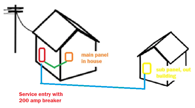

Agreed! it can be super dangerous. That's why I've been mulling over a simple yet safe solution for a while. I don't have solar, but good input on the interlock. In most cases, I would agree with a simple interlock device, but our setup here may differ than what most people are used to. Maybe a couple of pics will help illustrate.
I'm going to draft and print a generator hookup, startup, and safety checklist, and attach it to our house main panel inside, as well as give my family a complete demo of how it all works. It will look something like this [rough draft]:

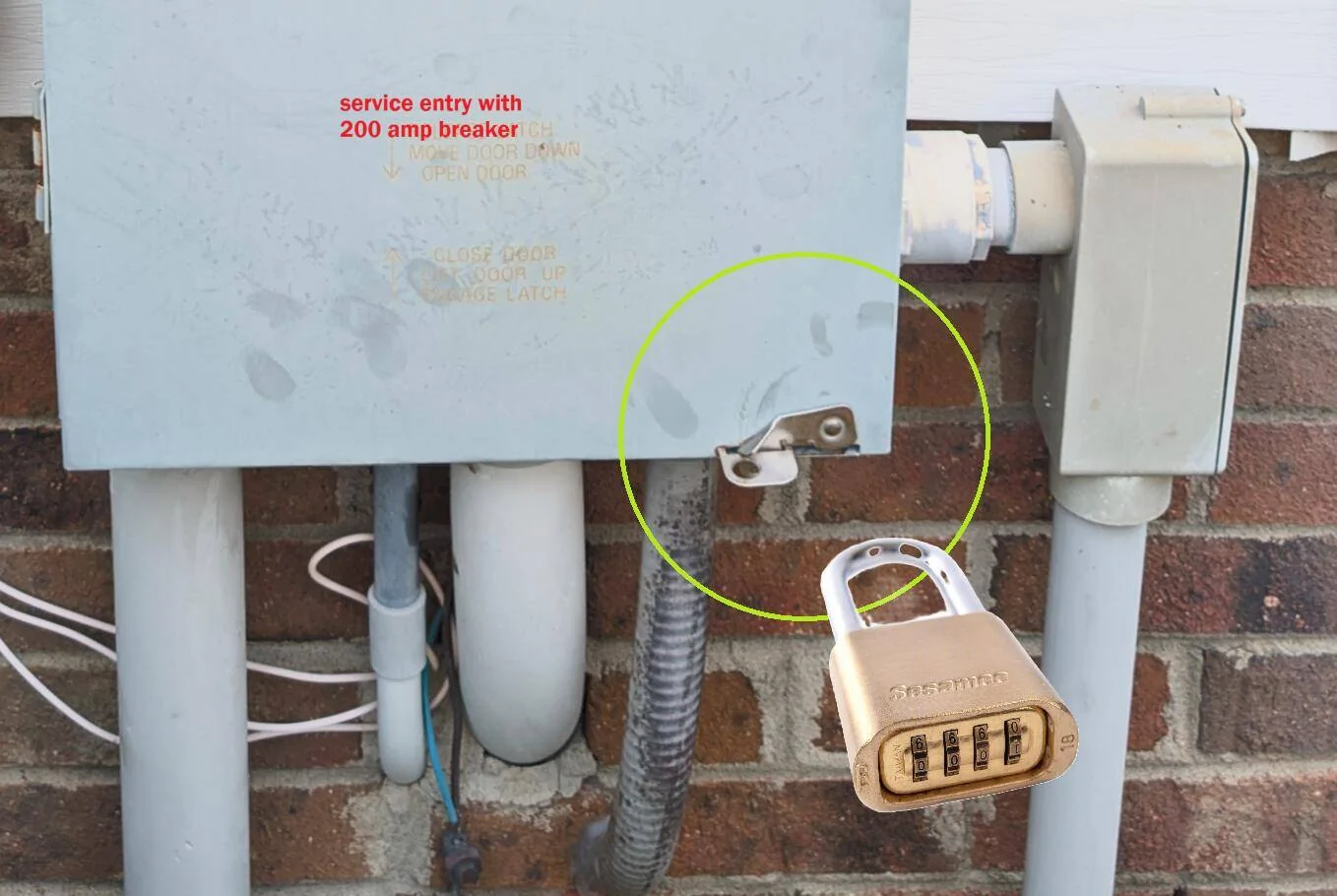

  4. Go outside and flip external service entry breaker to the "OFF" position.
  5. Padlock the external service breaker panel to prevent unauthorized or accidental actuation. [this completely isolates the house from the grid]

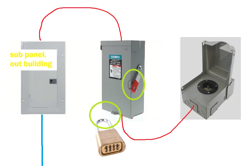

  8. Verify that the [SIEMENS Safety Switch] is located in the "OFF" position, and padlock is in the locked position, [preventing the arm from being thrown into the "on" position" before we are ready]
  9. Plug male NEMA 14-50 [STW 6/3 + 8/1 Cable] into Cybertruck [or generator cordset into generator].
  10. Plug female end of (CS6364) [STW 6/3 + 8/1 Cable] into [NEMA SS2-50P 50 Amp Power Input Inlet Box]. Ensure that the cable is twist locked into position, and locking ring is tightened [if applicable].
  11. Once the cable to the Cybertruck [or generator] is secure and free of any trip hazard, unlock the actuator arm to the [NEMA SS2-50P 50 Amp Power Input Inlet Box] and place padlock into locking slot at the bottom portion of the [SIEMENS Safety Switch].
  12. Move the [SIEMENS Safety Switch] level to the "ON" position.

And then reverse order from there when grid power is restored. There are of course some nuance and details left out, but that's the main idea. The safety throw lever that stands in between the Cybertruck and the subpanel is what makes this system simple, yet safe in the event of an errant actuation of the "backup generator" circuit"; regardless if the breaker is accidently turned or left in the "on" position. Granted, there is room for error if you utterly fail on all levels to perform the procedure properly, but we don't lose power enough to warrant an ATS. So this is the best course for now.
So for those of you out there with valid concerns about an interlock, I do agree. It's very necessary. But I'm likely going to chose to do lock-out-tag-out using padlocks on the enclosures themselves, rather than finding a way to interlock the inside of the panels. Less confusion this way. Plus I get to "clunk" a throw lever like it's the 1800s lol.
