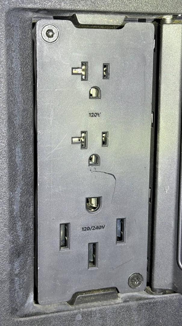

The 240 Volt power from the Cybertruck charging port does not have a neutral conductor. It's my understanding that you need a Powershare Gateway and a Tesla Wall connector for this scenario.
However, the NEMA 14-50 receptacle in the Cybertruck vault is marked as 120/240V which would indicate a neutral conductor. I verified the existence of a neutral conductor with a voltmeter.

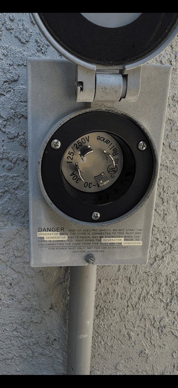

Hey guys, I have this generator inlet at my house. How can I tell if I have an interlock kit?
If I get a 14-30 to NEMA 14-50 generator cord am I good to go? (Will get a electrian involved before blowing myself up but want to understand what I’m working with. Thanks CT fam!
I'm going to guess that's not connected to an interlock, it's connected to a transfer switch. It could be manual or automatic.
An Interlock is going to be a "contraption" connected to your main panel or possibly outside that you will have to throw to engage the power.
A transfer switch is going to be a box, probably mounted next to your panel and probably having some breakers inside of it.
The transfer switch should switch automatically.
