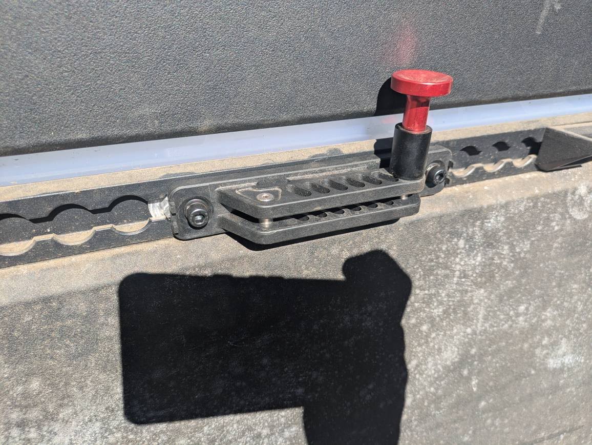

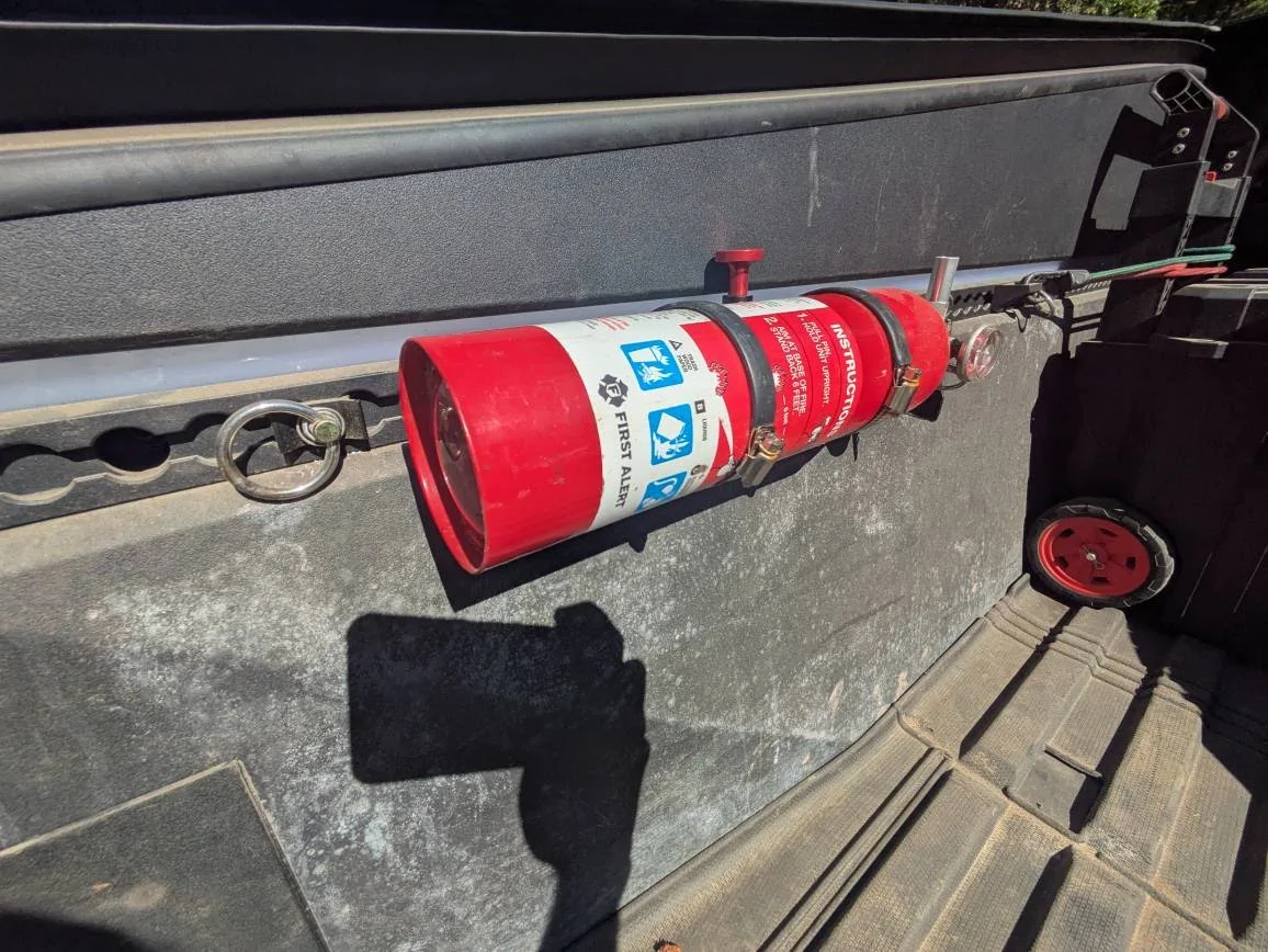

I want to mount a fire extinguisher in the bed, and decided to use a quick detach mount like this :
https://www.amazon.com/dp/B0DB1XX27K?ref=ppx_yo2ov_dt_b_fed_asin_title&th=1
I was then looking at different bolt-style accessories for L-Track for light duty applications and didn't find anything I liked, so I sketched up this part that can be screwed into with the screws similar to those found on PC fans. The hole is currently 5mm, but I can make changes to that easily if anyone needs a different variant, including with a recessed hex pocket for a metal nut.
As for the fire extinguisher mount above, the holes unfortunately don't line up to the L-track spacing. Will need to make an adapter plate.
STL file attached.

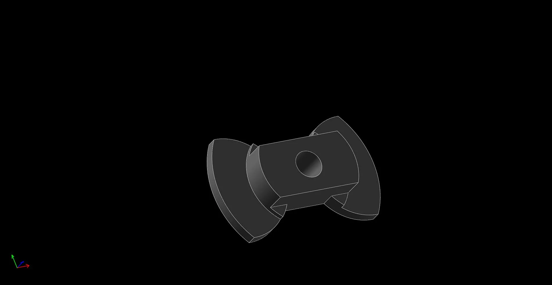

I use Solvespace (very cool piece of software) for parts without complex curvature, and FreeCAD for everything else. The part above was made in Solvespace, but I then redrew it in FreeCAD in preparation for taking it to the CNC mill. Still need to find time to finish the CAM bits and take it to the mill.

But why? If the entire fire department cannot put out the fire of an EV, then what can a small consumer grade extinguisher canister do?

Same reason I carry a 12v jump starter, a gallon of gas and a tow strap.

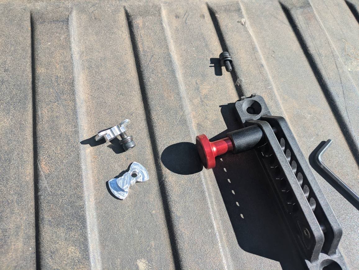

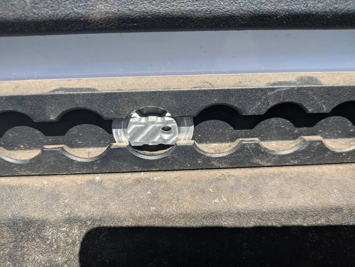

Finally got around to making these out of aluminum as the 3D printed ones aren't sufficiently strong.
