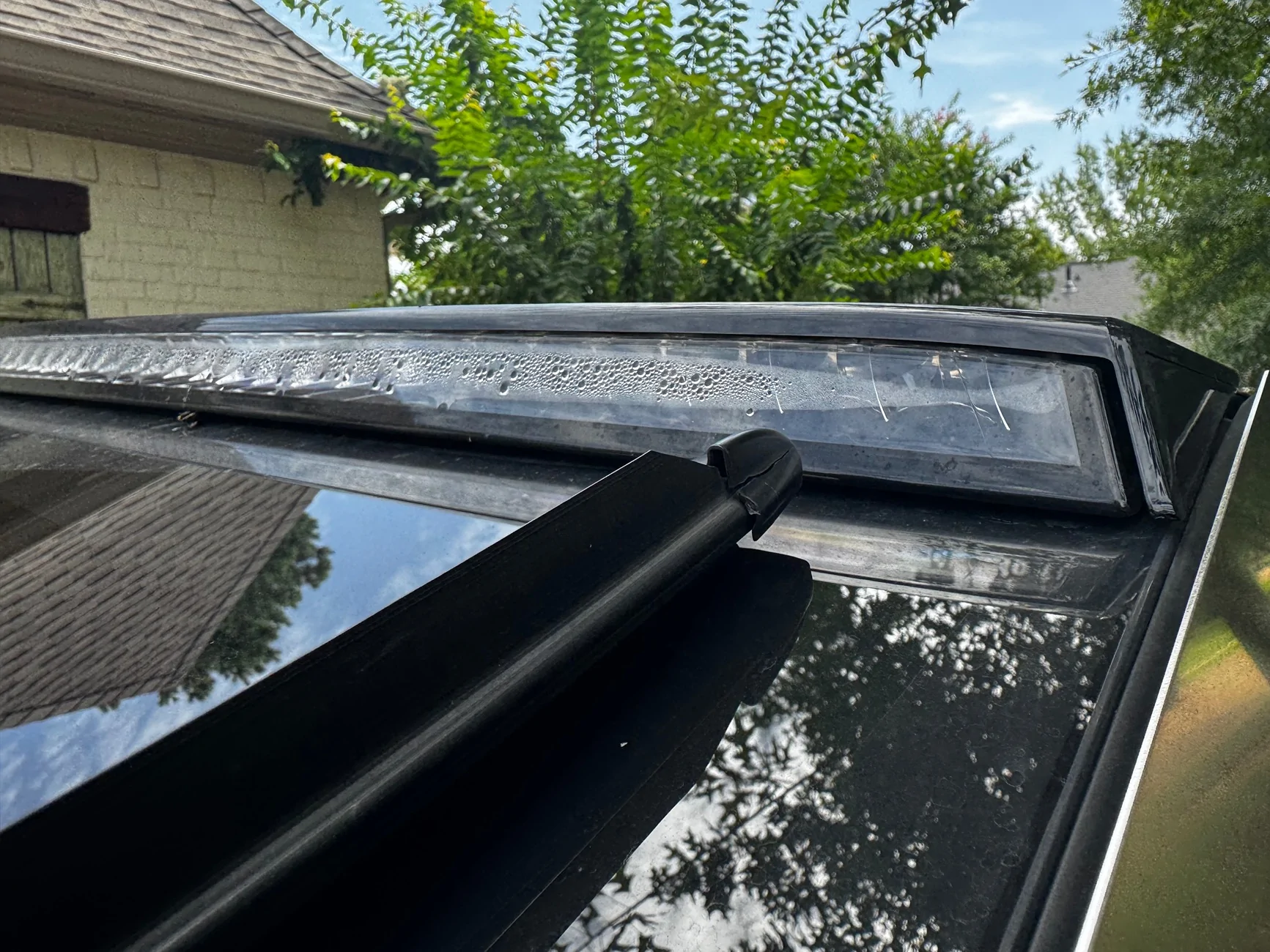

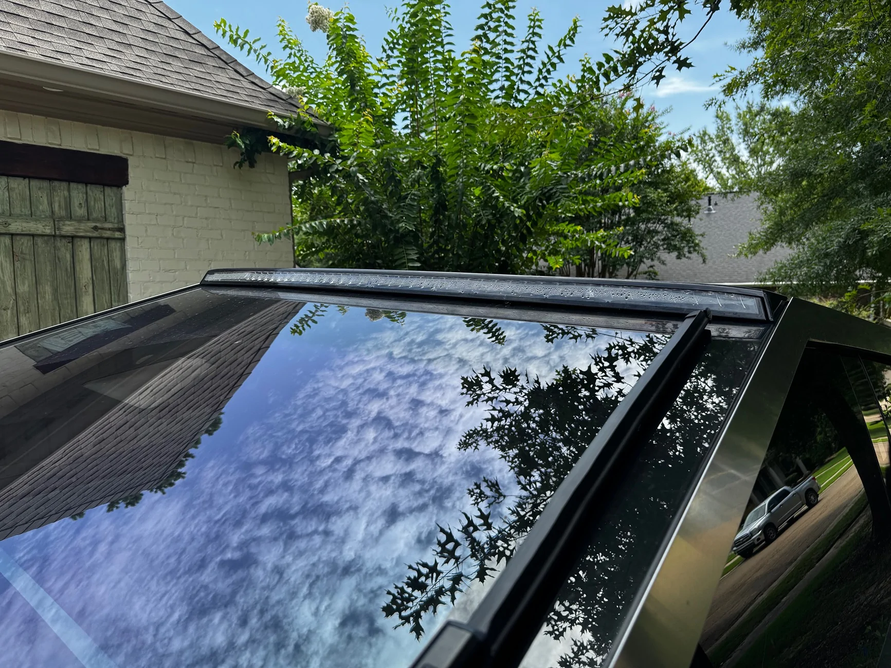

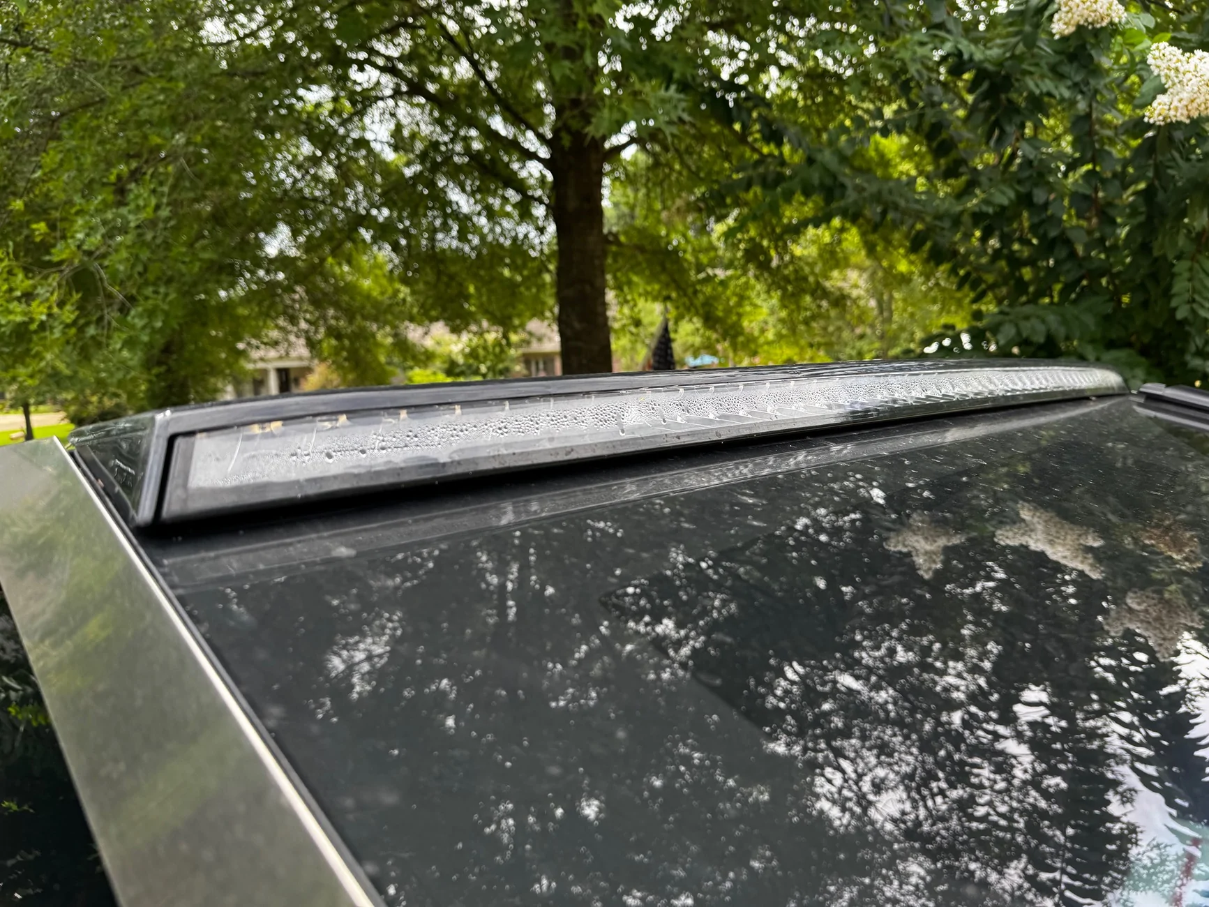

Every time it rains my light bar fills up with condensation. Has anyone else experienced this issue? Usually it goes away however we’ve had a ton of rain in the south east and ever since the condensation will not evaporate. I’m going to make a service request today. I really hope that they replace it with out a fight. I also hope they replace it with the new version that has a bracket to secure it versus just gluing it.

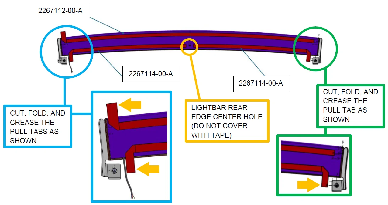

its possible the drain/breather hole under the light bar was covered or was covered when installed. The drain/breather hole is is under the light bar in the middle towards the back side.

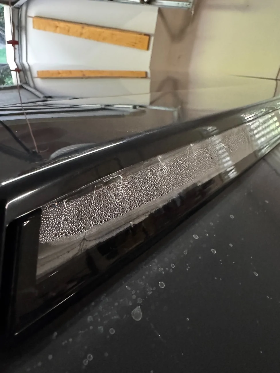

Exact same issue, added it to our PCS appointment.
