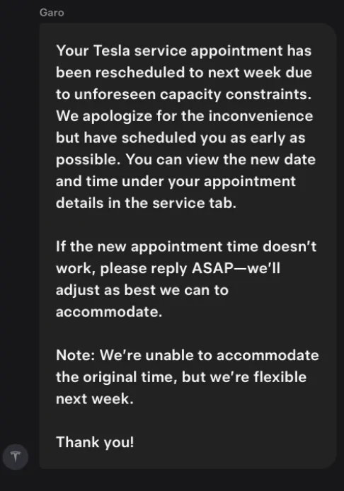

Update for anyone still lurking this thread:
Was going to get it reattached on 4/11 (along with tire rotation, camera cleaning, etc) but they just randomly rescheduled it? It's on the 15th now, lightbar reattachment is free.
Tesla Cybertruck Light Bar Fell Off, fixes? 1744310872032-84
Currently have a strip of packing tape on each side going from the top of the lightbar to the inside of the car + another strip in the middle. It's been holding fine and lasted through multiple trips on the highway.

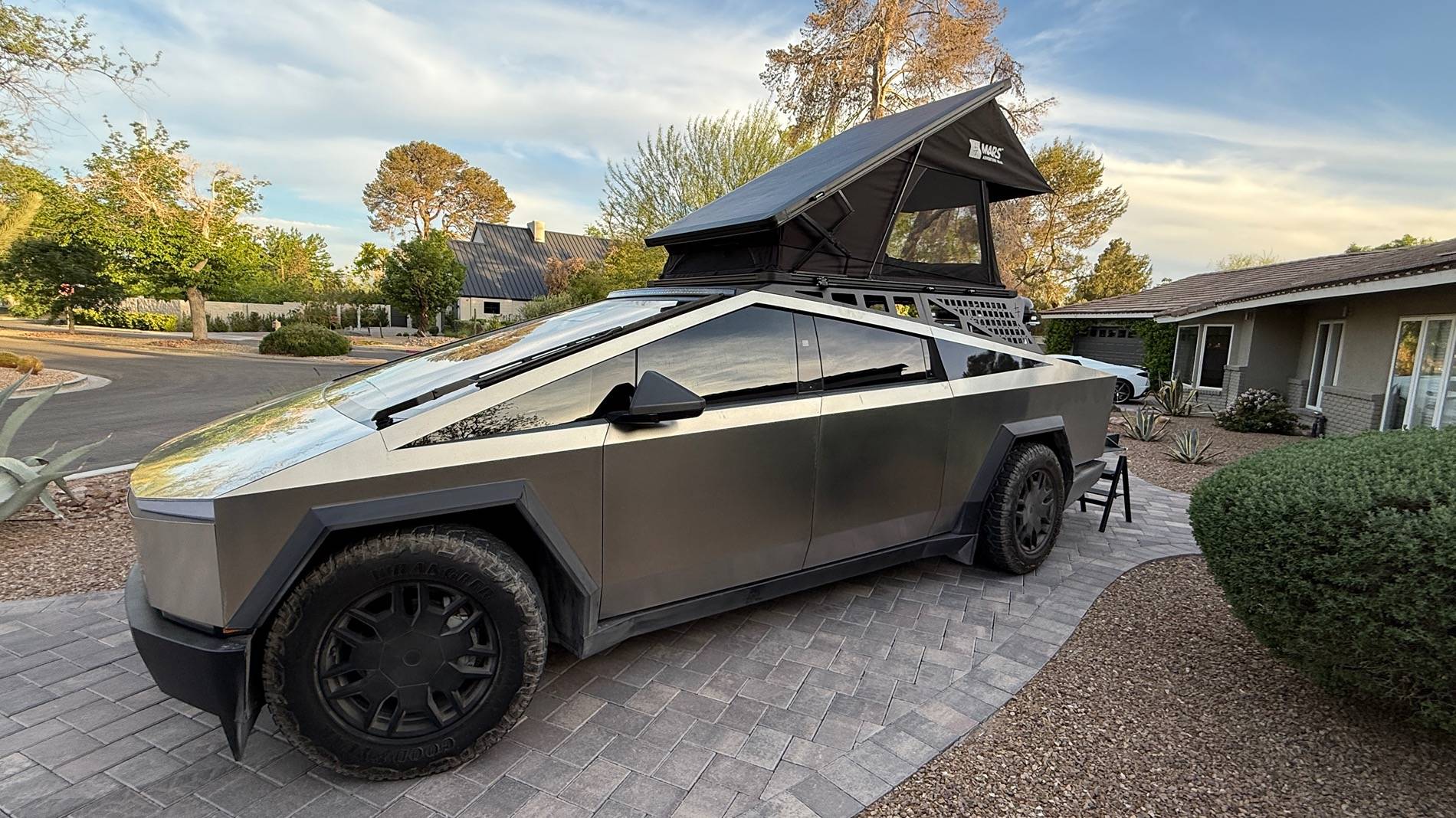

Well sir, you turned out to be exactly right!!! Look what showed up today I’ll have a lot to say over the weekend barely got it on and home but I’m about to be one happy camper!!!!

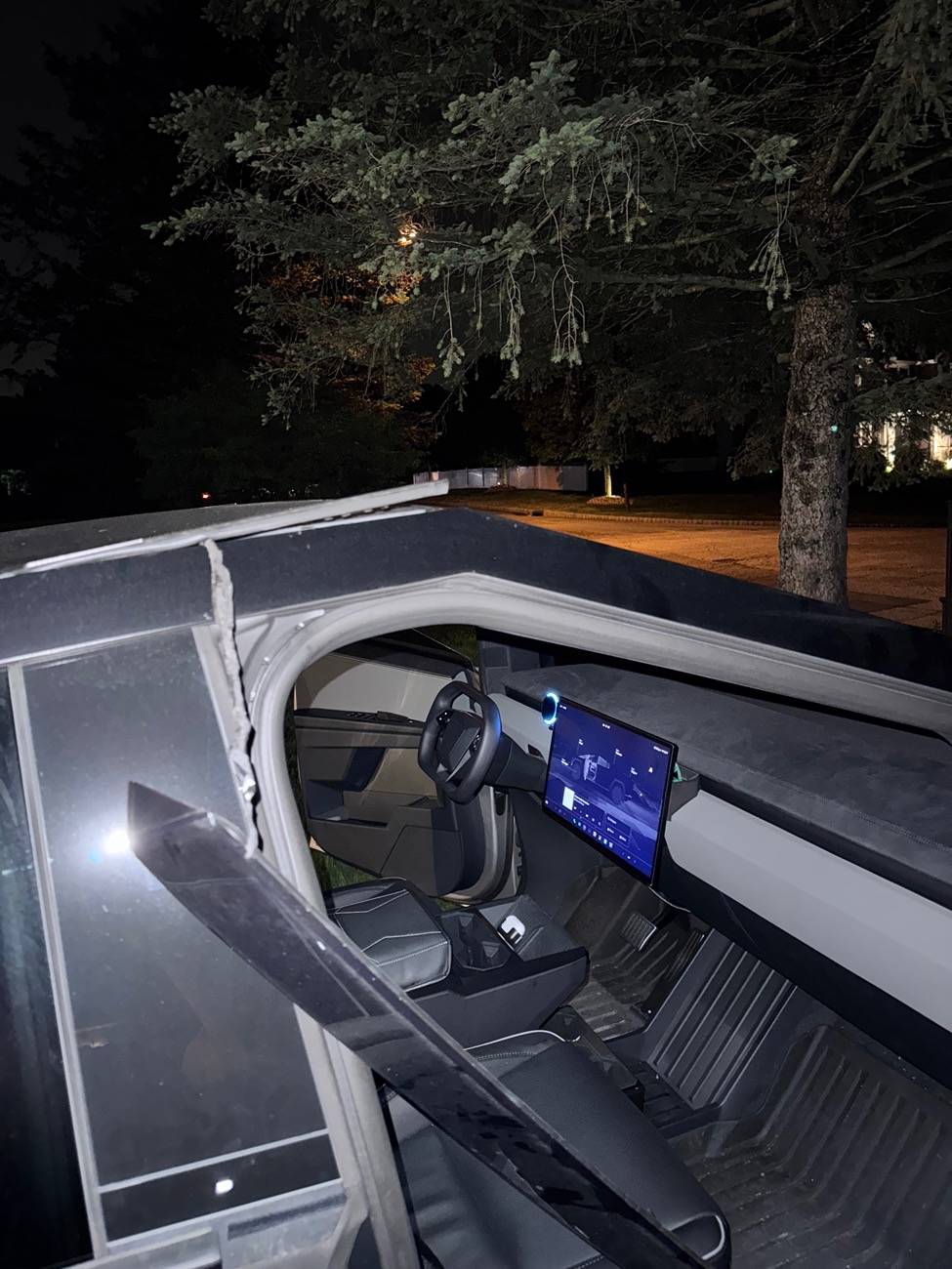

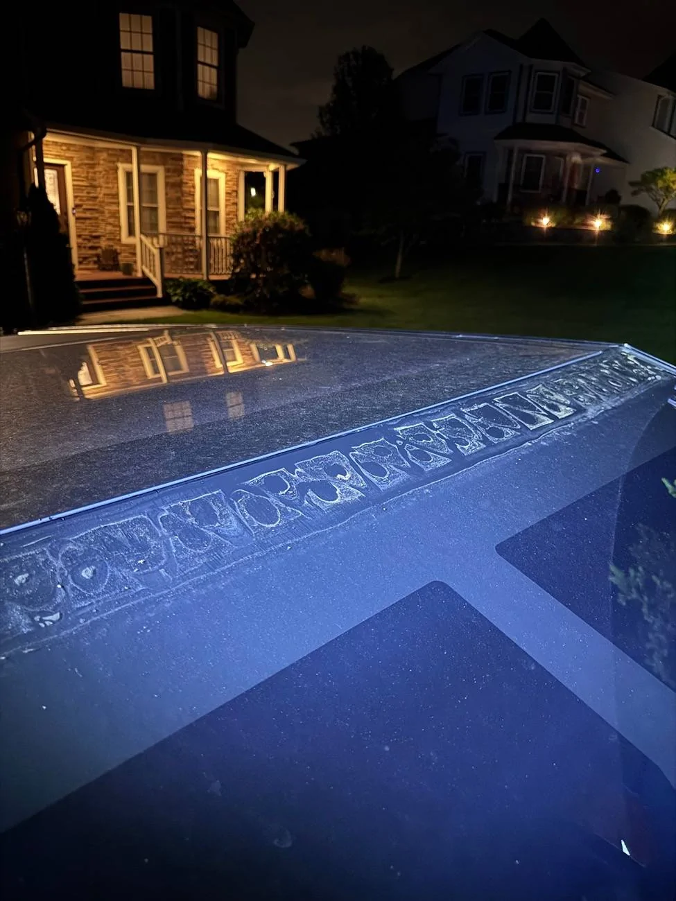

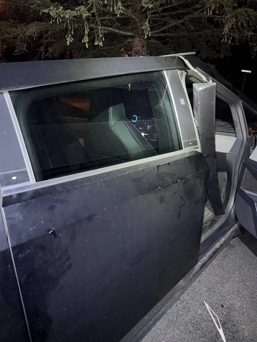

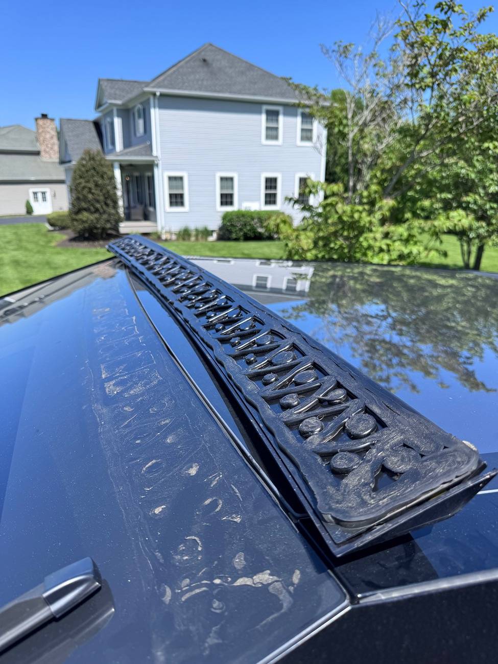

I was cautiously confident that this would never happen to me but lo and behold my light bar came off while driving last night. I was driving about 40 mph but was lucky to be around the corner from my house so was able to get home quickly. Unfortunately my truck is wrapped and when the bar came off and was dangling it gouged my wrapped in several places. Not sure if I will get any pushback to have them pay for the damages there. We shall see. All of the adhesive remains on the light bar with zero residual remaining on windshield.
Damn dude! What a debacle. ?
Also, that’s at least two now where it detached from the windshield and not the light bar. So, 3 to 2 by my account.
Partially Responsible
Robert
Jul 12, 2024
39
44
NJ
Accountant
Also, for the record, I have not brought the truck through a car wash once. Only hand washed a few times.

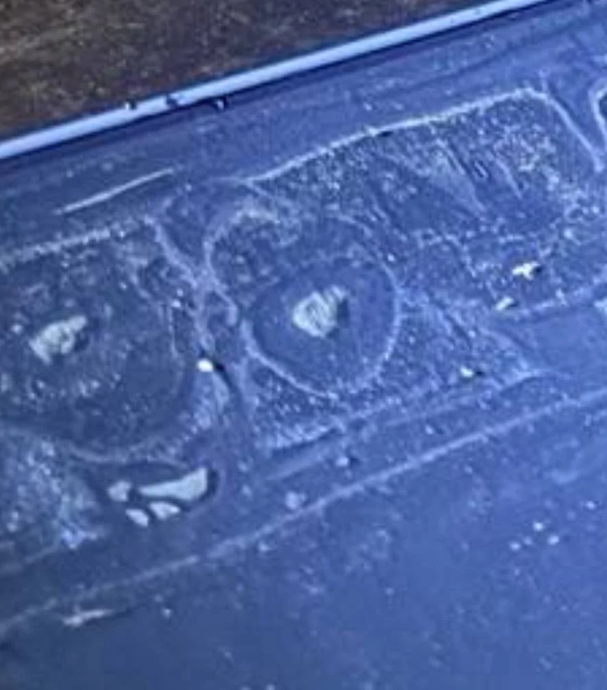

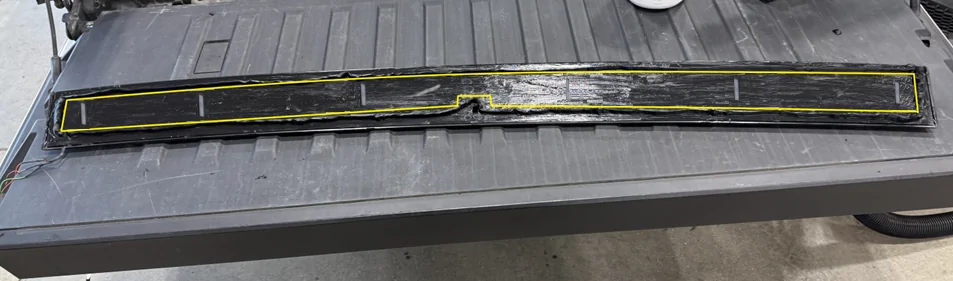

This is just dirt, not adhesive?
The specified adhesive is made for attaching windshields to cars, so lack of residue points to poor surface prep.
Yes, that is mostly dirt. Here is a better pic of backside of light so you can see where the adhesive lies.
Tesla Cybertruck Light Bar Fell Off, fixes? IMG_6030
May 27, 2024
4,592
5,573
Wow!
Someone put a lot of effort into that pattern.

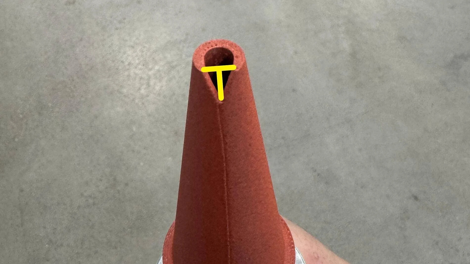

Unfortunately, that isn't the way it is supposed to be applied based on the current version of the service manual.
Nozzle cut 5mm wide 6mm high, one bead around the perimeter, and sub 2mm edge gap after placement.
